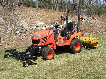

Here is my setup...front mount dethatch so I can bag the thatch and a 3pt core aerator - I use both and have noticed a huge difference...

OOPS - something strange happened with the attachment...try this one

That is one heck of a setup, Mr. C-and-a. With the 3PH aerator, you cannot leave it ground-engaged through a turn, correct? I try using the "less expensive" (Agrifab) type aerators and my clay eats them for lunch. Not to mention that I end up running the thing at 6 or 8 MPH...
I'd love to get a spike aerator mounted to a barrel that is in turn mounted to the draw-bar instead of hard to the 3PH. Many trees, you know.
Then I'd have to store the darn thing...
