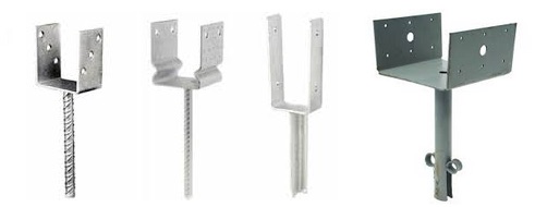

Ok, I certainly need to clarify.
The posts are attached to steel anchors, U shaped except square, not rounded. The anchors apparently have a pin going down into the concrete. I just guessed maybe 18" while sitting at the keyboard--I don't know how deep the longest one goes, but looking at similar anchors at HD, it is much less than 18". I can cut the steel with a die grinder, then the core drill will have to make a hole around the pin so we can pull it and surrounding concrete out to leave a hole. A new steel railing upright would be anchored in the hole that is left. That's the idea, anyway. Will know more when the rail guy comes and takes a look. But somehow, we need a new hole. He may be able to do the hole job.
   / Core drilling--anybody do that? #13
You have something like these to remove?
Bruce
   / Core drilling--anybody do that? #14
Weld onto the existing steel in the concrete.
Leave old steel in and drill new hole alongside it.
   / Core drilling--anybody do that? #15
Ok I get it, it’s for a deck or patio or something similar. I was thinking posts for a fence line. How thick is the concrete? If you have water nearby, a garden hose works, and a110 volt outlet, not a big deal to do it your self. My guess would be a couple of hours. You could also probably get by with a 2 or 3 inch bit.
