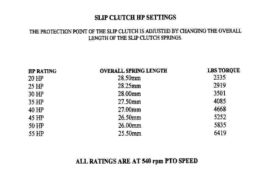

   / Correct PTO RPM to Bush Hog #36
have_blue said:
RPM has nothing to do with the torque at which your clutch will slip.
Yes. It does. There's a mathematical relationship between horsepower and torque; [SIZE=-1]HP=TORQUE * RPM / 5252. Note that[/SIZE] one of the variables is RPM. Using that formula, you can arrive at approximately how much torque is being applied on the tractor side of the slipclutch. The rotary cutter applies torque on the opposite side of the slipclutch.
See attached chart. It contains settings for one of the most common slip clutch shafts around, the Eurocardan 60hp model; 8 adjustable springs pressing a pair of friction discs on either side of a smooth steel friction plate. The far right column lists how much torque it takes to overcome the spring tension for any given setting. When torque from the tractor side PLUS torque from the mower side EXCEED that value, a properly adjusted Eurocardan 60hp slipclutch - slips.
have_blue said:
If your slip clutch is set correctly, it will slip as it is supposed to at any reasonable RPM.
No. It won't. When you change the PTO output RPMs, the amount of torque you're applying to the tractor side of the slip clutch changes. Yet the spring tension doesn't change, hence the amount of torque to slip the clutch doesn't change. So by running the tractor at less than recommended PTO revs upsets the torque split at the slipclutch. Less torque from the tractor side means it takes MORE torque from the mower side to slip the clutch. Damage may ensue.
On the matter of the JD slip clutch; the manner of setting may be different, but the principle is the same. I believe the JD design works in a very narrow horsepower window, whereas the Eurocardan design is engineered to fit a multitude of PTO outputs.
//greg//

   / Correct PTO RPM to Bush Hog #38
But the initial concern was that at low pto rpms the shock load would not be sufficient to cause the slip clutch to 'slip'. If that is true then the shock load should be insufficient to damage the unit or the tractor unless there is a major mismatch between the tractor the slip clutch or the cutter. This might be a problem for someone adding a slip clutch, but again, on my JD there is no recommended adjustment other than a 4mm space. This suggests to me that within the recommended use and within the recommended hp rating, it should function just fine at any rpm up to but not beyond the recommended pto rpm of 540.
   / Correct PTO RPM to Bush Hog #39
Exactly. Which is why I specifically pointed out that the OP has a 120hp mower tranny behind a 45hp PTO
//greg//
   / Correct PTO RPM to Bush Hog #40
//greg//
I don't see how that matters unless that tranny is attached to a rotating mass (blades, spindle, stump jumper) that is too large for the 45 hp tractor to handle. (And there is no indication that this is the case). I wouldn't think the gear box, regardless of how high it is rated, adds anything to a low velocity shock load. I'm not trying to argue, just trying to get this all sorted out in my head.
