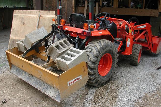

I couldn't help but to think about this thread when I went back out after taking a TBN break this afternoon...
"Am I usin' it or abusin' it? " was the question that popped into my head...
Hey! I admit it. Looks like I may be abusing it! But the extra weight makes it work a lot better... /forums/images/graemlins/blush.gif
Guess it's a good thing I don't own Bob's tractor... /forums/images/graemlins/grin.gif /forums/images/graemlins/grin.gif
