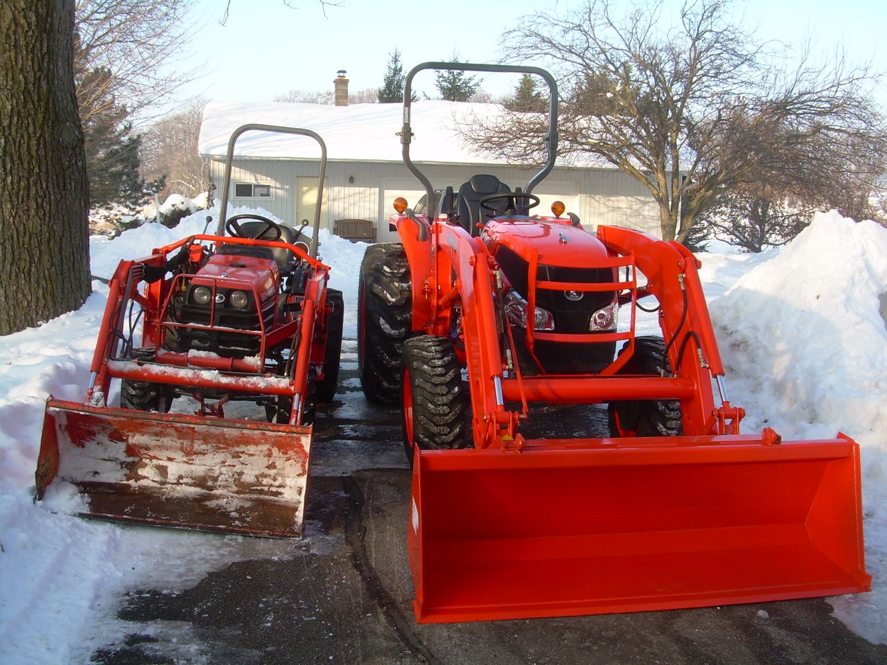

OK here's what started the thread. While waiting arrival of my new machine it started to snow, the dealer dropped off a loaner to get me by. I briefly considered buying it and trading up in the spring, but was able to dig deep and find just enough patience to wait. It's a B7500 and tons of fun to knock around - guessing that's why bucket is beat up.
Not a good picture but left of the bucket (right side of machine) shows some of the ugly.

   / Cosmetic Condition and Resale Value #26
davitk, those are probably just snow plow bumps. I would not let that be the determining factor for me
   / Cosmetic Condition and Resale Value #27
I take back what I said.
That tractor is not beat up and the bucket is not messed up. Not so much as to notice, anyway. If the top was bent down 3-6" and the sides were bend in 1-3", then it would have been abused.
jb
Gee, that could be a photo of mine and my neighbor's tractors. I have a little 21-hp B7510HST with LA302 FEL and he has a brand new 46-hp L4630 gear tractor with a 6-ft wide FEL bucket.
