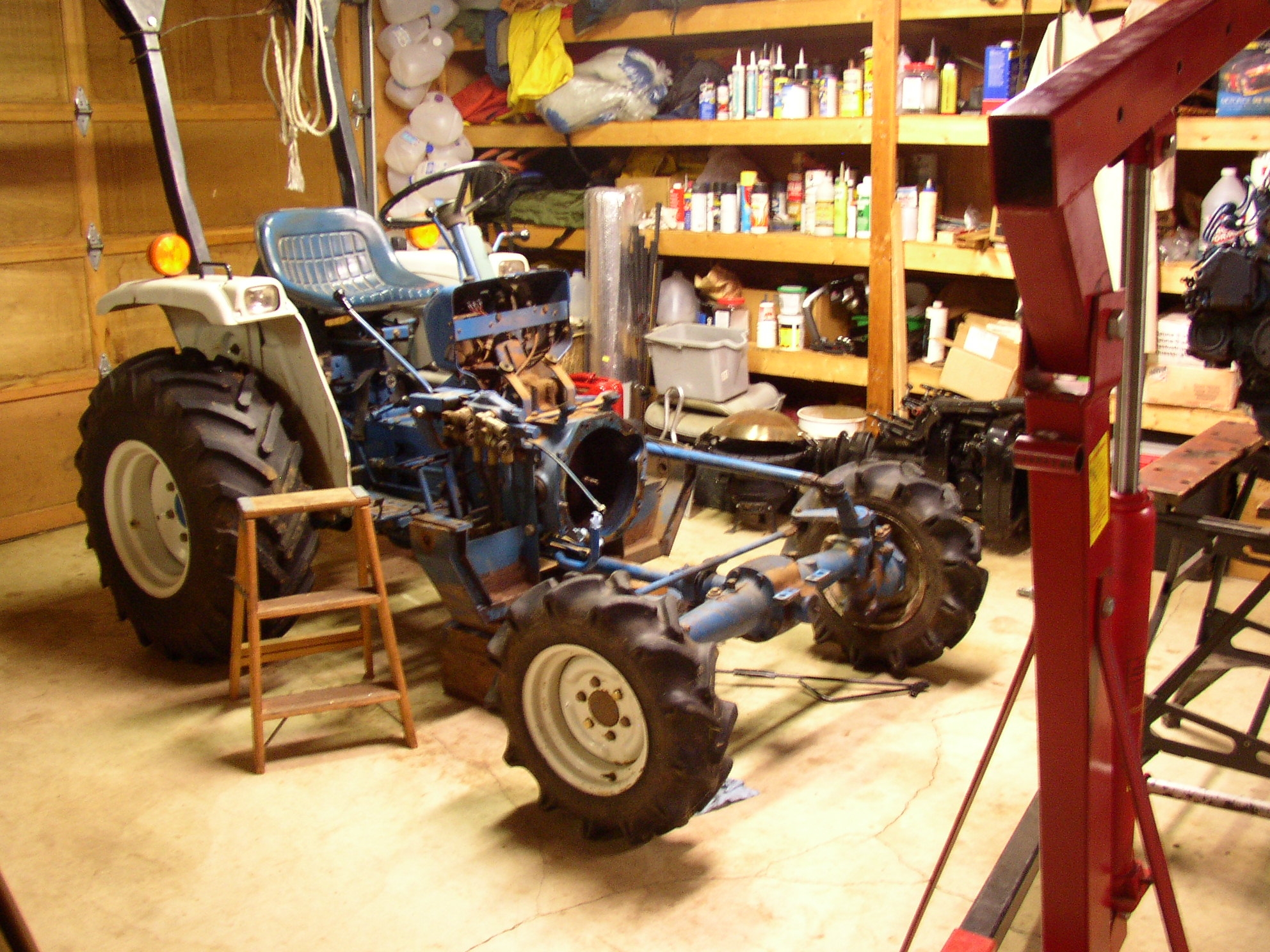

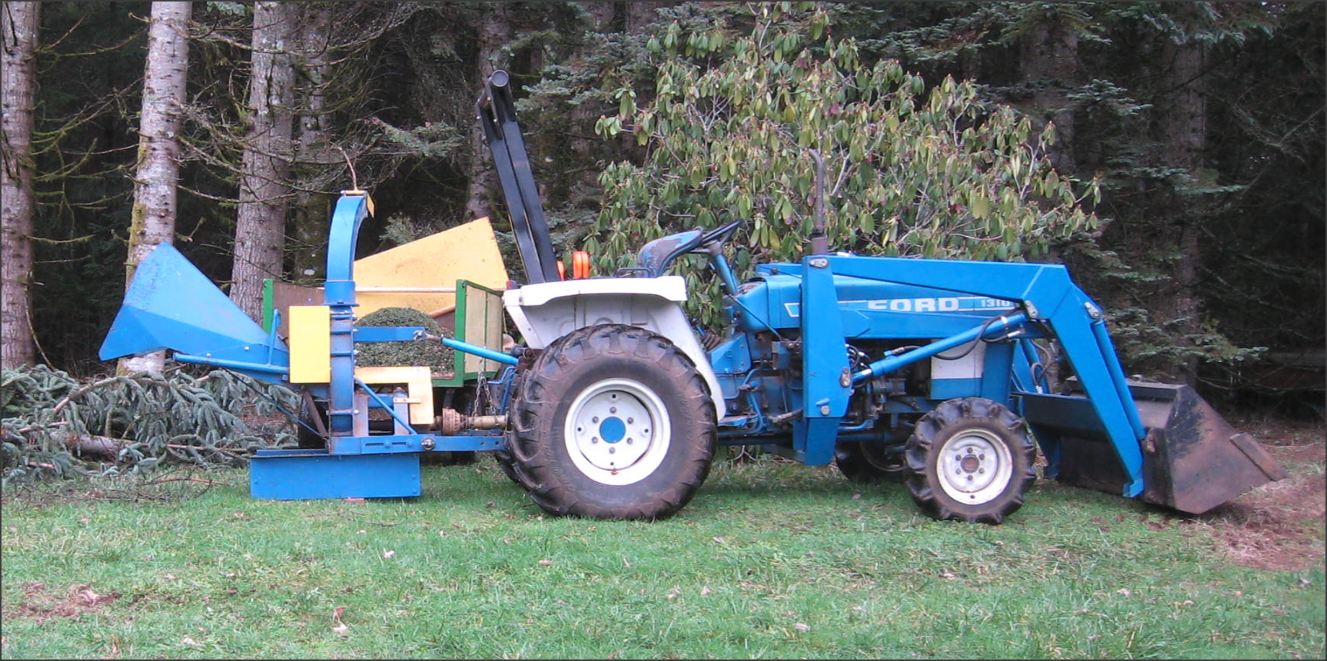

I split my Ford 1310 during winter of 2006 and would do it again if needed.
It is obviously smaller and perhaps simpler tractor with manual 12-speed transmission, but the same idea.
Factory shop manual, engine hoist, couple of hydraulic jacks, hand tools and some mechanical repair skills are needed.
