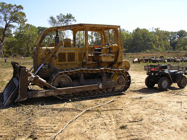

The hourly rate sounds about right, even for down here. I would also consider a D-6 a large dozer. One that might have problems with wet areas because of the weight.
It's all in the operator. If he knows what he's doing, it'll get done faster and will look better. If he's a hack, well you know the rest.
Are you going to puck up the stumps, etc? Some loggers cut them flush where you can still mow over them. The trees you describe would be easy to push over and/or cut. But if you push them out you are going to be left with holes that will need to be filled.
Whoever you pick I bet even the untrained eye can see what sort of driver he is in less than an hour.
Good Luck,
Rob
Pic of a friends D-6.
