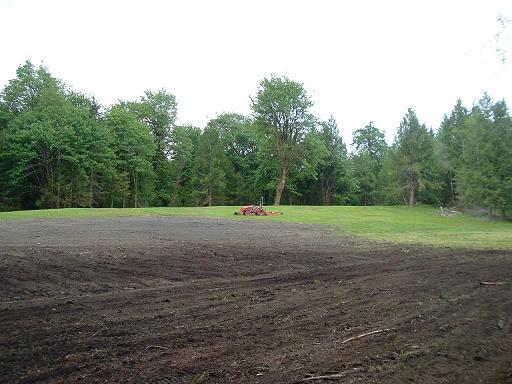

I bought a small bulldozer to work on clearing my 15 acres. I was able to push in pioneer roads and do some clearing but I dumped the dozer for a tractor after I hired a logger to cut trees and clear a small area. The logger had an excavator which made all the time I spent clearing with the dozer seem foolish.
I attached a picture of the area that was once dense NW forest. You couldn't walk through. The excavator left me a surface free of slash but so rough that I couldn't drive through it. The boxscraper on my tractor was used as a makeshift dozer to get it all graded smooth.
