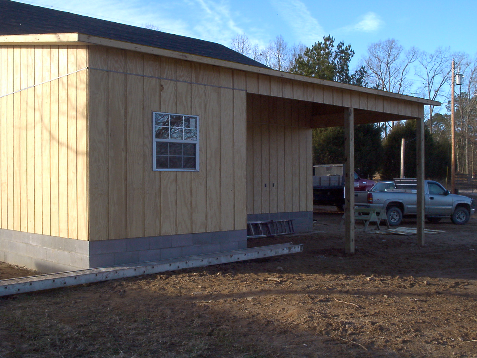

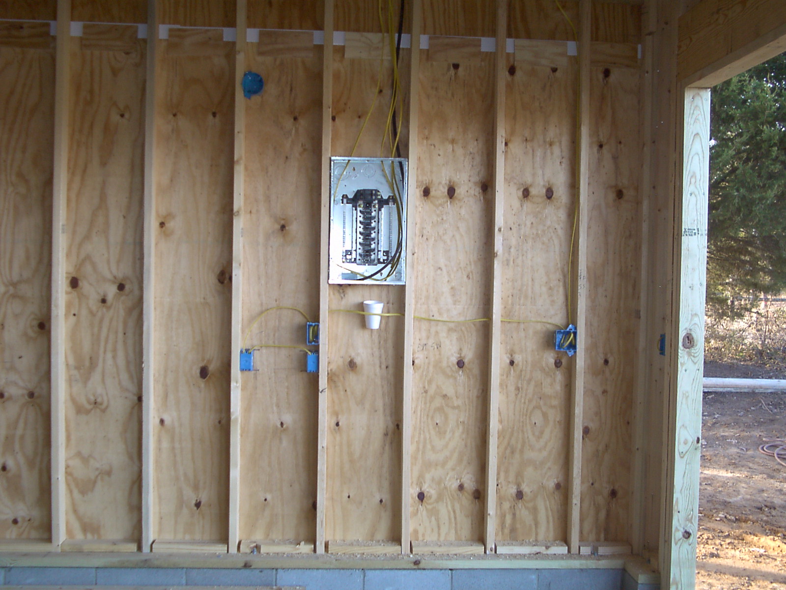

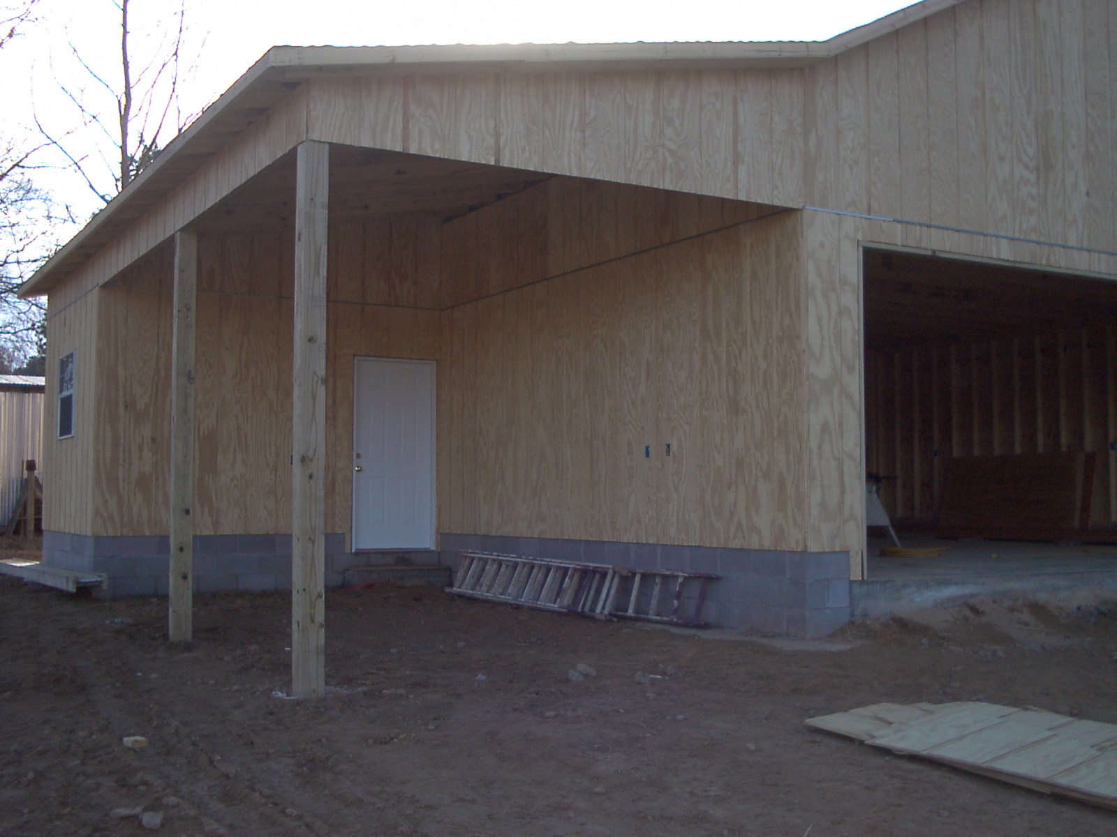

   / Cost of construction. #4
Some photos of it while under construction. I dont have any of completed building after painting and garage door installation. The walls are 9 foot studs with one course of 8x16 CMU block to raise the walls up so I can powerwash the floors without wetting the walls. The complete interior has R 19 insulation and sealed with 3/8" plywood.. The attic has a 30 foot by 8 foor floored storage area also with lighting.

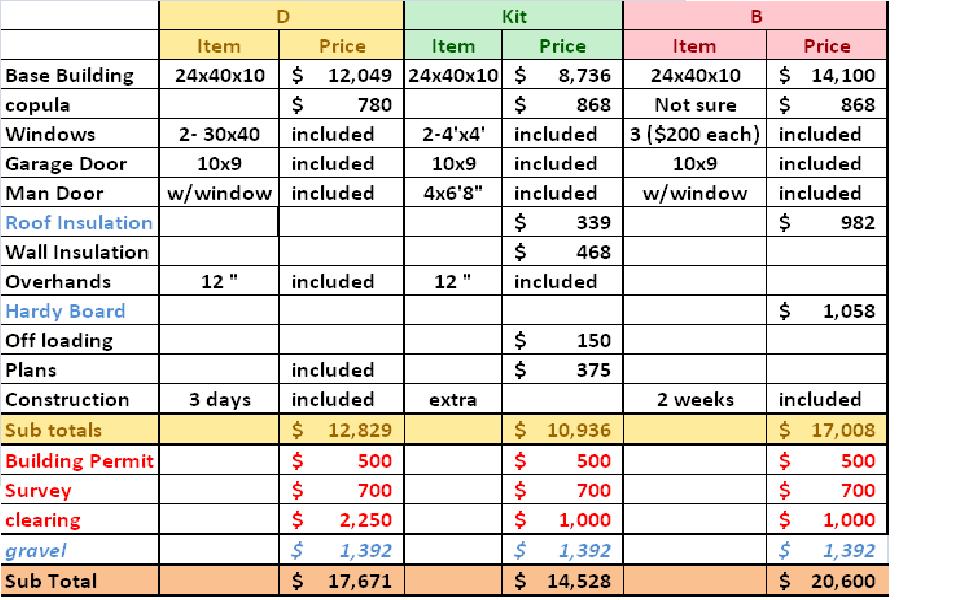

I've been price for a while now and have permission from she who must be obeyed, to go a head with the job and I知 planning on building in March. The size is 24 by 40 by 10 with overhangs all the way around, a few windows and garage type door. The prices are below. I will probably do the clearing and the build up of the ground a 2-k is way too much and I can spread gravel so this will reduce the cost.
