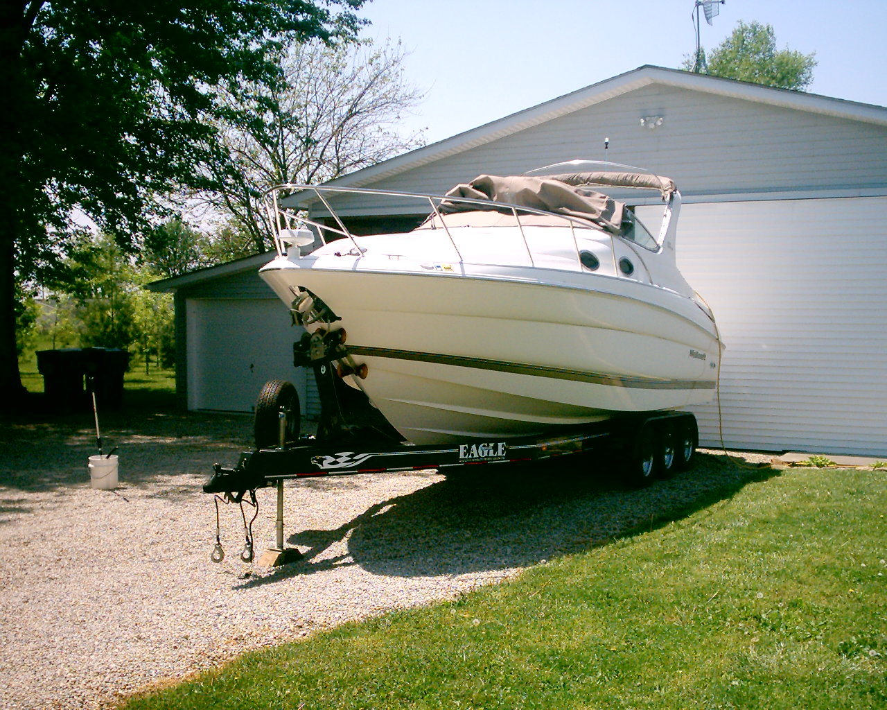

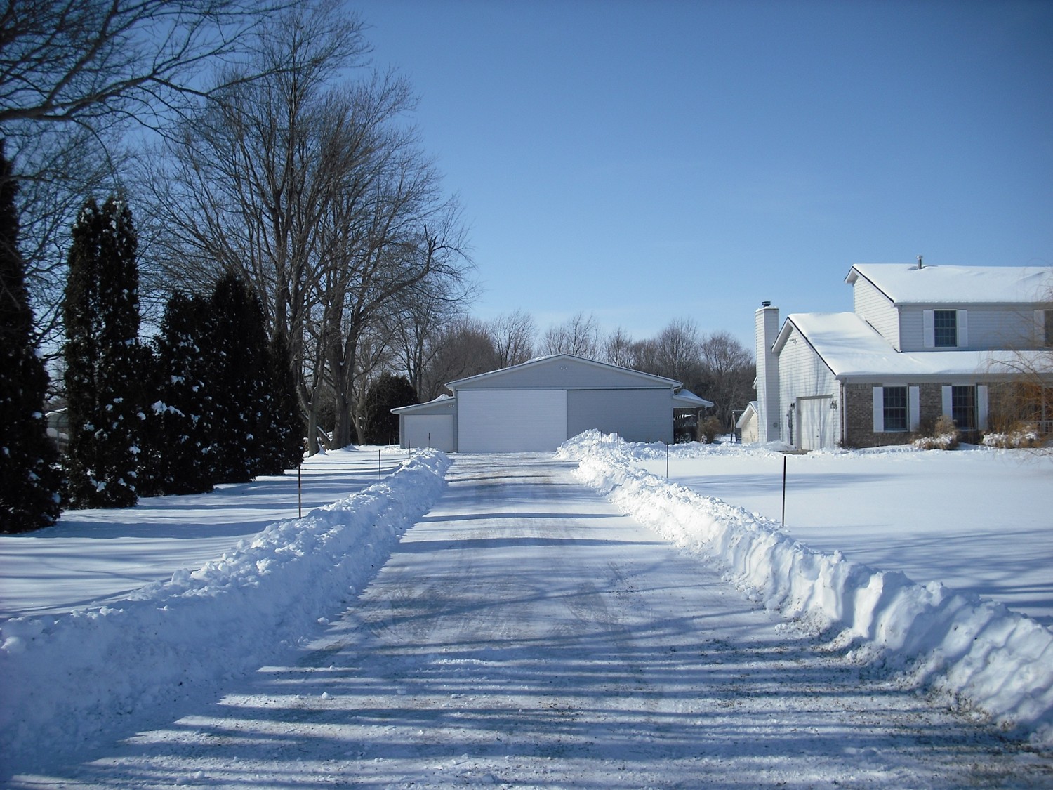

Do not waste your money on a 12' building. If you are going to do it do it right and get a 14' building with a 14' tall door. Ask me how I know???? I built a 12' tall building saying I will never need a 14' door. I kick myself every day. Boat sits in the drive in the summer and I pay to store it every winter.
I also would now like a 2 post lift but can not really do so with trying to lift large vehicles like my F-350 or SUV's.
I did do one thing right and do a single piece 12 tall by 20 wide slider along with the standard garage door you see in the picture alone with a identical one on the back side.
Chris

Maybe your boat is too big? :) It's the devil's choice on how high to make a building, that's for sure. Another thing I always think of is it is silly to build a shed that isn't at least big enough to park a pickup truck or tractor in. Like, if you could really use a 16' long shed, add another 8'.
Dave.
