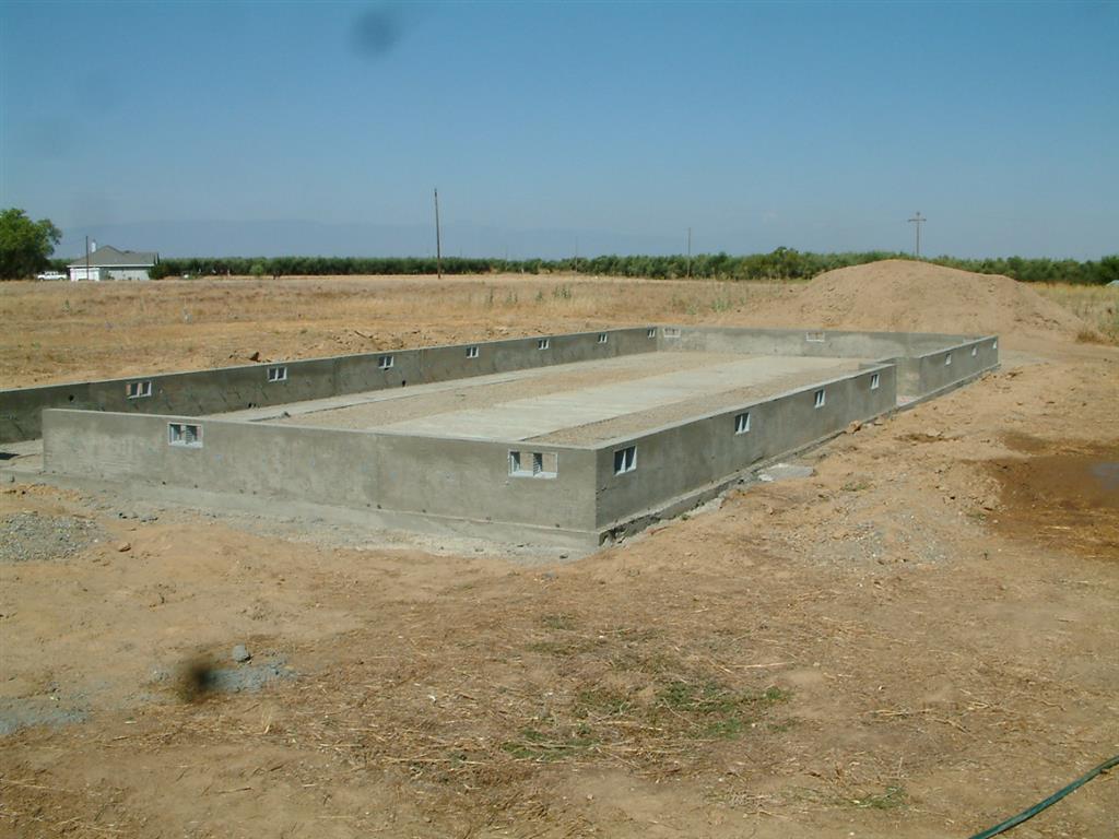

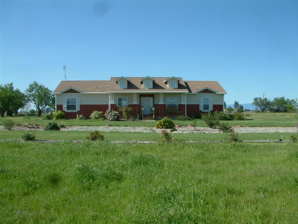

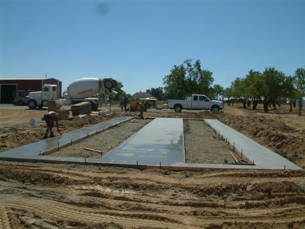

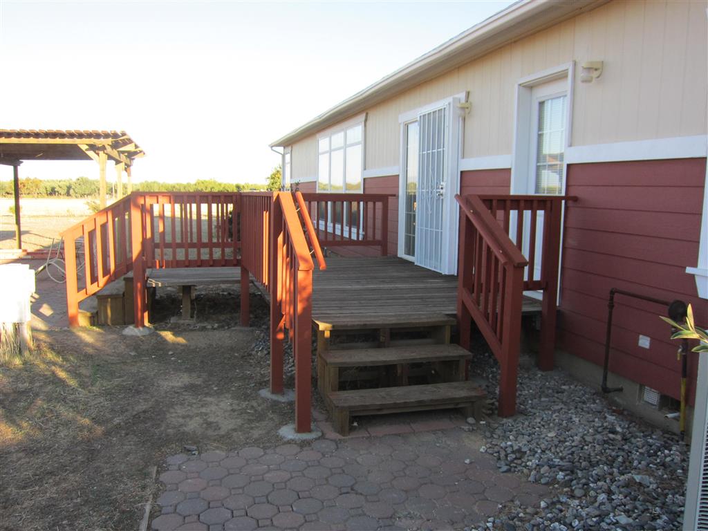

My 1800 sq ft house cost about $70/sq ft in 2005. Double wide manufactured house on a permanent foundation with 24" crawl space. 3BR, 2 full baths, LR, DR, country kitchen, office, laundry room, big front porch.
DSCF0030 (Medium).JPGDSCF0118 (Medium).JPGDSCF0203 (Medium).JPGIMG_3393 (Medium).JPG
