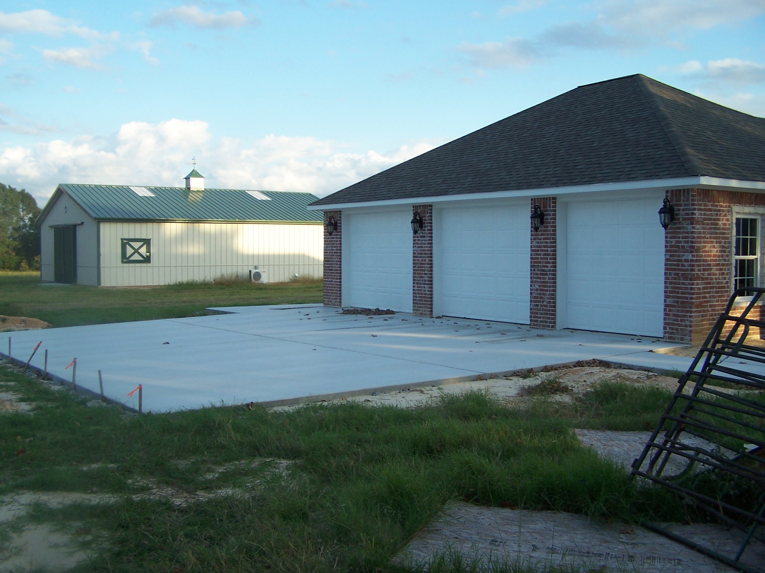

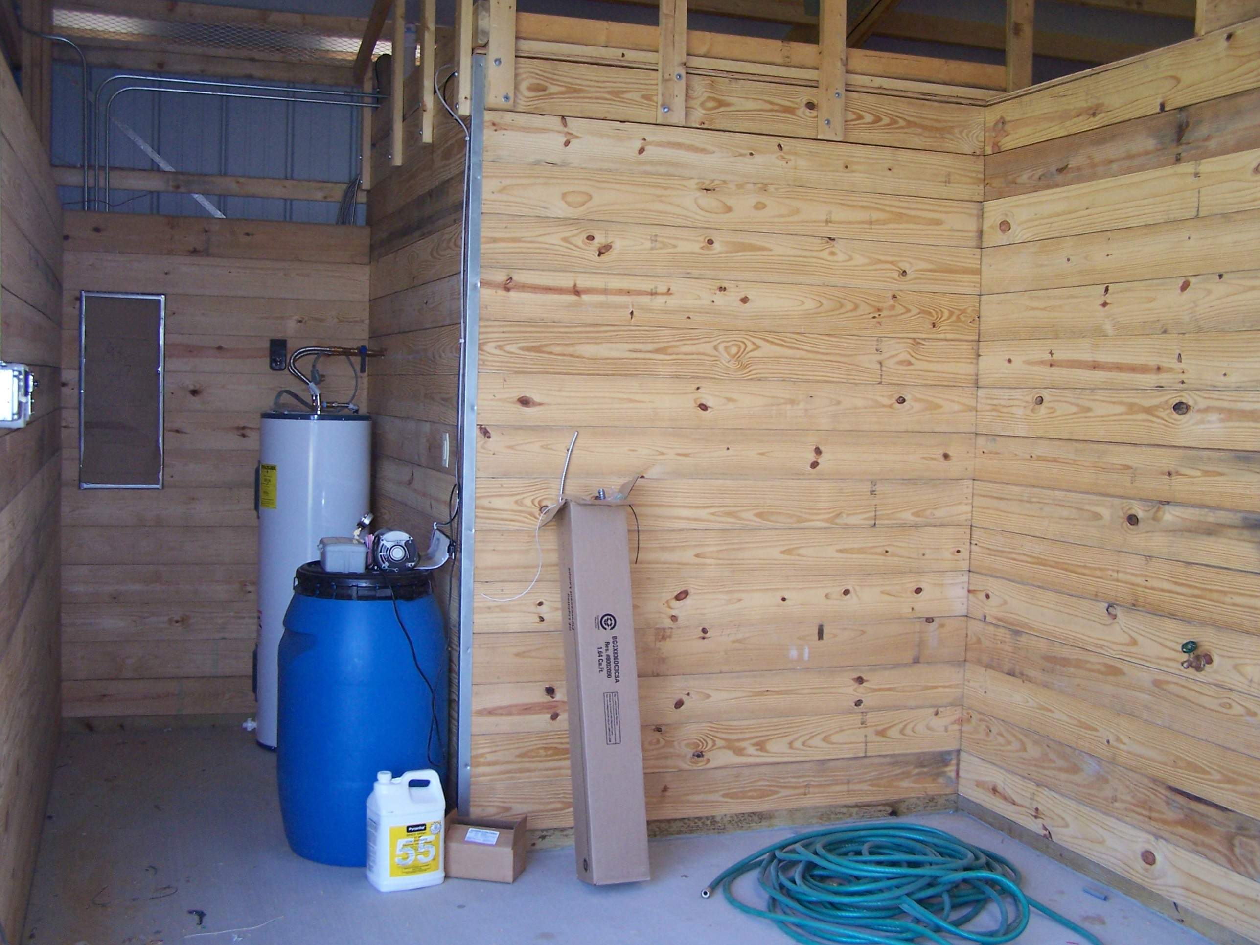

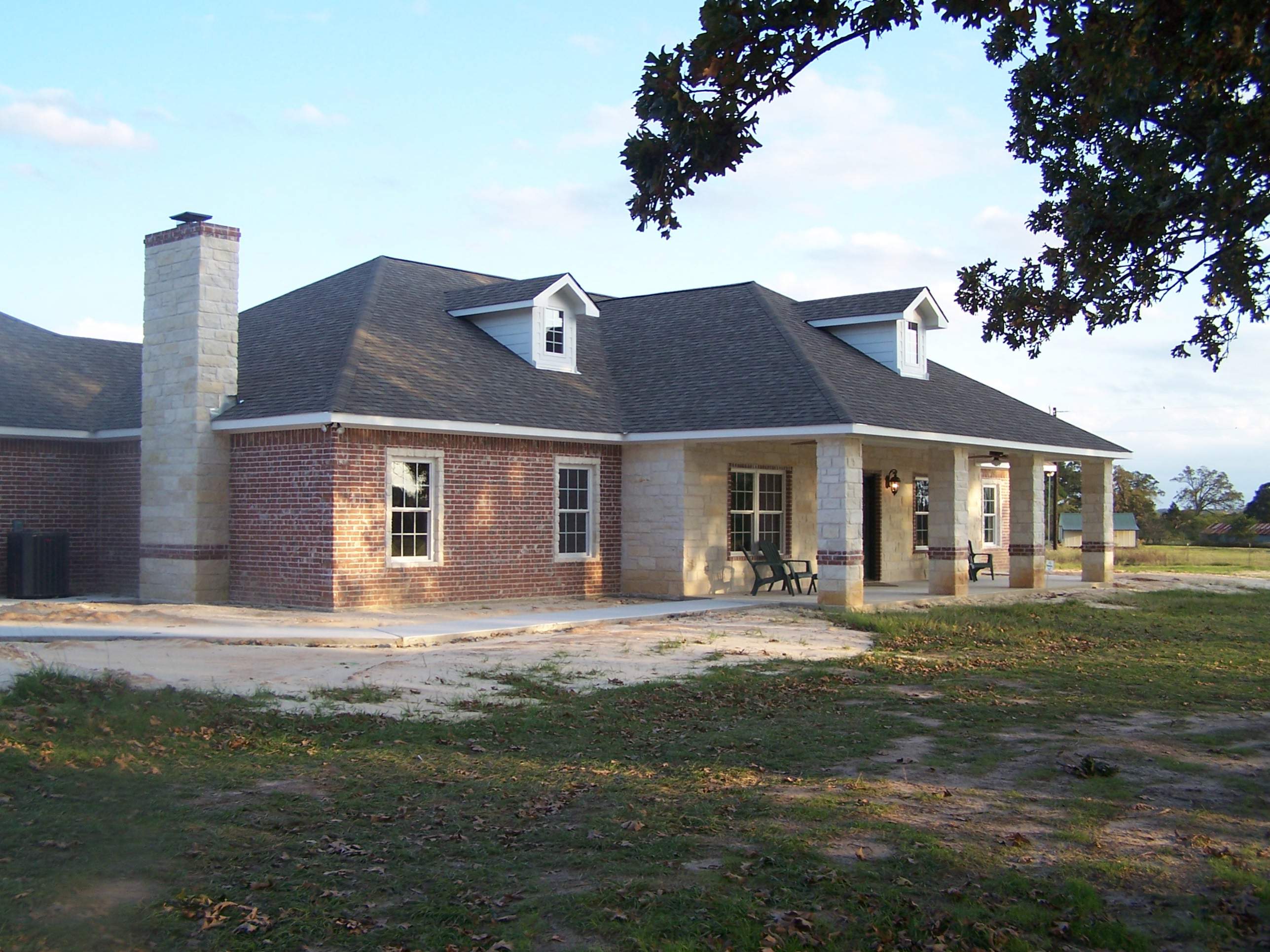

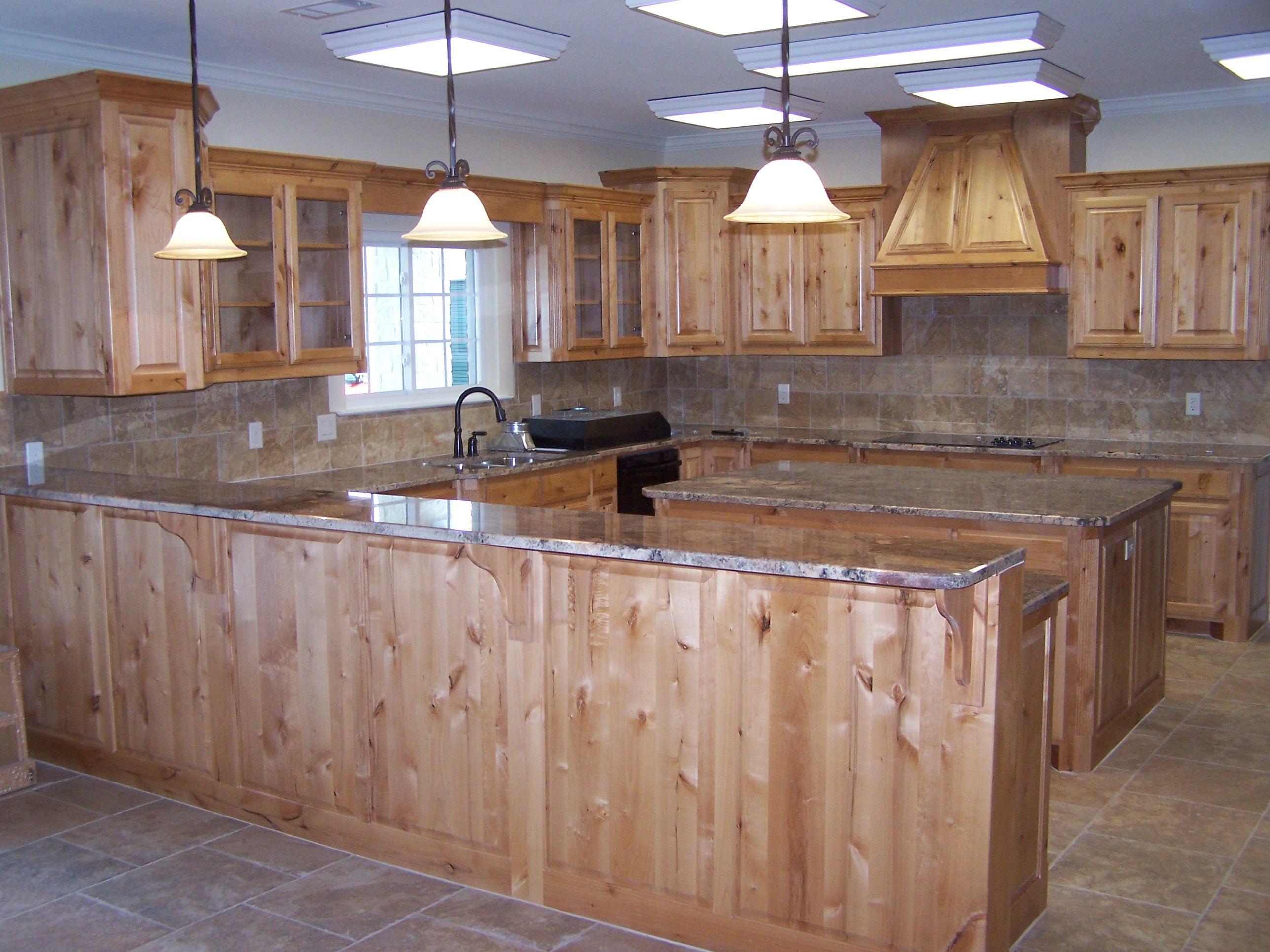

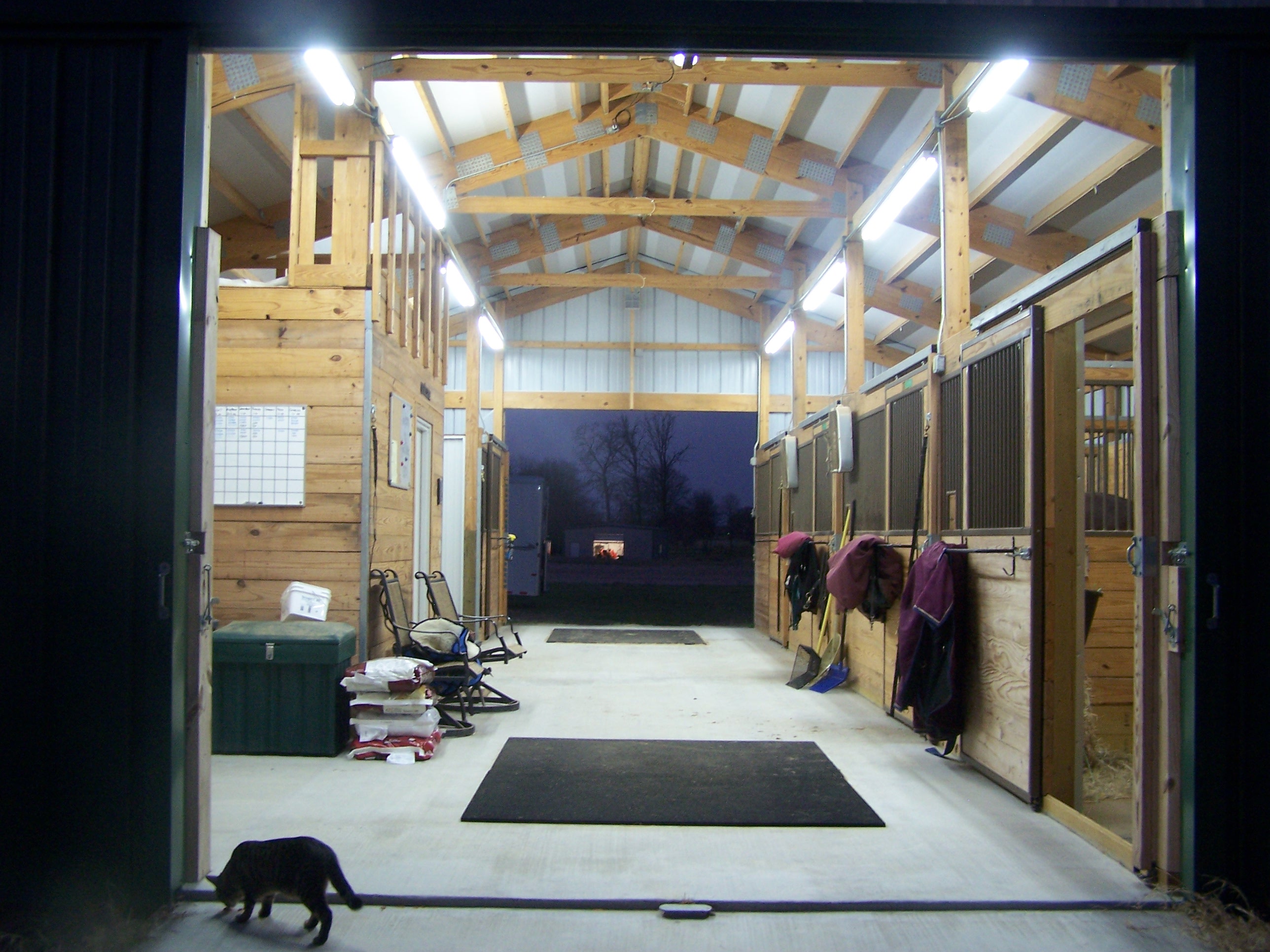

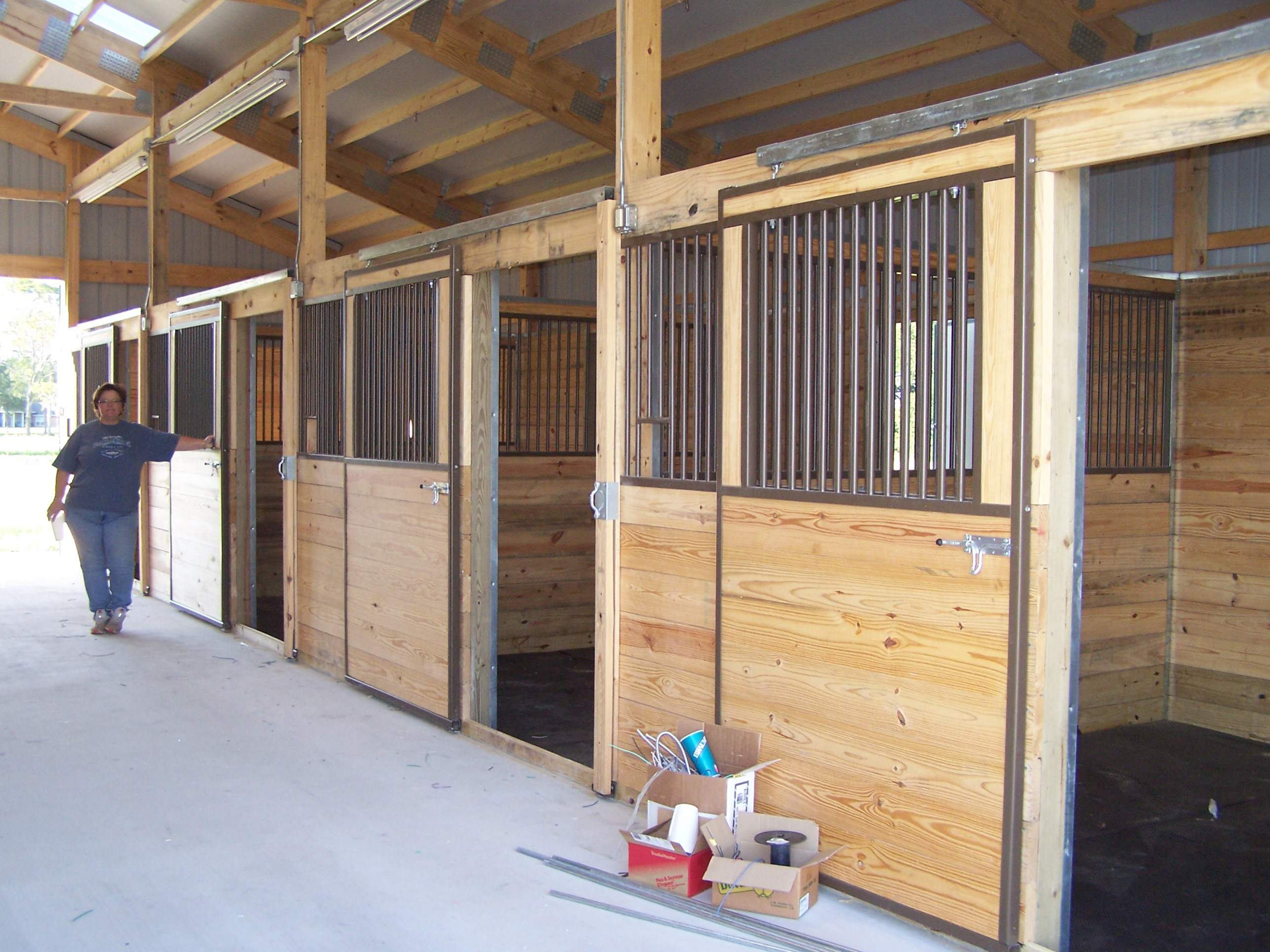

Seems high to me for the house you describe you want to build but cost varies by location. We built in 2009 so prices have gone up some. The total footprint is 5200 square feet under roof, 3200 square feet in HVAC, front porch is 10'X35', back porch is 13'X38', garage is 1140 square feet. Cost was $320,000 which was $100/square foot HVAC. Our house is hopefully the last house we will have so it's custom everything. One example is the kitchen has custom knotty alder cabinets with a clear polyurethane finish and 135 square feet of granite countertops.
Very attractive home. The kitchen is gorgeous with lots of lighting (that's a great thing). Wasn't the a/c for the barn a tad over the top? :p
   / Cost to build 3,000 square foot single story home on my land #30
Thanks. HVAC is for tack room, bathroom, and in case I have to sleep in the barn. Keeps the tack in good shape and all the plumbing is in the tack room walls to prevent freezing. Horses have windows and a fan.
