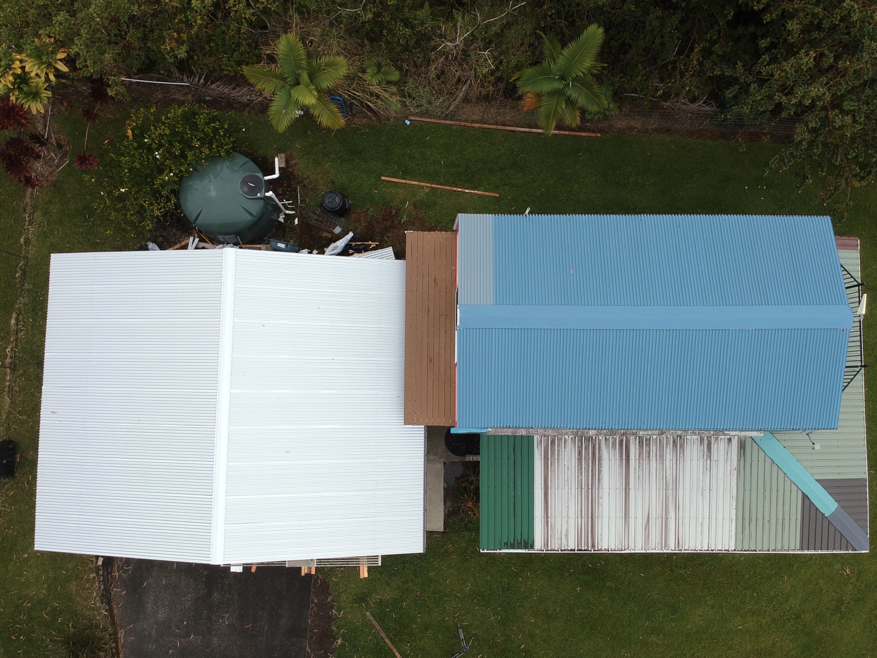

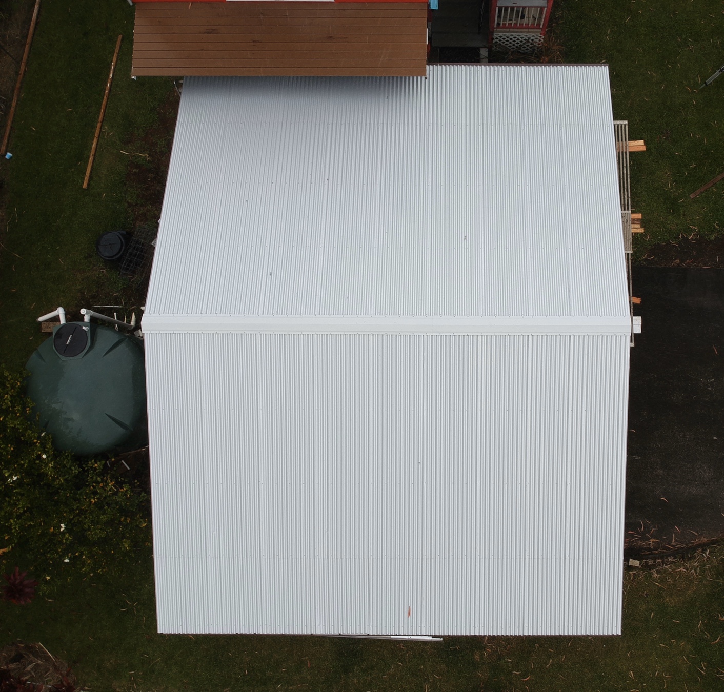

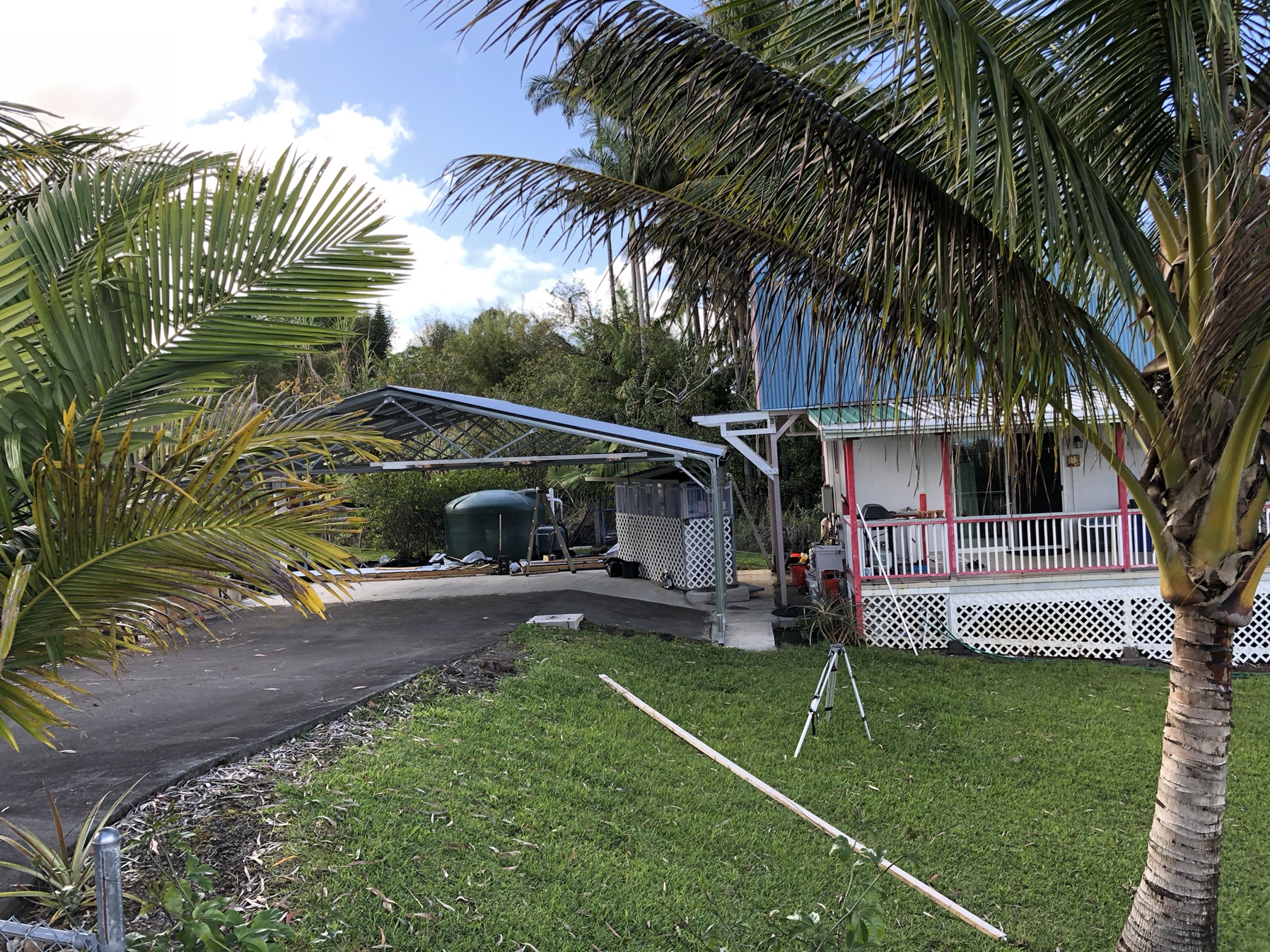

A very good day. Cottage side of roof installed, ridge cap installed, flow diverter on edge by gutter.
Not a very good pic, need a drone view
Someone asked about the Versatube kit. I’d rate it a solid 9 of 10. I would have preferred another 2 or 3 rows of purlins per side. I’ll also likely add some diagonal bracing to sides. I would have preferred 4ft vs 5ft spacing between trusses.

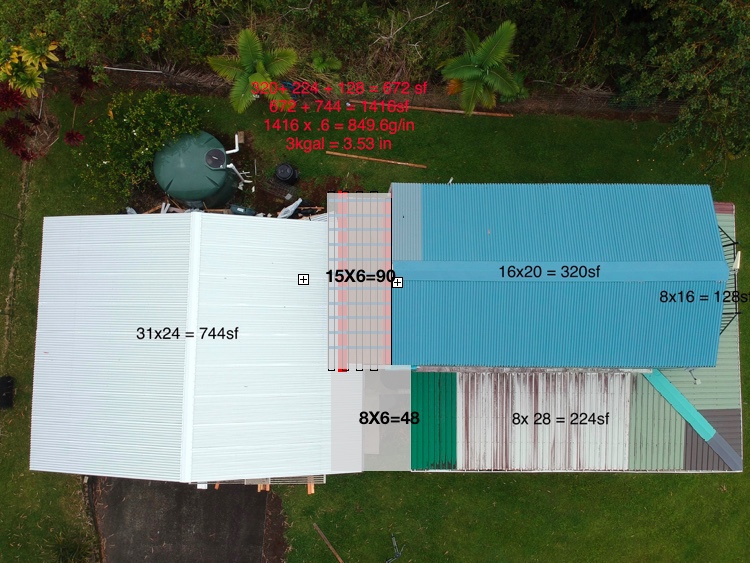

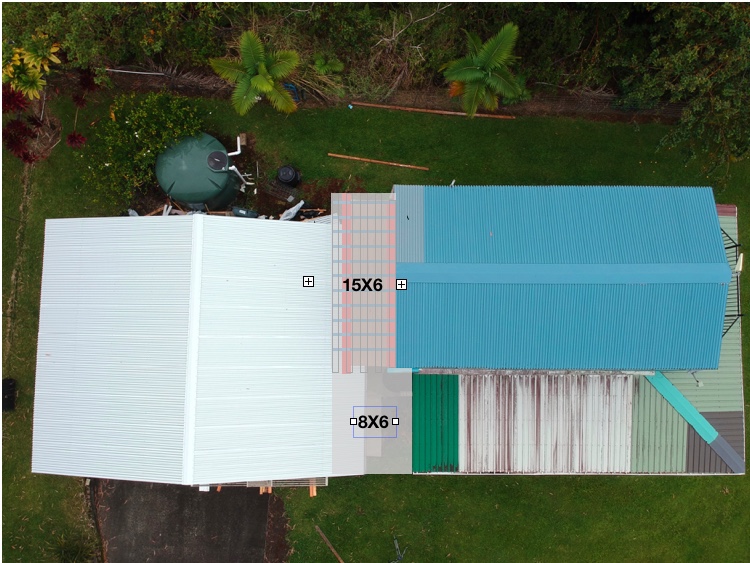

So as to what’s ahead on carport.
Some trim for sure and still a bunch more screws. Will be adding some additional bracing, but first...
Two additional areas for roofing.
Approx 15x6 over the rear deck and approx 8x6 to tie in from existing deck cover
Then I will rework the gutters and catchment plumbing. Significant capacity increase
No plans to add another tank to the current 3kgal. We average 140 inches rain/yr. that would be nearly 40 tanks/yr.

Sodamo is your math flawed? sq ft divided by .6 equals gallon, correct?
