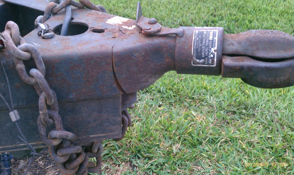

That looks more like a fracture in the lower section and then a ductile tear up top. Close-ups would help.
   / Could have been a bad situation.... Bulldog coupler torn. #12
This is on a 2009 model trailer...
I was told by a friend in the trailer business that he sees this often, and they fix it by welding some flat strap perpendicular to the break... I will be grinding out the old coupler, and welding in a new one.
That's why they sell replacements. And, it's why you have to keep an eye on things.

Both sides failed?
The passenger side failed, but there is now a distorted area on the driver's side, I would assume from it now bearing twice the load.
I tried to grind the old coupler out and keep it all intact, but after about 15 minutes with the grinder, I pulled out the torch and cut it out.

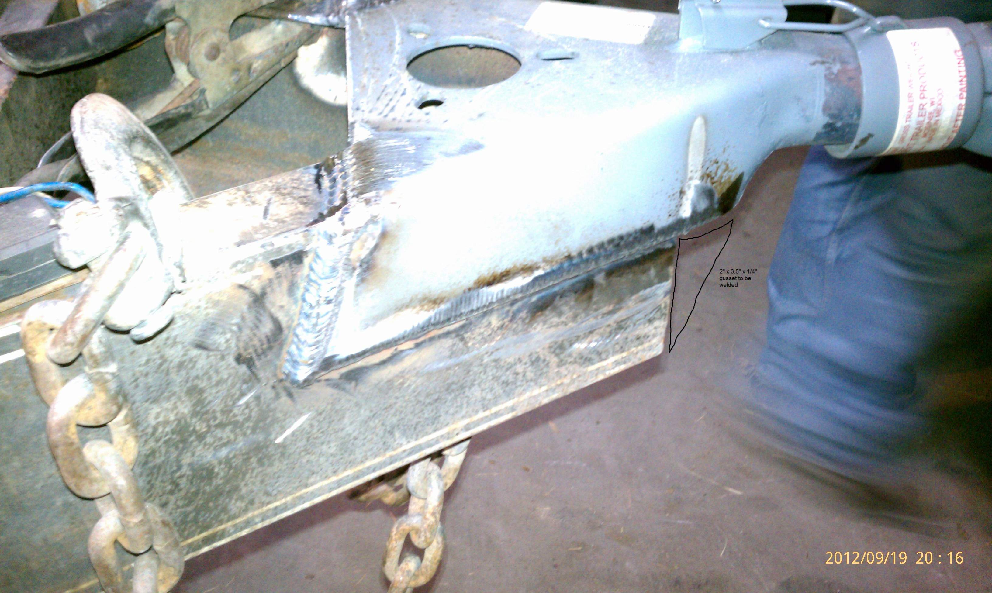

What I have learned while working on this issue is that there's a lot more flex in a 6" channel iron tongue than I ever would have imagined.
When I cut and ground the old coupler out, I used a small pry bar to move some steel. The channel would deflect vertically an inch or better, between the driver and passenger tongue channel.
To make the tongue more solid, we are welding in some steel in front of the two channels, and basically boxing in the tongue. This should take some of the twisting and binding out of the coupler, where it transitions from the hitch to the a-frame.
We are also welding in a 2" x 3.5" x 1/4" gusset in the unsupported area of the coupler, as noted in the pic.

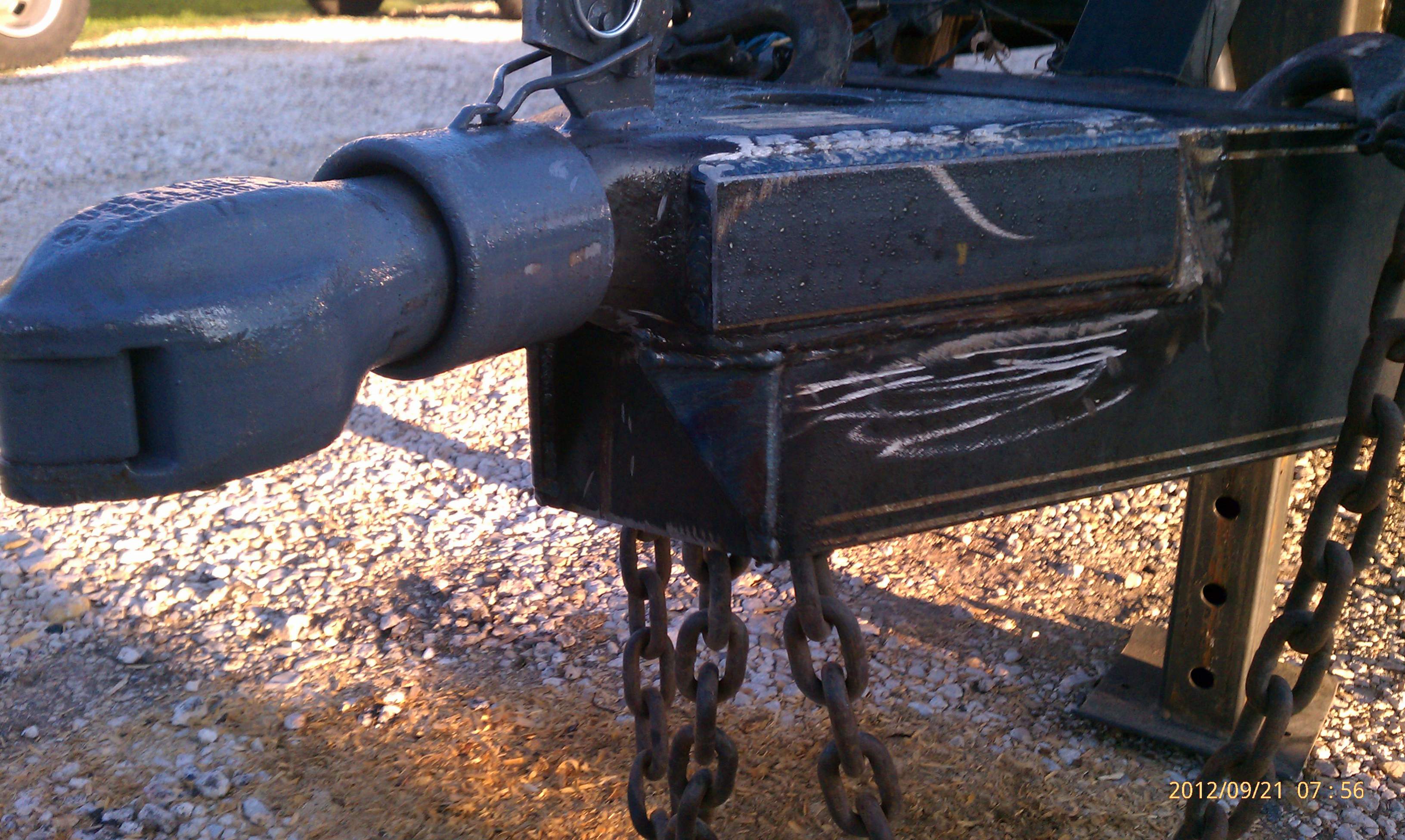

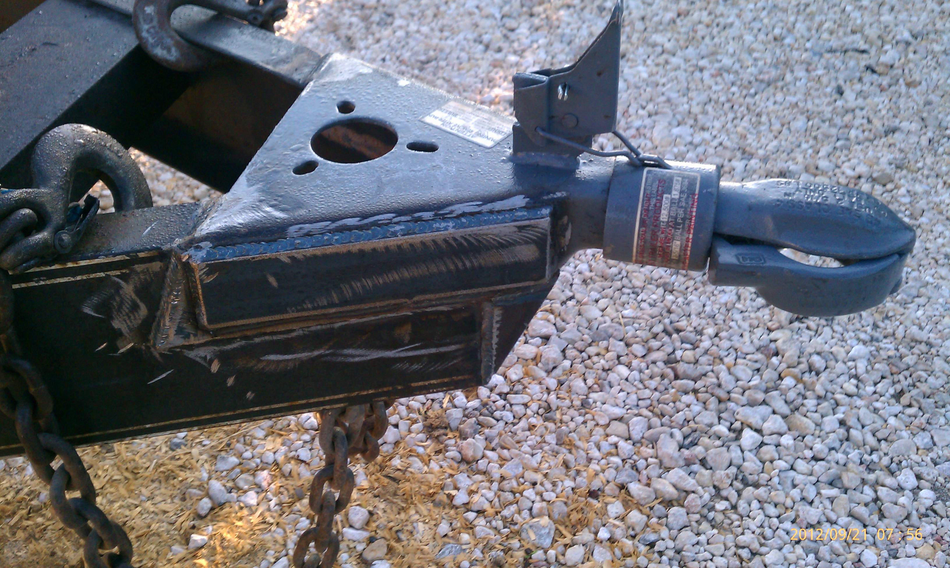

Thought I would post up some pics of the hitch all welded up, just needs paint now.
   / Could have been a bad situation.... Bulldog coupler torn. #19
Looks very professional and well braced. :thumbsup:
