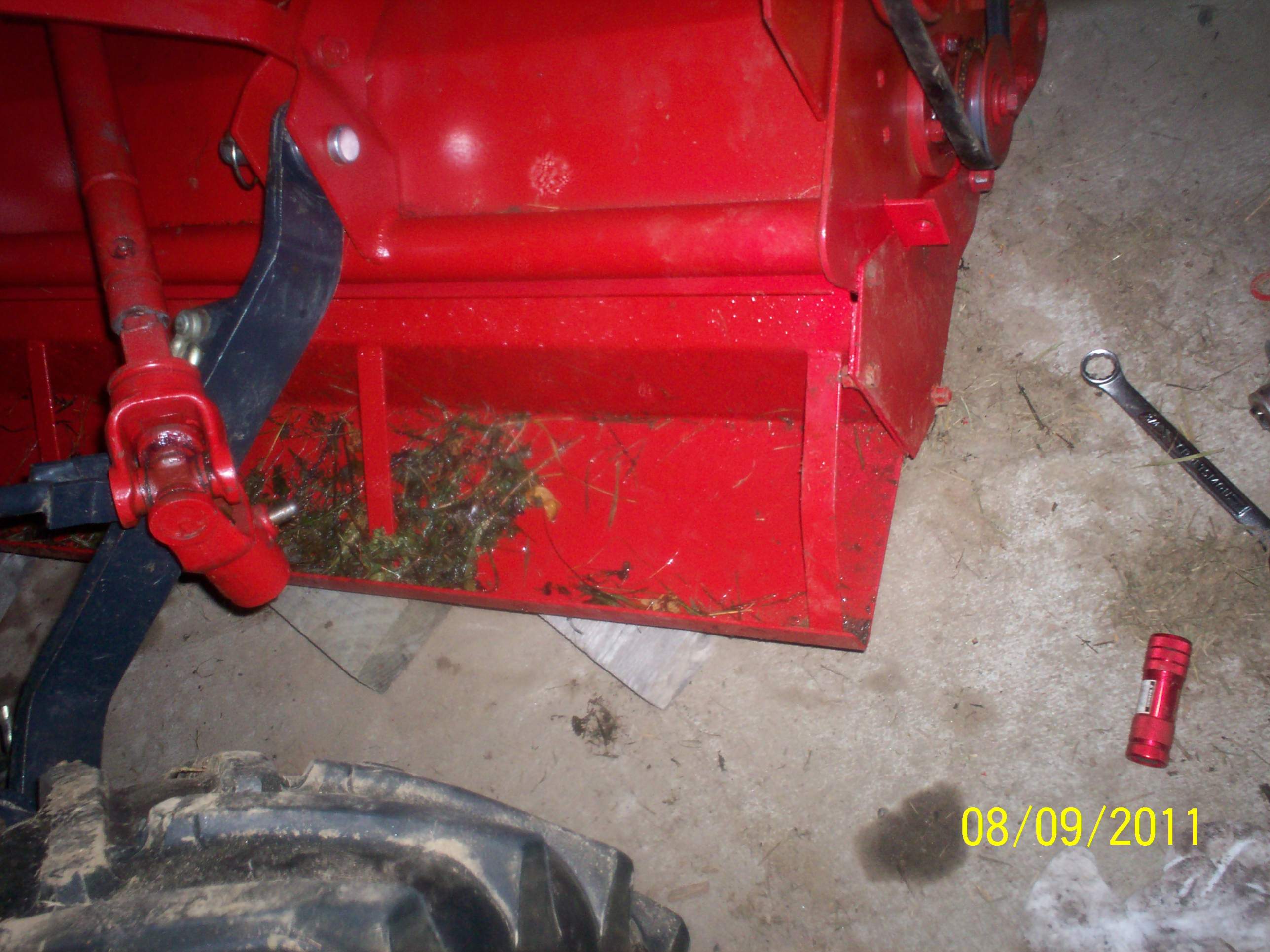

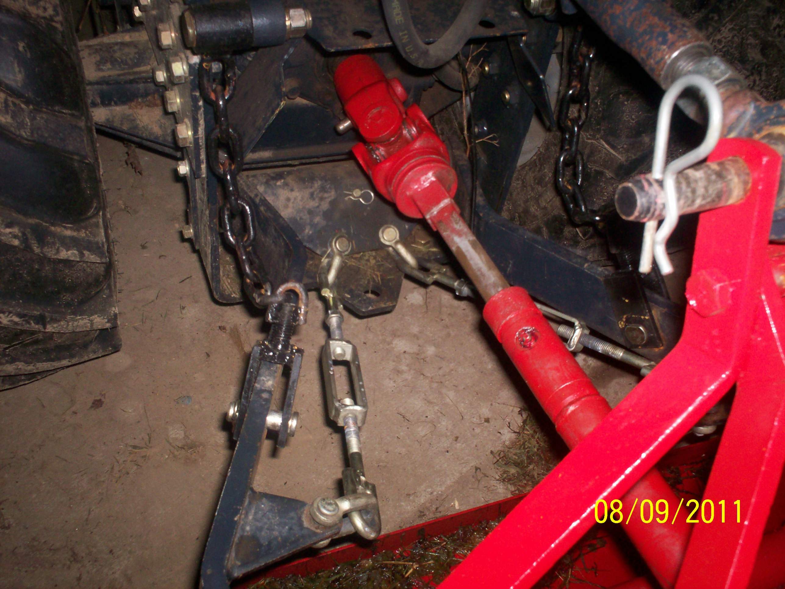

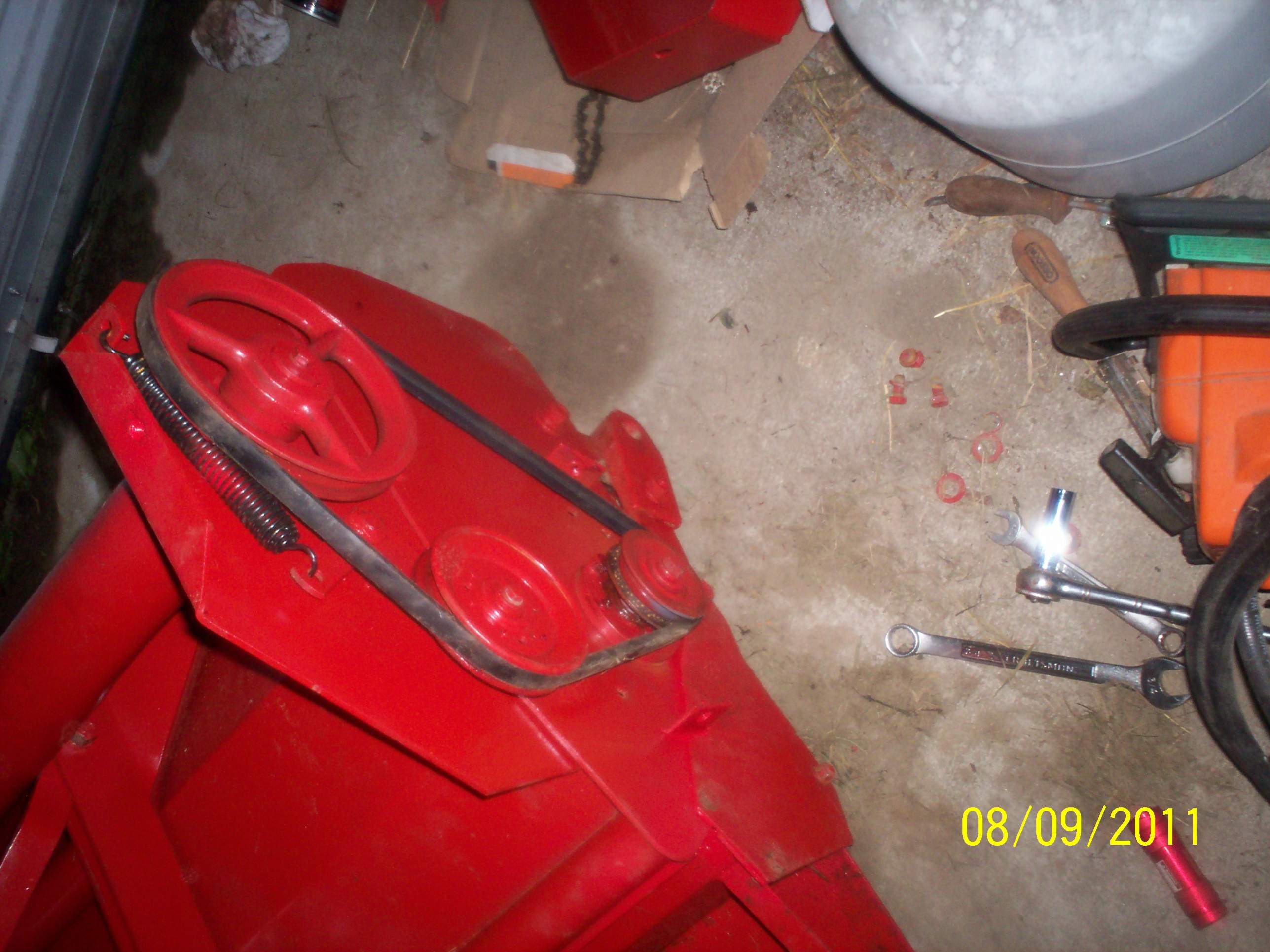

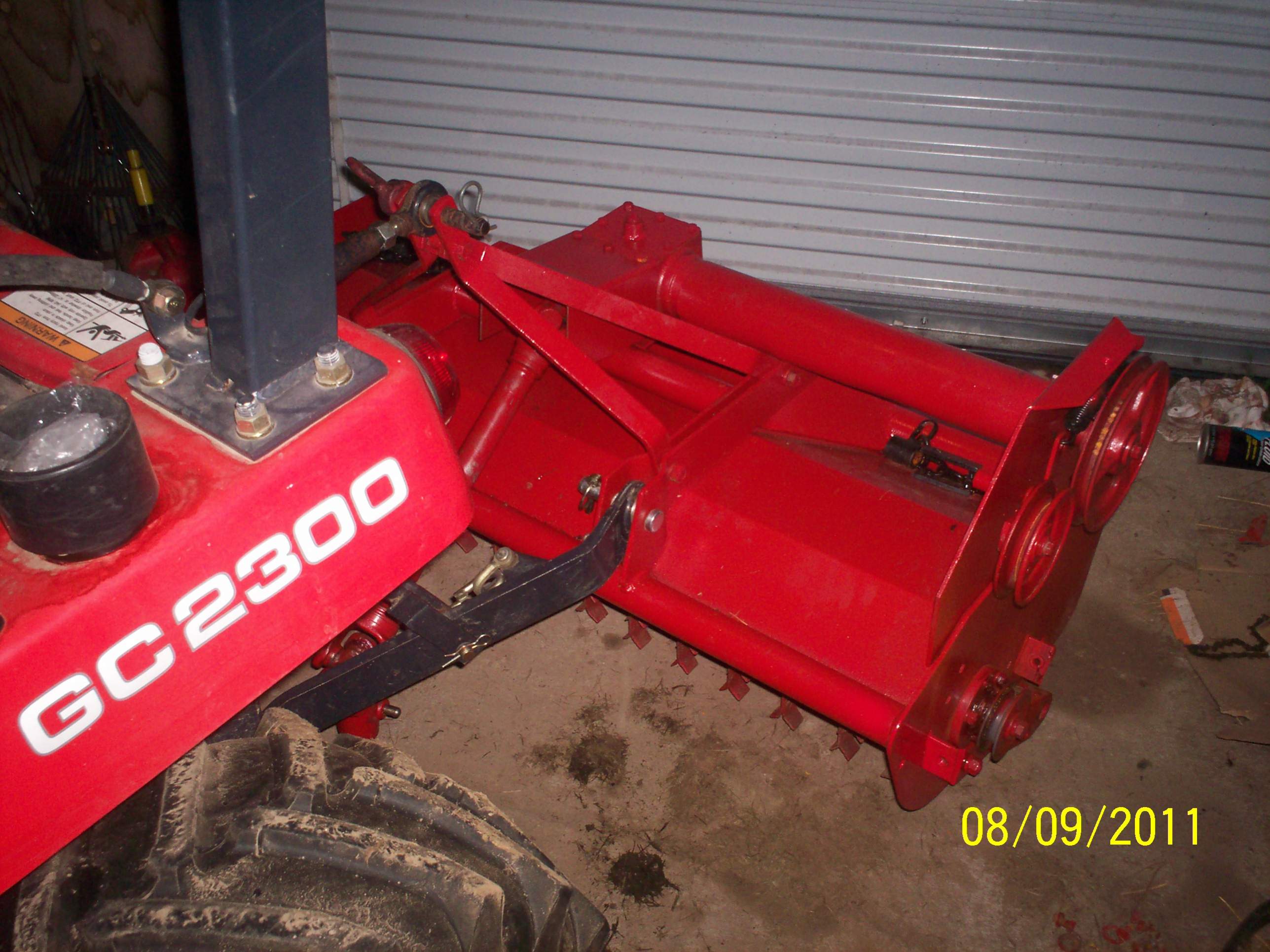

I don't know how to navigate this site and reply to each person.
I put the guard back on and moved to up so it is not close to the ground.
Started to mow good then stop belt is slipping/ smoking
The spring is brand new but it does not feel like a very strong spring.
had a fill nut for gear box put on it and home made lift chains.
part number of guard is 700384.( could see it in marker)
attached are photos, is it a KB48 see how pulleys are on the left hand side facing the tractor compared to going to the right.

   / counterclockwise mott mower 48" #16
Hello Al,
Your biggest problem with the flail mower is the
fact that the flail mower does not have any skids
and that is why it has trouble mowing and you have
to have them.
The flail mower must be riding on the skids and
rear roller both in order for the flail motor rotor
to come up to speed to mow properly.
Apparently someone removed the skids and did
not replace them. Please check with flailmaster
to see if they have skids that will fit if you cannot
have them fabricated locally.
Edit: Al the two bolts at very bottom edge of the side
plate in the picture you have provided are where the
skid shoes should be mounted most likely and someone
removed them unfortunately.
