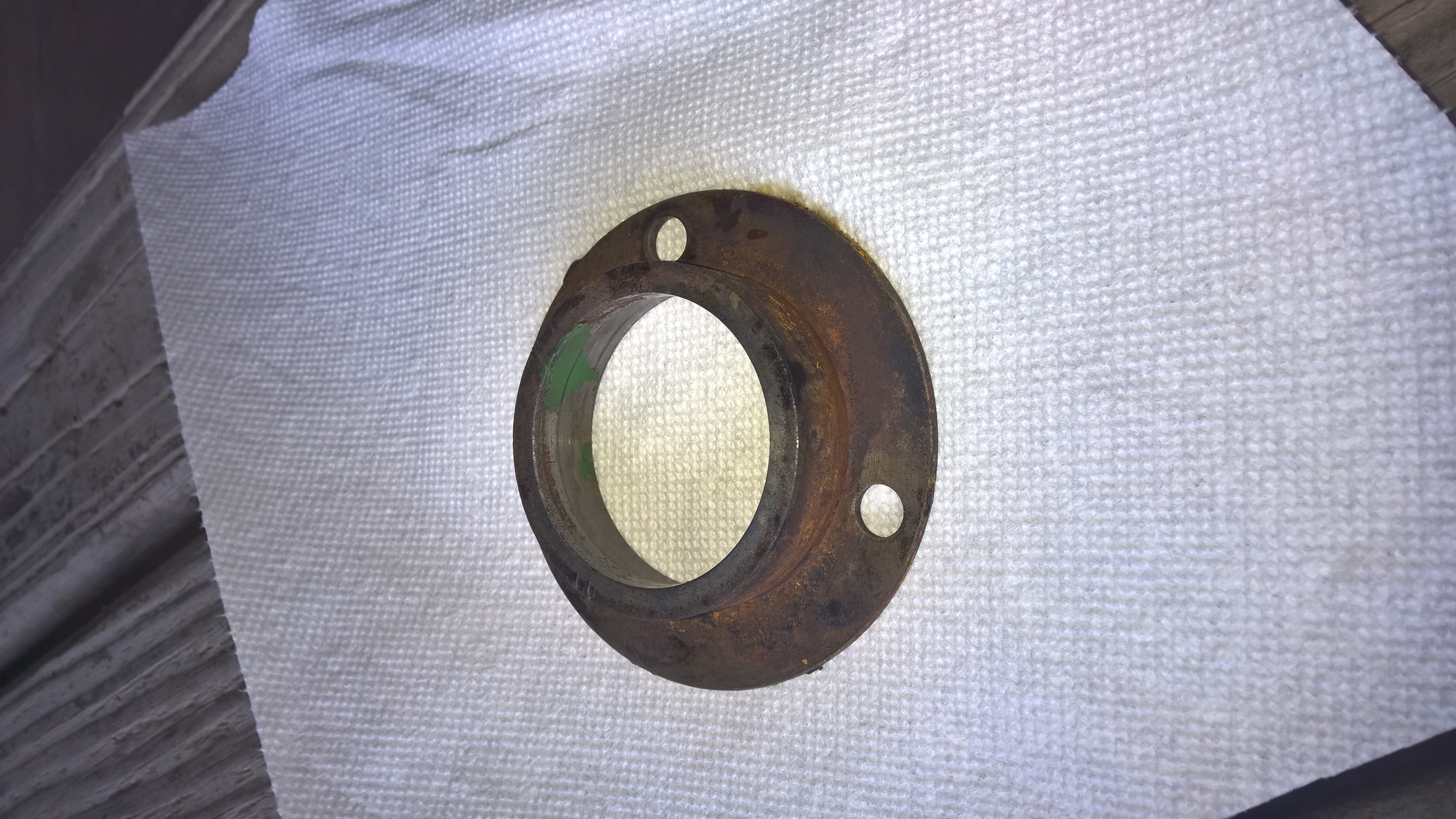

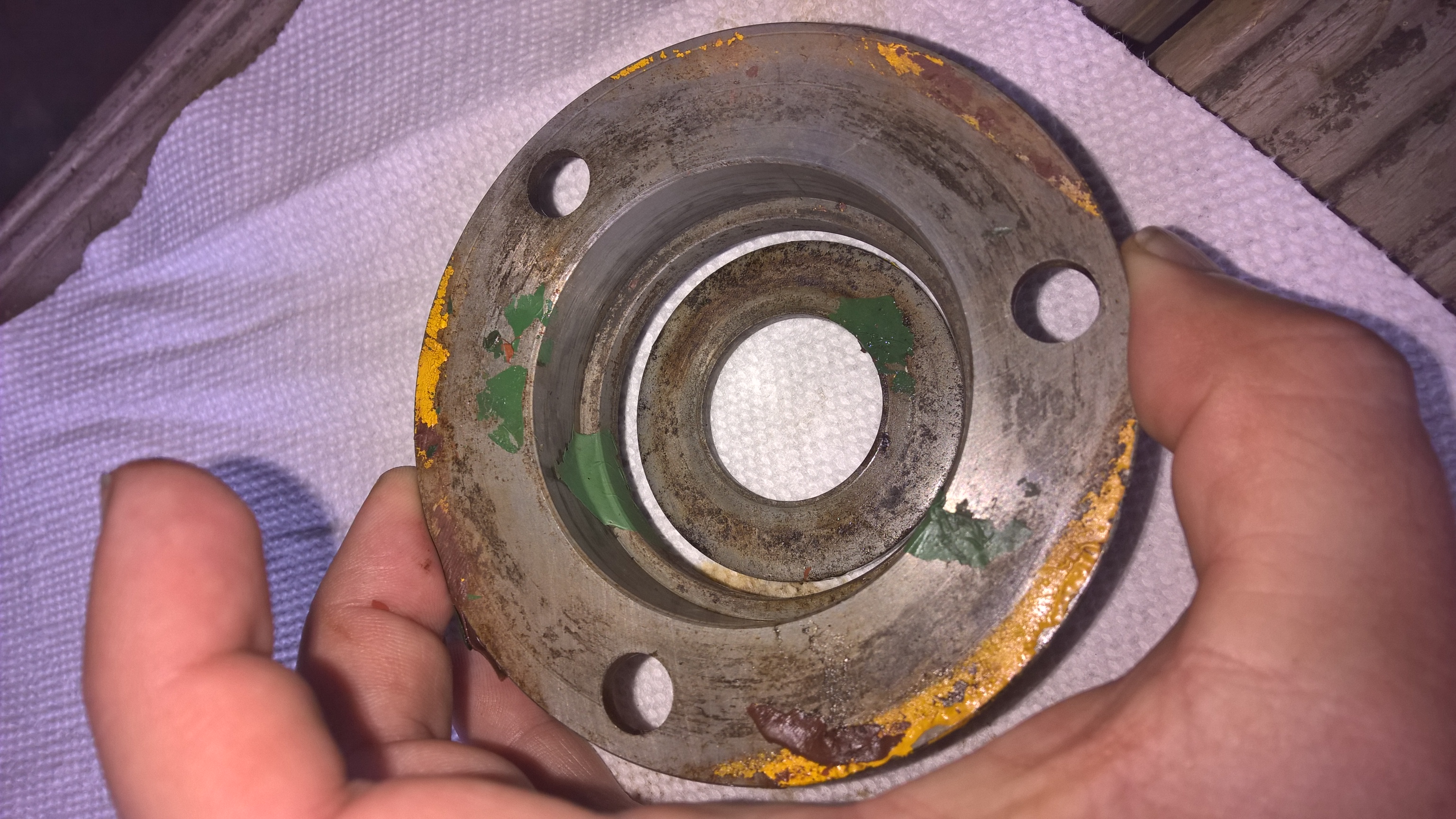

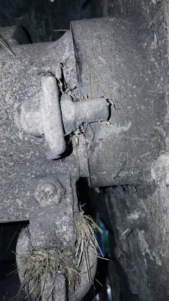

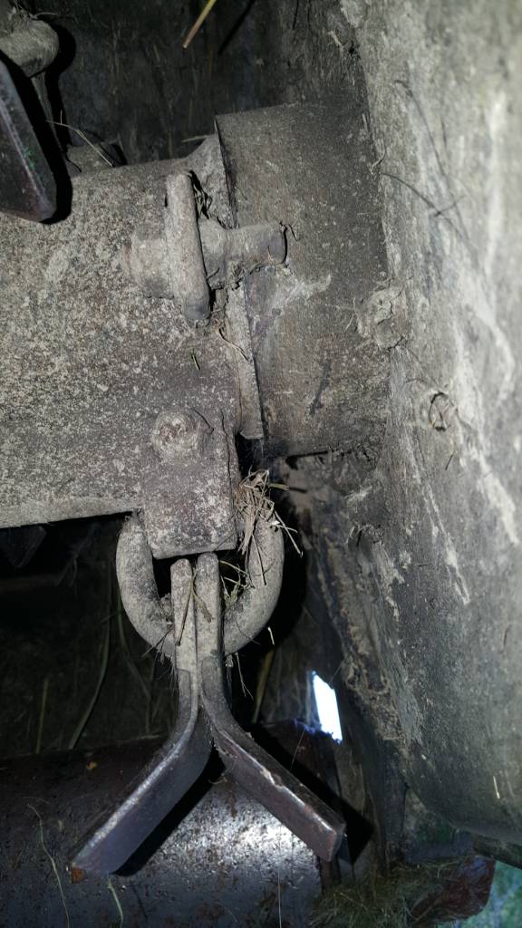

Let me describe The 390. The end of the rotor is recessed into a collar on the bearing housing. The rotor has a piece of rod attached that overlaps the od of this collar. As the rotor rotates the rod throws off grass to prevent from wrapping.

Regarding your larger knives. Are the holes in the blade for clevis pins the same size? My only concern is the increased mass of the larger blade and the subsequent increased loads on the clevis pins and mounting structure that is welded to the rotor shaft.

Just for reference, I think that the grass height is set at the second to highest position (of 4). I will double check that. When on concrete, the distance between the blades and the ground is about 2".

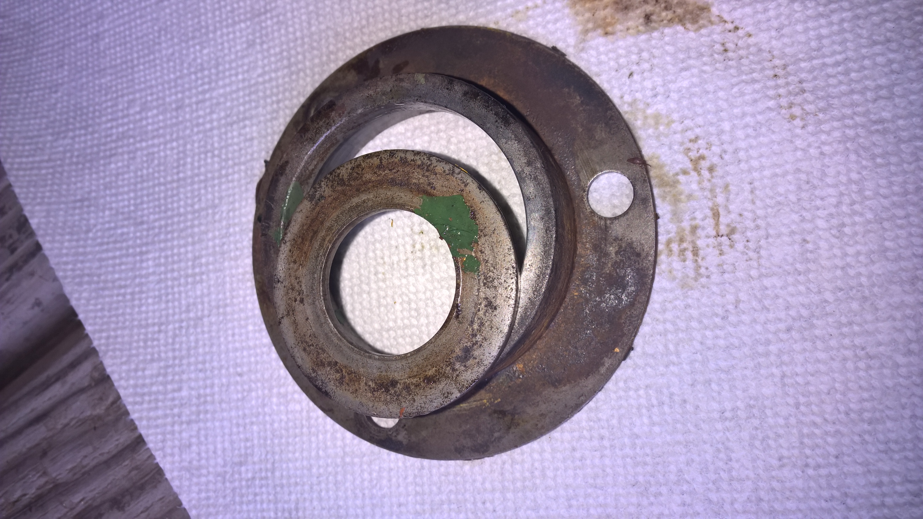

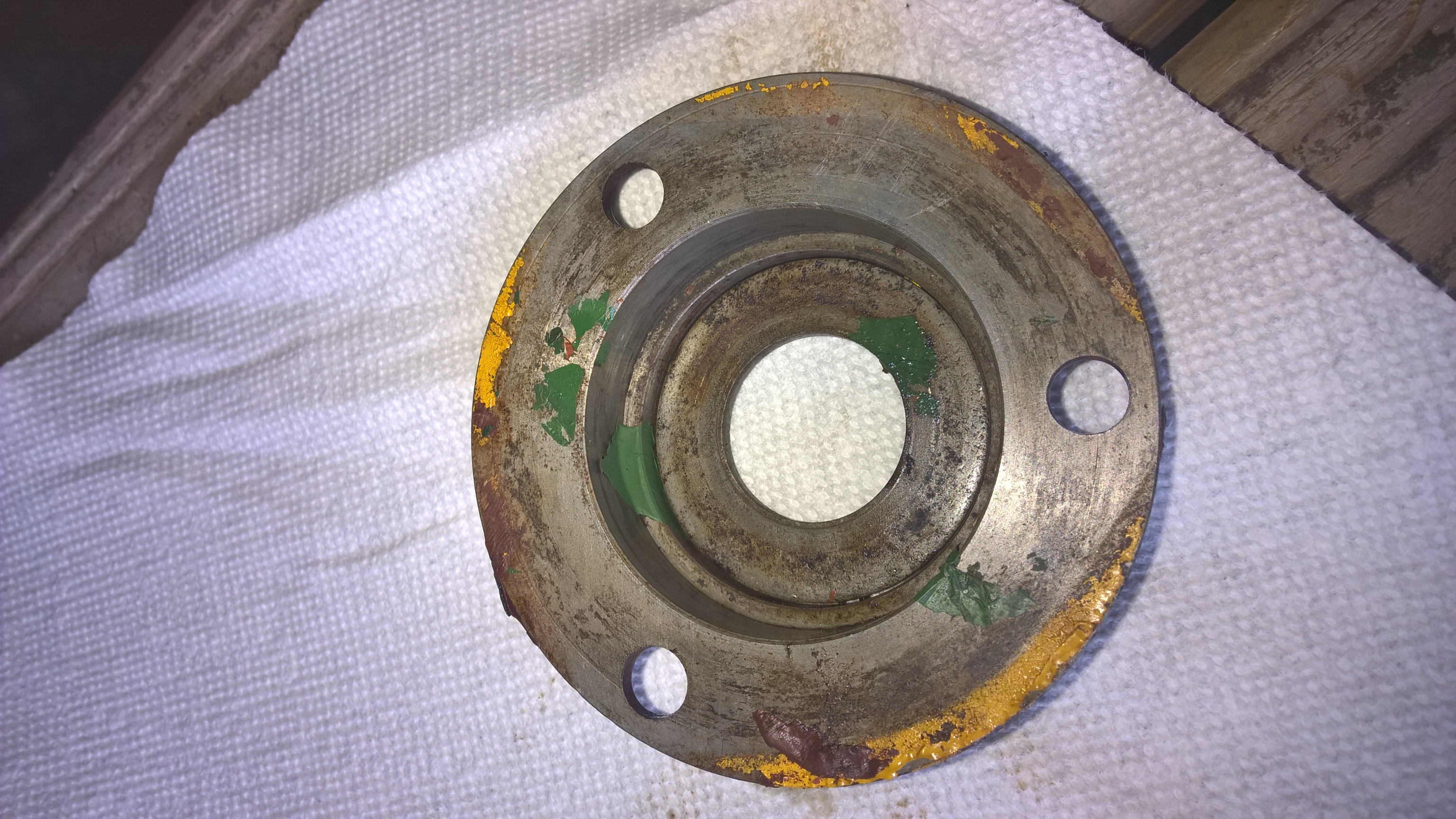

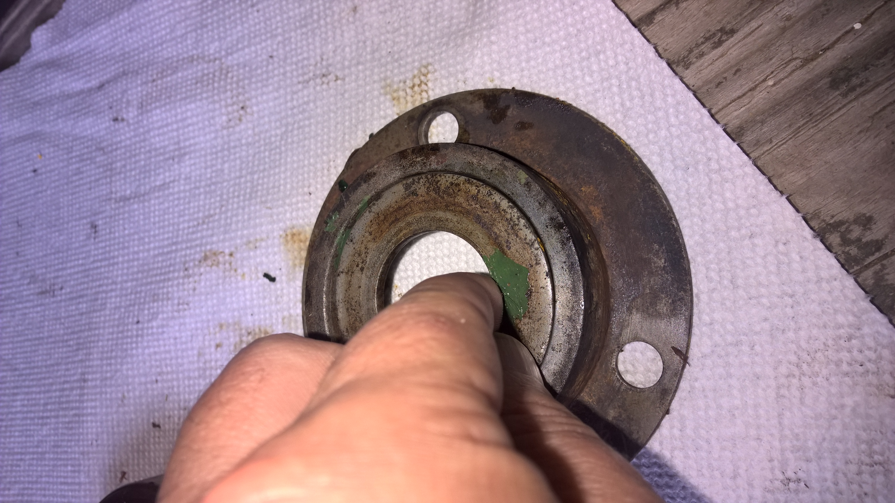

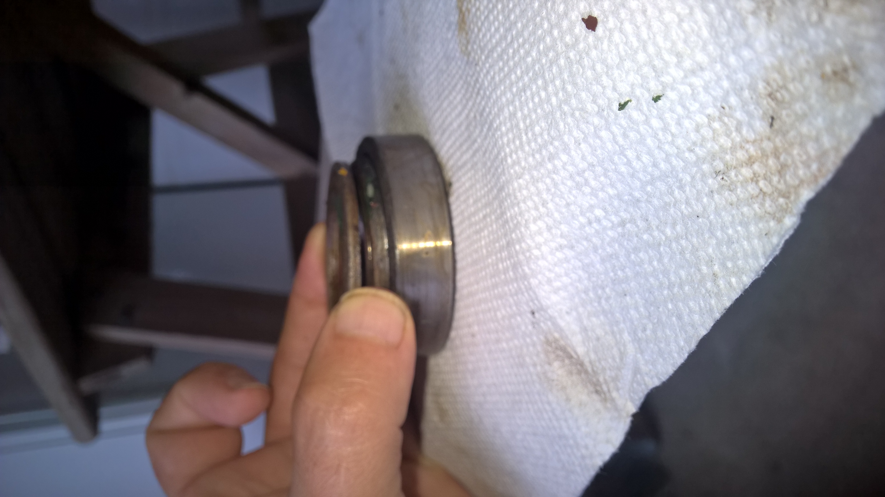

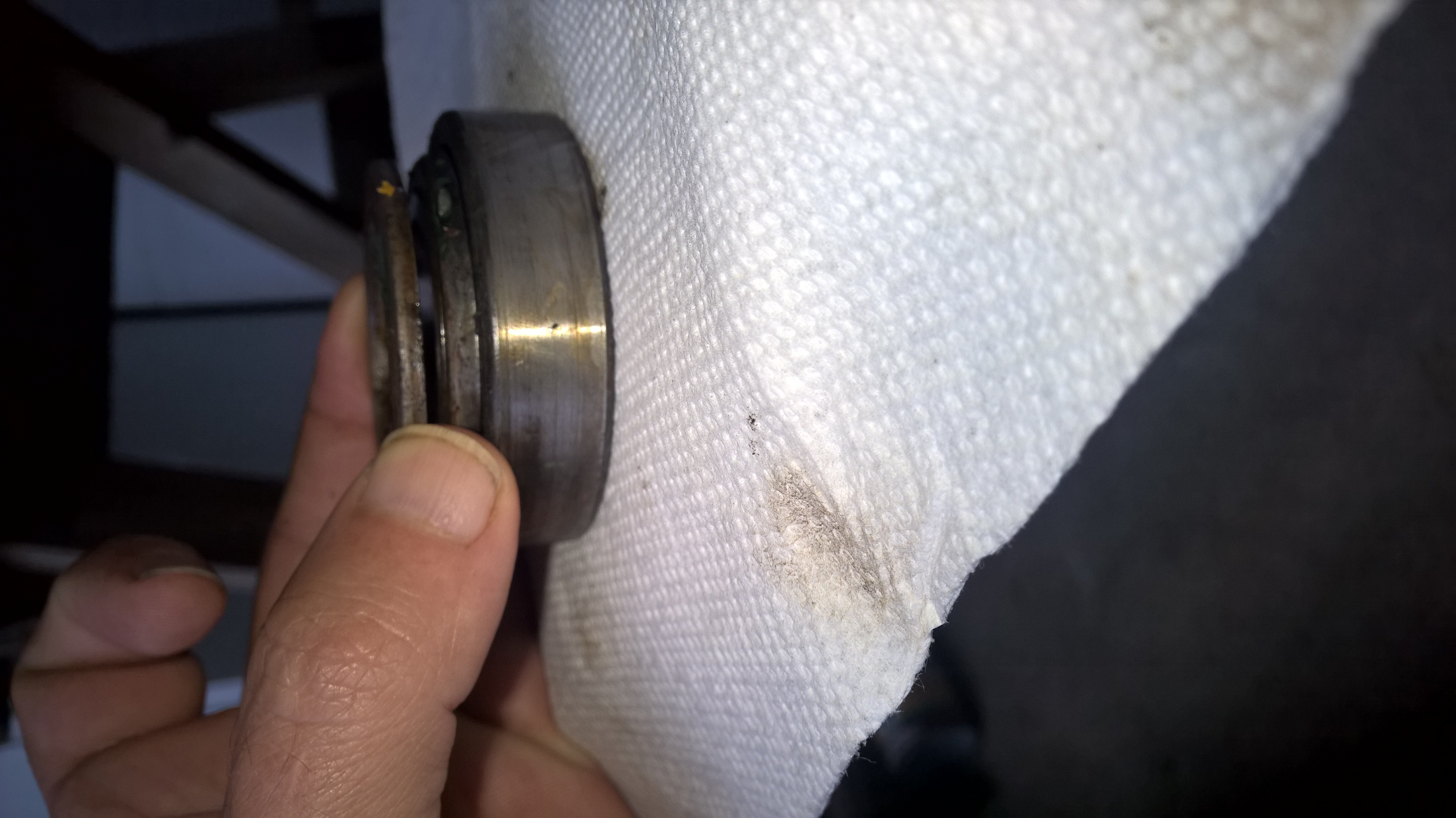

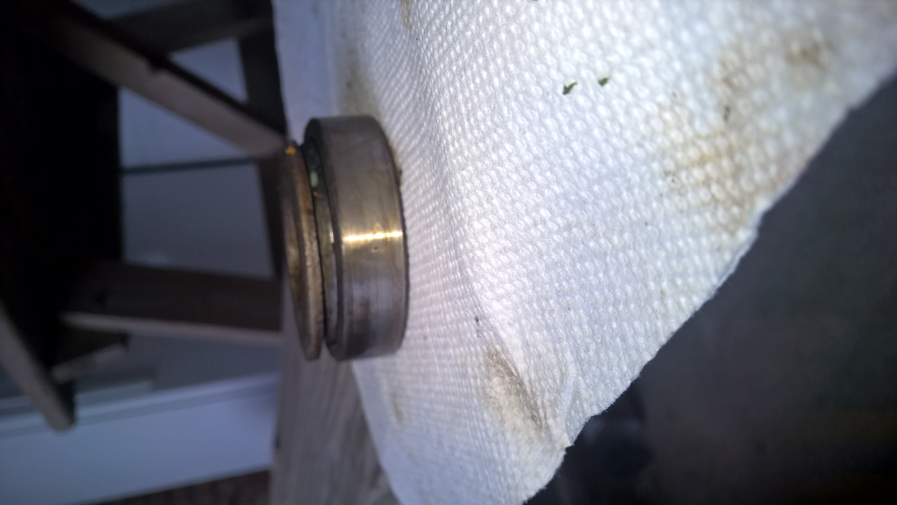

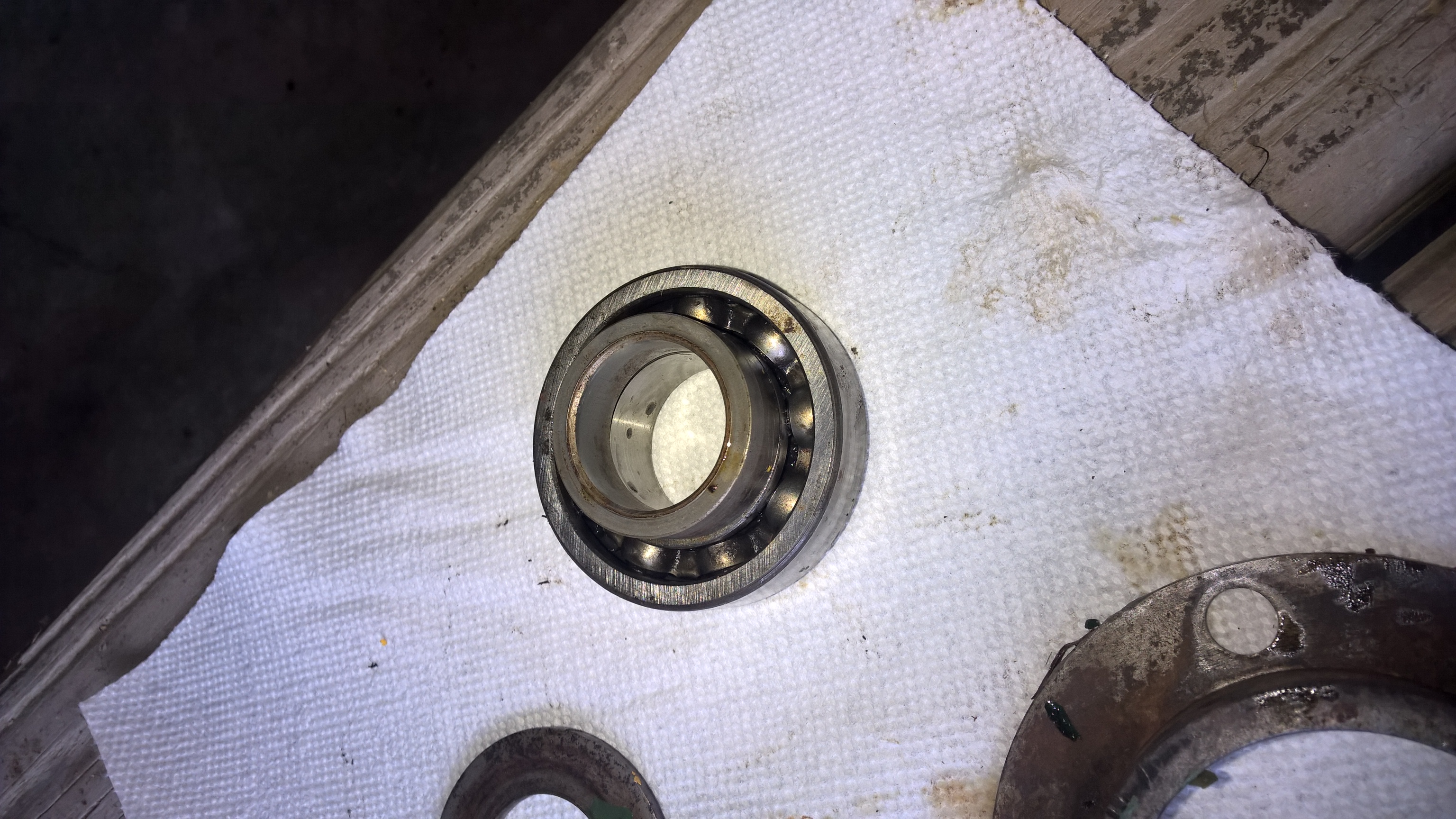

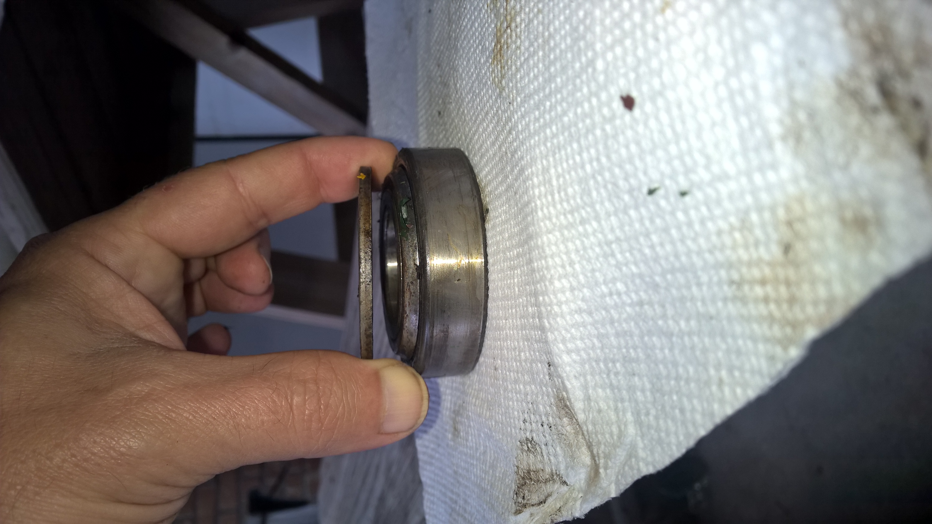

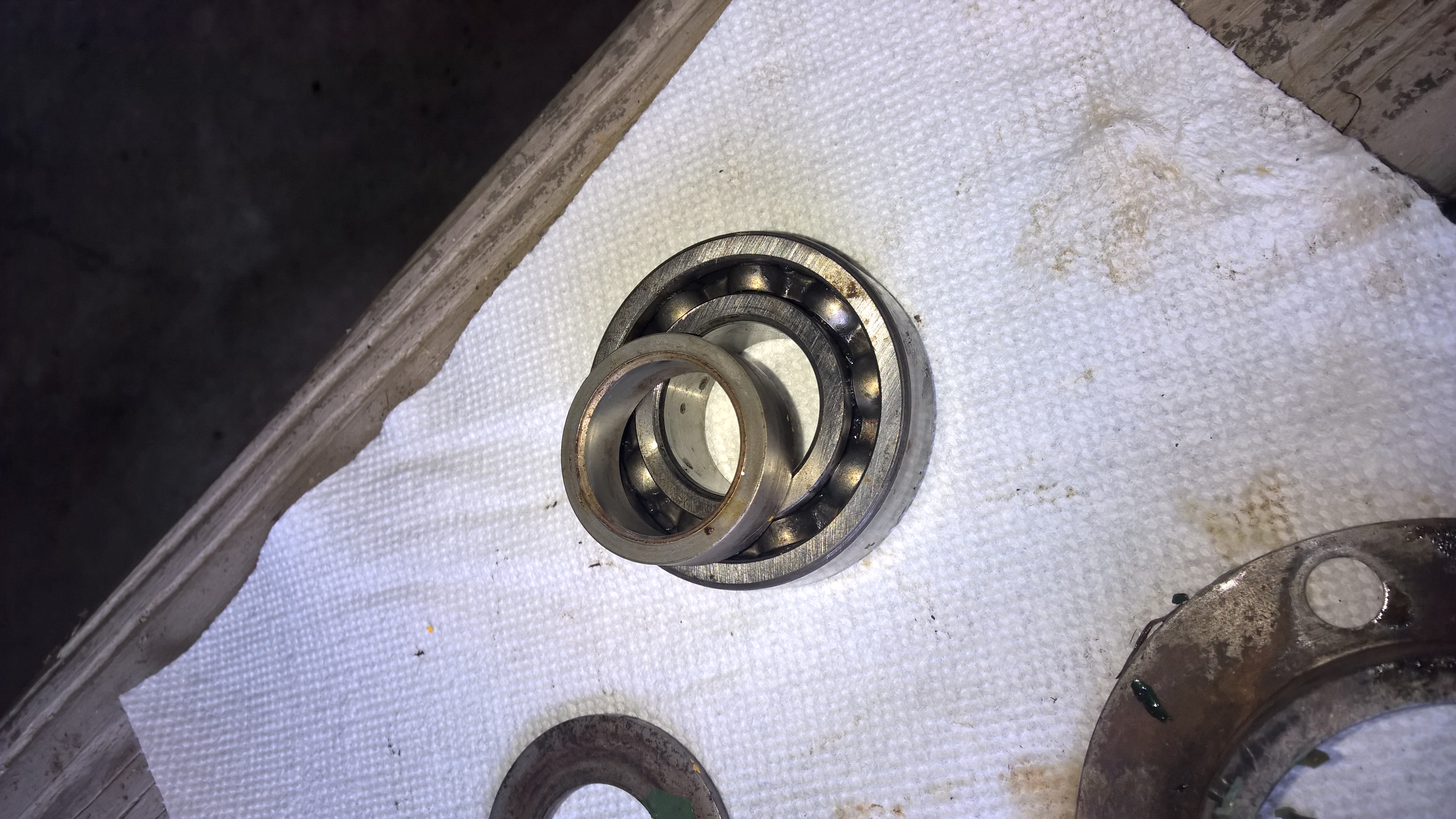

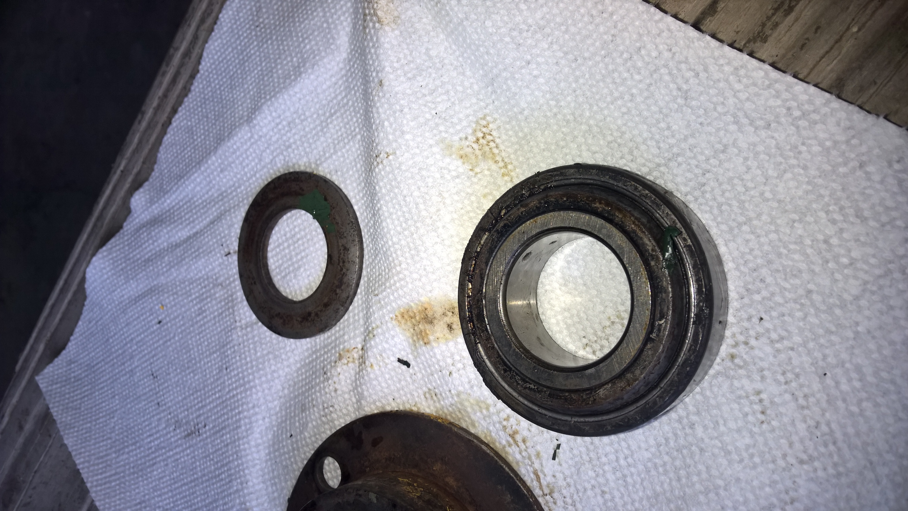

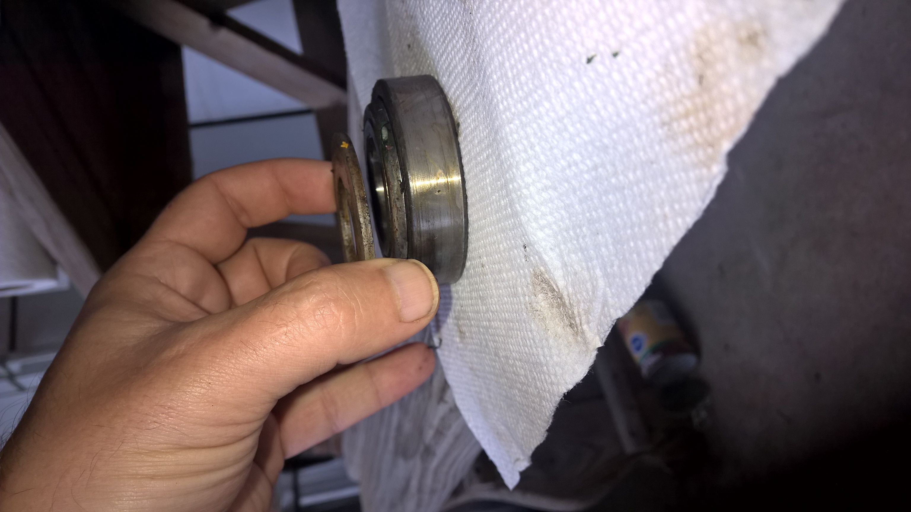

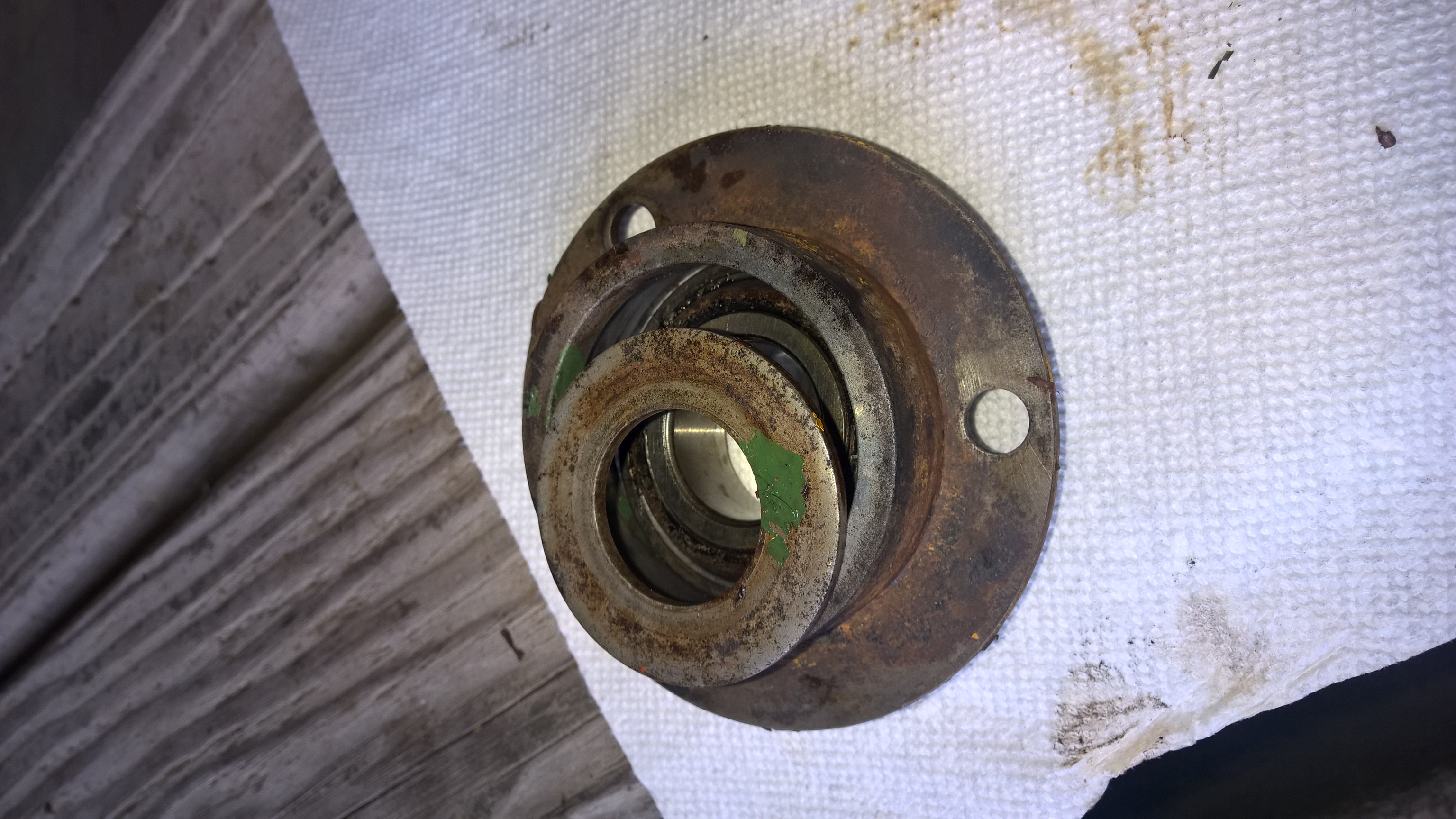

In regards to the seal on the bearing, it came out just as pictured. I have looked at pics of new 206KL bearings for sale on ebay etc and they look the same as mine....the outside is open and you can see the cage/bearings, and the inside face of the bearing that is resting up against the seat/lip of the housing and facing the inside of the mower has what I guess it a type of metal seal (the dark area between the races, that has the printing/lettering on it...or is that just the back side of the cage?) It doesn't seem like a total seal, more like a semi seal or guard because there is daylight on the outer edge of it, near the outer race, and fluid can pass through.
Further inboard of the bearing, a thick and very tightly fitted seal washer sits up against the interior side of the bearing. The washer is the exact OD of the bearing and rests inside of the collar. The cutter shaft butts up against it. i will try to get a good pic of it. It is in the schematic also. It seems like it would do a good job of keeping grass out for sure, if not tiny particles, dust etc. But the grass got through it somehow, through the dark metal shield/seal of the back of the bearing and out through to the pulley.
Chris, if you can take the old roller bearings to a KAMAN Industrial store if you have one nearby as with your conditions you may end up using a completely sealed bearing-0just be sure to tell them that your operating RPM will be 2200 RPM+- to obtain the right bearing.
I am not sure if I am answering your question Leon. I can try to take some better pics of the bearings if you'd like. I have them both removed now and pressed out of the housings. I had a very hard time getting the drive side housing out of the mower shell. Once it finally came free, I was able to inspect that bearing more closely and it was a goner. The non drive side was almost like new in terms of feel etc. That side wrapped a ton of grass also, but it did not seem to make it's way completely through the bearing.

Here's an idea for a bearing cover to kick around. You can buy the magnetic metal 'dish' at most any auto parts store to hold small parts, screws, etc. Could you adapt one of those or similar preformed metal items to allow sliding it over the 'knife shaft' possibly, with a collar of some sort with a set screw or two, to hold the dish edge against the 'wall' where the bearing is housed. Maybe the dish could remain pressed against the bearing's 'wall' and just the collar could turn with the knife's shaft?
It's a 'rough' idea of how to possibly seal the bearing from grass access, which should remedy the issue.

Yes, that's correct, the washer stayed on the shaft, largely due to being held there by the grass entganglement I guess. It is definitely just a loose washer on both sides, as indicated in the parts diagram (number 12, they call it a "bearing shield washer"). It is however, a very tight fit into the inside of the collar on the bearing housing and I would think would provide a good seal/shield against large debris. It sits fairly flush with the end of the housing collar, maybe recessed inside a little bit. Yes, I agree, the grass entered at the OD and I think ID also of the washer and then made it into the bearing and then on through to the exterior and up to the pulley.
No, there is no clip to retain the washer, it just sits on the cutter shaft, inside of the bearing housing collar. I will post some better pics now that all of the pieces are disassembled. It may be easier to understand how it is set up.

Thibodeau, thank you so much for the input/ideas/help. I really do appreciate it. I had initially thought of trying to attach something to the collar itself vs the shaft. But I see that your idea of welding the key stock would probably be much more effective. My only concern is if it would potentially throw off the balance of the shaft?
Some of the factory weights that were added were pretty small, although they are corroded now. I didn't know if even something as small as the piece of key stock could through things off? It seemed to be pretty well balanced and smooth on the test cut that I made, no vibrations at all.
Regarding the knives, yes the holes for the clevis pins are the same size, 3/8" I believe. I was concerned about the increased load also, as well as clearances. The old clevis pins are worn in half on some that I have looked at, so I am glad that I ordered the new ones. The old ones look fine from the outside, but once removed, the middle section of them is worn down substantially.
Yes, it does appear that the bearings would be secured axially to the rotor by bolts that compress the inner races to the rotor. The rear side of the bearing facing the shaft, has the inner race protrude outward toward the cutter shaft, although it contacts the shield washer first. So the shield washer is only in contact with the inner race and not both inner and outer.
There were no shims installed. On the non drive side, just a smaller washer, about the diameter of the inner race, a lock washer, then the bolt.
On the drive side, there is a pulley spacer (number 8 in the schematic) that is the same size at the inner race, then the pulley, which is keyed, rides against that spacer, then an identical washer, locknut, bolt set up as the other side, only additionally securing the pulley in this case. Neither of these bolts were torqued tightly at all upon disassembly. If I had to guess, maybe in the 30-40 lb.-ft. range? Probably less. So should I just basically snug those up when I re assemble? I don't want the shield washers or pulley spacer spinning, I'm assuming?

Hmmm, that was exactly why I was curious about securing the shaft/preload etc. There are no set screws or locking collars of any kind on this set up. Just the two bolts at each end of the cutter shaft?? I'm not sure what exactly holds each inner race to the shaft and keeps it immobile? The bearings are slip fit. There is a slight raised/machined area of the shaft where the bearing rides on the drive side. It steps down from there for the pulley spacer and pulley. But it is very slight. You have to feel for it with your finger nail. And the non drive side is short so doesn't have the minimal step down.
But regardless, the bearings slip on and off with ease, even after sitting all these many years. They are not like a strong press fit onto the shaft. So I assumed that the horizontal force of tightening the bolts at the ends of the shaft is what sort of locked everything up and secured the shaft to the inner race of the bearing??? I'm confused.

The pulley spacer in the pic can be seen on the shaft in the first set of pics with the grass in the bearing.
