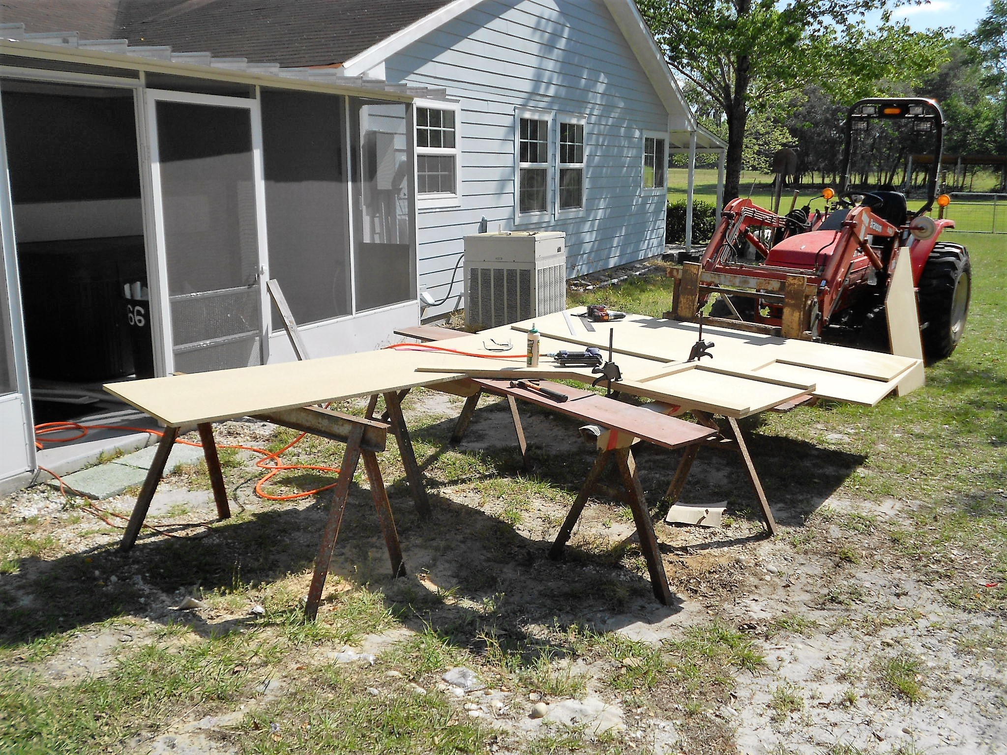

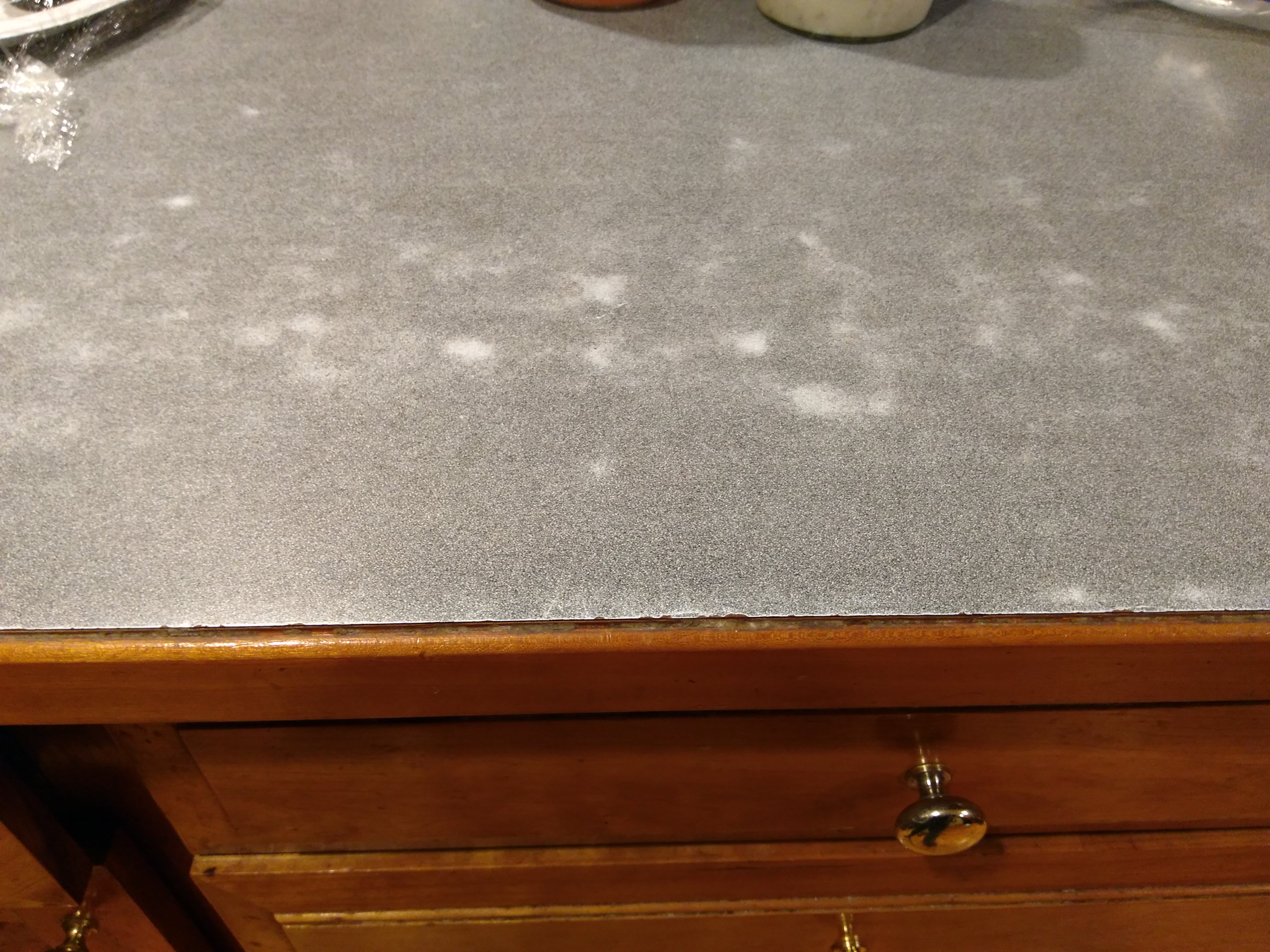

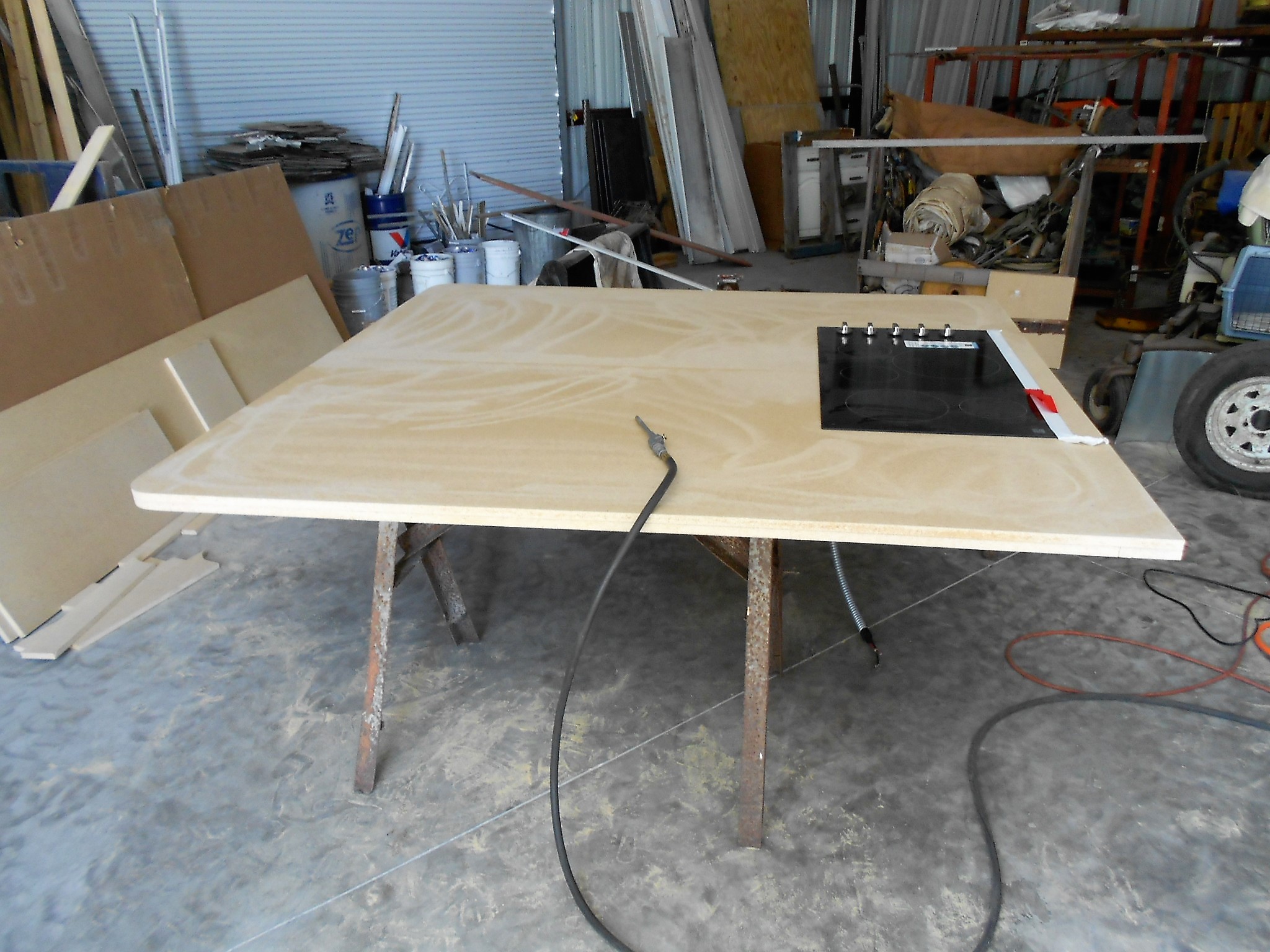

Hmmm, we have some well worn Formica countertops and some laminate sections. Any tricks to it? I assume that you glue it down to what's there and then trim the edges to match?
Aaron Z
If there are no uneven areas and it is still fastened solid and straight my best guess is you rough the old up with fine sander.
The laminate is applied to partical board with contact cement so attaching to old laminate should work.
You apply glue to both sides then let it tack.
With a bunch of things (I used 1/2" sticks cut on table saw) to keep them separate, you line up and remove sticks as you go burping as you go.
You use a router to trim edges but you always add the edge strip first, route even, then apply top. This lets top overhang the side.
There are a bunch of utube videos showing/explaining it.

They say a picture is worth a thousand words right?
It's pretty smooth except for some dings at the edge as you can see in the picture above.
