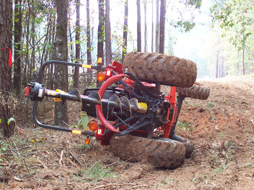

<font color="blue">.hopefully won't be of a Kubota laying on it's side. </font>
It can even happen on flat ground...as MFLB posted previously. Image of his B7800 Kubota attached. /forums/images/graemlins/shocked.gif

   / Counterweight to Avoid Rollover? #32
