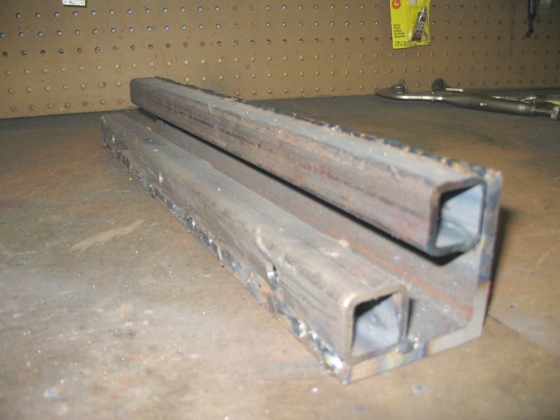

I finally completed the tailgate for my Country Manufacturing wagon and it works beautifully. It looks and works like it was standard equipment. This fairly inexpensive modification now makes a very good dump wagon even better and much more versatile.
The goals of this project were: <ul type="square"> [*]Make no modifications to the existing wagon except for drilling holes. In other words it must appear to be stock and must be able to return to stock easily. [*]Use whatever material I had on hand (and I have a pretty good selection). [*]The tailgate must be easily removed. [*]The KISS principle must be rigorously followed. [/list] I think I have met all my goals. /forums/images/graemlins/smile.gif
Thee are only 5 assemblies, 2 end posts, 2 tailgate latches, and the tailgate. 1" square tubing was used for the tailgate frame and for parts of the corner posts. 2.5" x 1/4" angle was used for the post sides and 2" x 3/16" angle was used for the tailgate edges and parts of the latch. 2" x 3/8" flat bar was used for the hinges and latch.
I also replaced the side boards with 5/4 x 6" pt decking and put a piece of 1/2" cdx plywood over the floor planking. Packing scraps and one of the original side boards were cut to make the wood on the tailgate and front end.
Total time to build was 2-4 hours each day over a 7 day period. A good portion of that time was "thinking" time.
A few pics of the assemblies will follow.

Here is one of the end posts prior to cleanup. It is a length of 2.5" x 1/4" angle and 2 lengths of 1" square tubing. This design was chosen because the channel on the existing stock post is 1.25" and the angle and square tubing together fit perfectly in the stock end post channel.

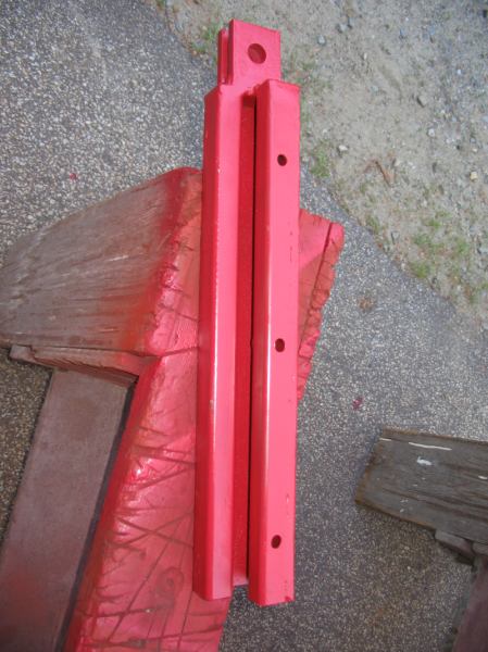

Here is the finished end post. Three matching holes were also drilled into the side of the existing post and 3 nuts were welded to the back of the 1" square tubing on this post.

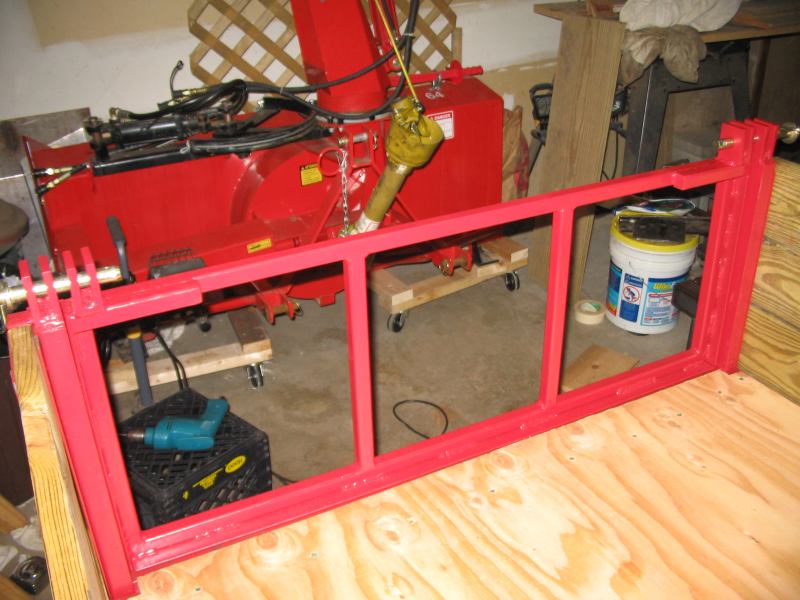

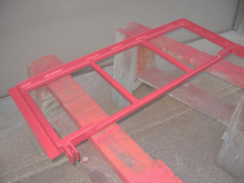

Here is a shot of the back side of the tailgate to show construction details.

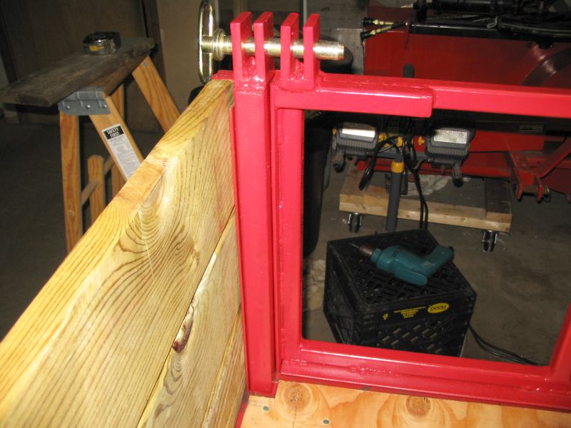

Here is a close-up of the hinge assembly. I had two different designs, one that used some 3/4" schedule 40 pipe and this one which I got by taking a look at a 10 wheel dump truck's tailgate while I was stopped behind it at a traffic light.
All the pieces for the hinge came from the scrap barrel.
You can also see how the end post fit nicely into the stock end post channel. I loose about 1.25" of end opening width on each side but in the grand scheme of things it is noise level.

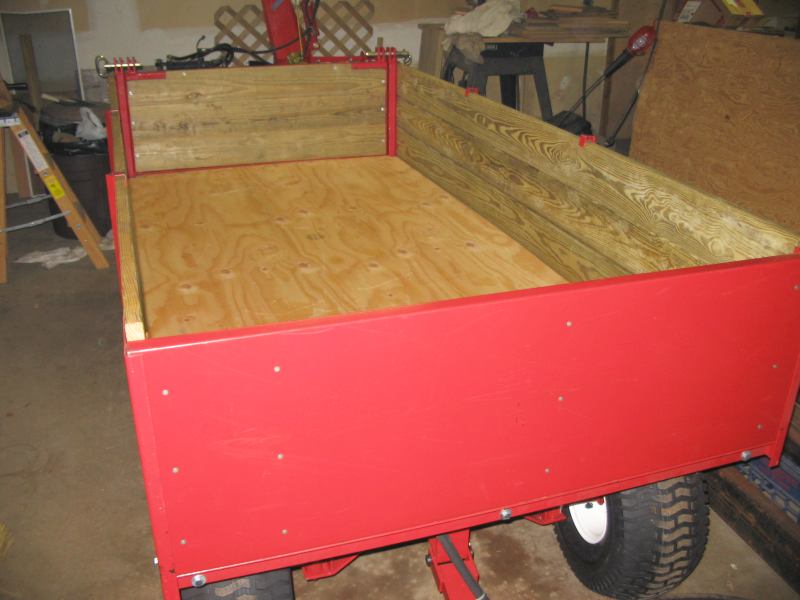

Here is a picture looking in from the front of the wagon.

Finally, although you can't see it here, there is about 1/8" around the 3 sides of the tailgate. The 2" angle gives an overhang that makes a good enough seal for dirt/sand material.
1.5" angle would have been perfect for around the tailgate but I did not have any in stock. I had to cut about 1/4"+ off each side to get proper clearance between the stock end post.
