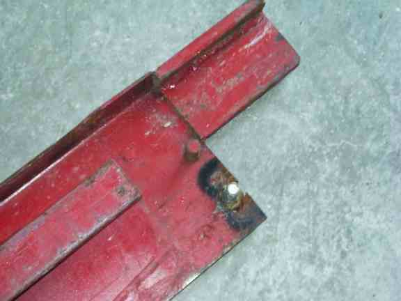

Here are some pictures of the modified Country Manufacturing tandem-axle trailer we have at work. I needed a flat bed for some of the things we haul, (including grand pianos!) so I carefully cut the welds between the rear uprights and the cross-member they were attached to. Then I added some bar stock to the bottom of the uprights, and a locating pin. Here is the passenger side upright, with the added material.

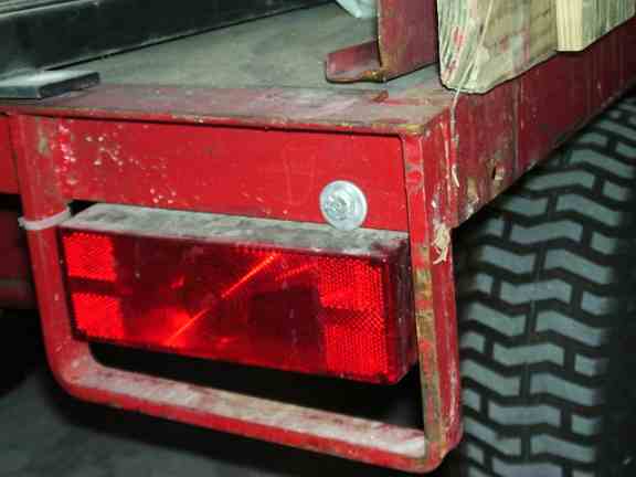

The added pieces on the uprights rest against a "u" made from more bar stock, to keep them from flaring out at the top. The "u" also acts as a guard around the taillights I added. (For a little extra safety, when we are moving things through the parking lots in the middle of the night.) Here is a picture of the "U"

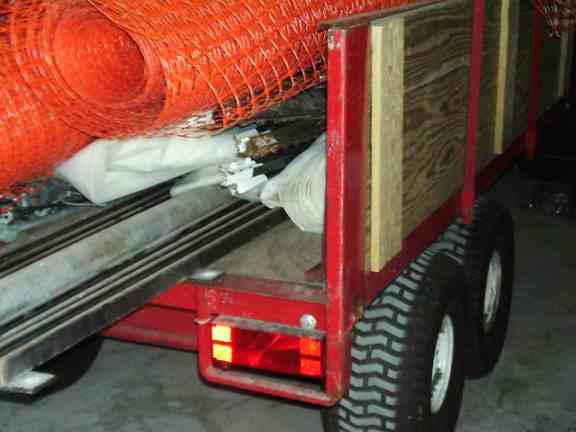

Here's a picture of the back end of the trailer with the upright in place....it's full of stuff right now, so I didn't get a picture of it in "flatbed" mode.
I want to get a picture of it some time with the 9' Steinway on it, to send to Country Manufacturing.
