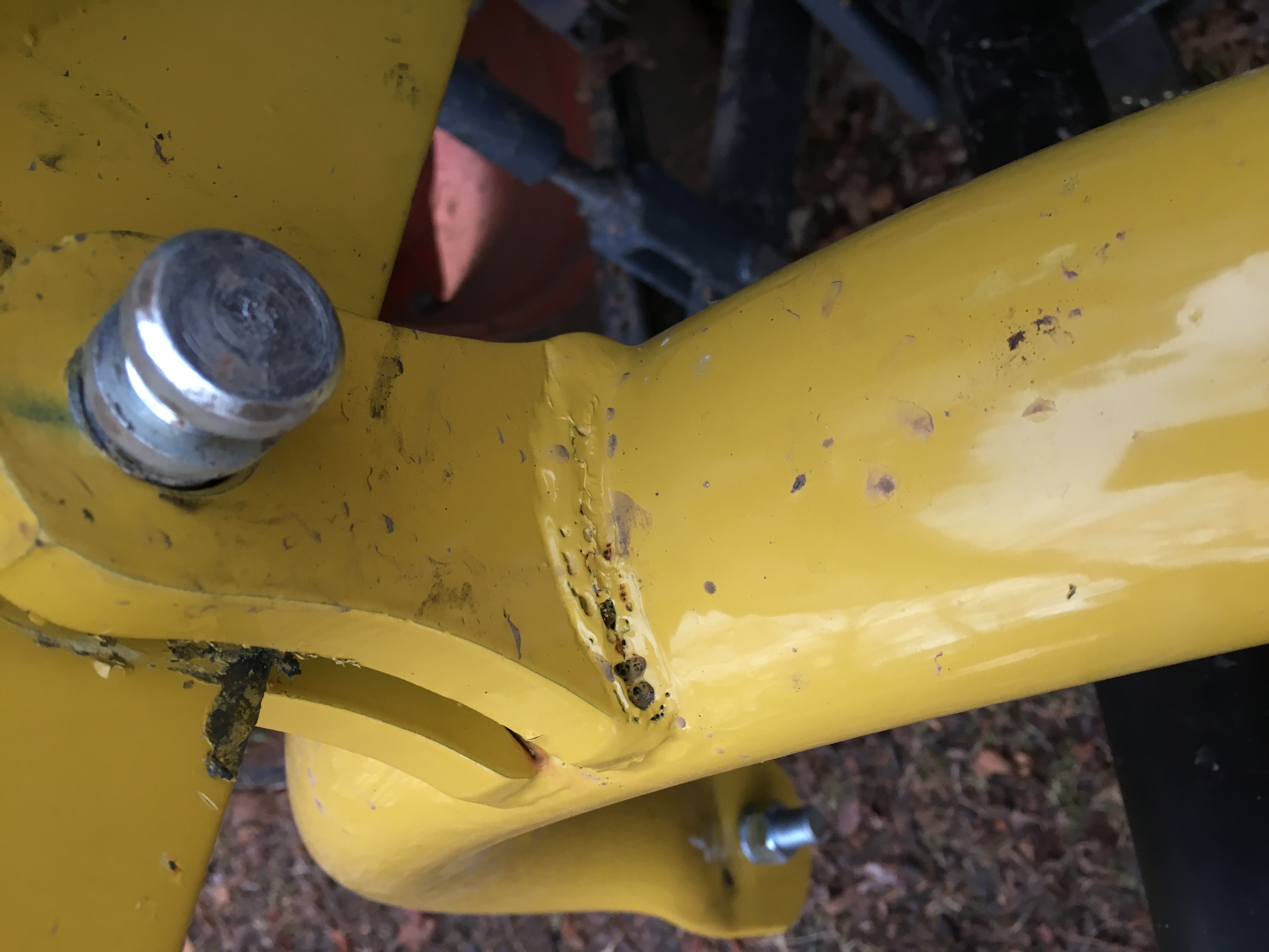

Careful which one you get from the lot. Check the welds before you take it home. Lots of porosity here. Dang tab was almost broken off after three holes.
9D2FBBEF-3E89-4EEC-8574-3FBD258101C8.jpeg.
   / County Line Post Hole Digger - Watch which one you get!
Chinese fabrication at its best.....
Dale
I know... It is my own fault. Got in a pinch and needed one like yesterday so I just ran to TSC after calling to all my local dealers looking for one.

So far... it has survived behind my M7040. I’ve probably lost half a dozen shear bolts and I haven’t dug at above idle.
It took some tightening up of all the movable points. Changed the “hoop to boom” pivot pin to a bolt with washers between all surfaces. Allowed me to tighten that up and take a lot of sway out of it. Cinched it down really tight, then backed off a quarter turn. Jam nutted the bolt to keep the tension I put it at. Seems to have helped a lot. I also put some washers on the top link connection to remove the side to side slop.
I am about 24 holes into an 80 hole project. If it survives, then I guess it did okay. Even it doesn’t survive, it was worth $10 a hole to not do it by hand. I definitely am ordering a post driver before I start on the other 500+ holes but this will get my fence up before the weekend.
   / County Line Post Hole Digger - Watch which one you get! #7
That's too bad. That is one ugly weld. I would take the unit back and exchange it.
Just bought the same one myself and all the welds looked great and I was impressed. Good value IMO.
