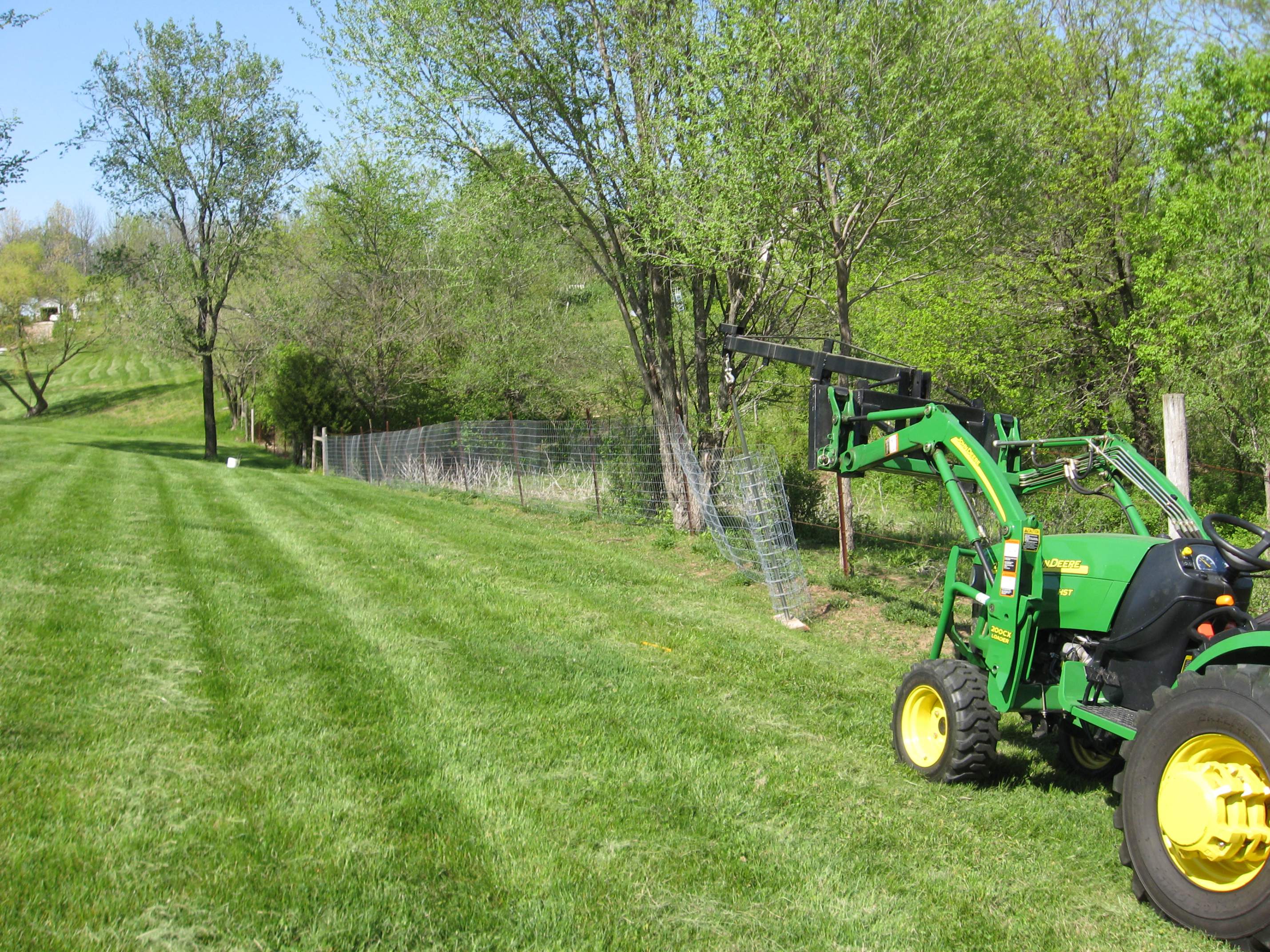

IMG_3345.jpgIMG_3344.jpgIMG_3347.jpgI used a piece of pipe with a chain through it and a 2 x 8 under the fence roll. Suspended it from my boom pole and it worked perfectly for unrolling 600 feet of fence or so. Worked pretty well for zero dollars spent if you happen to have a boom pole.
