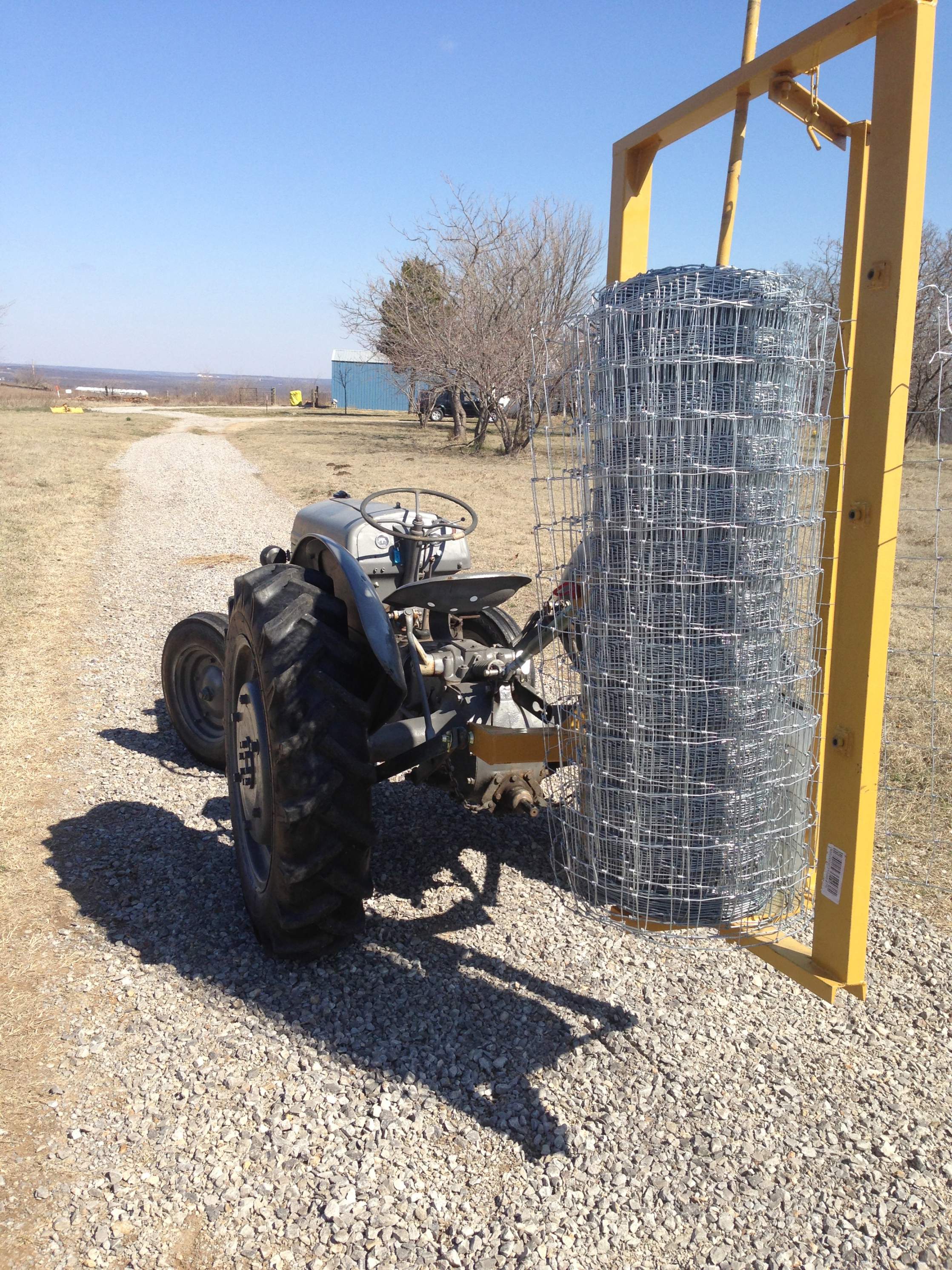

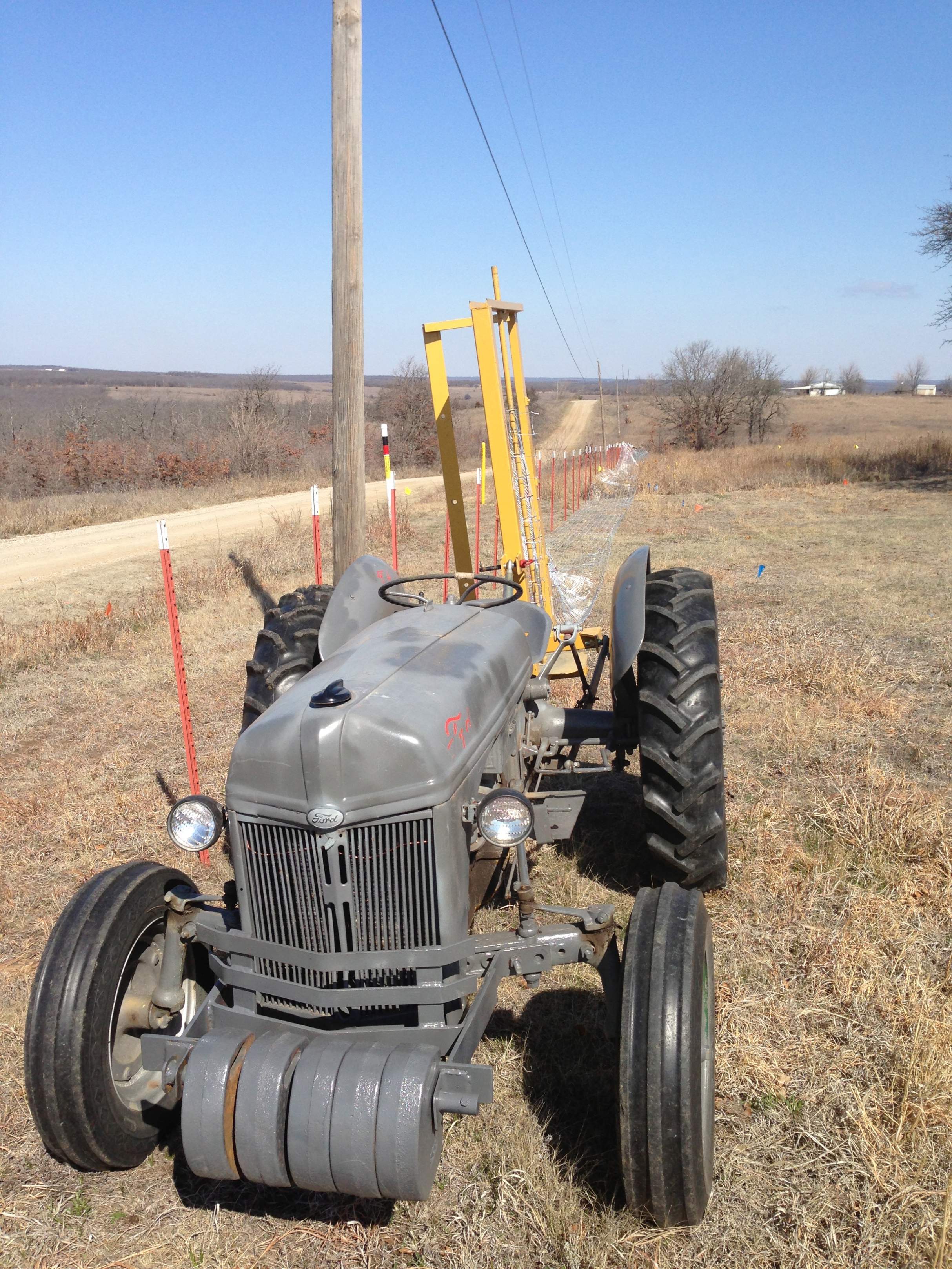

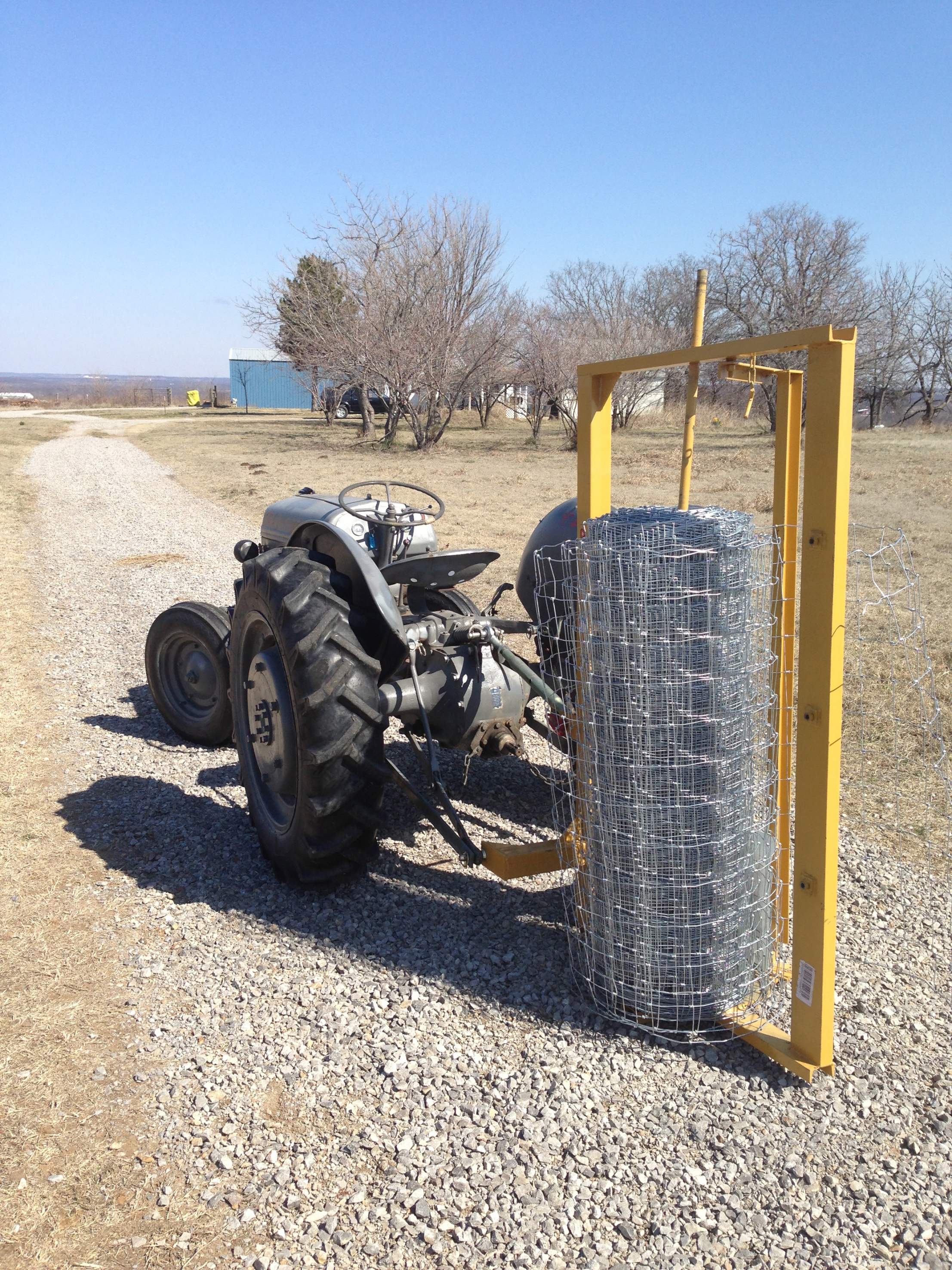

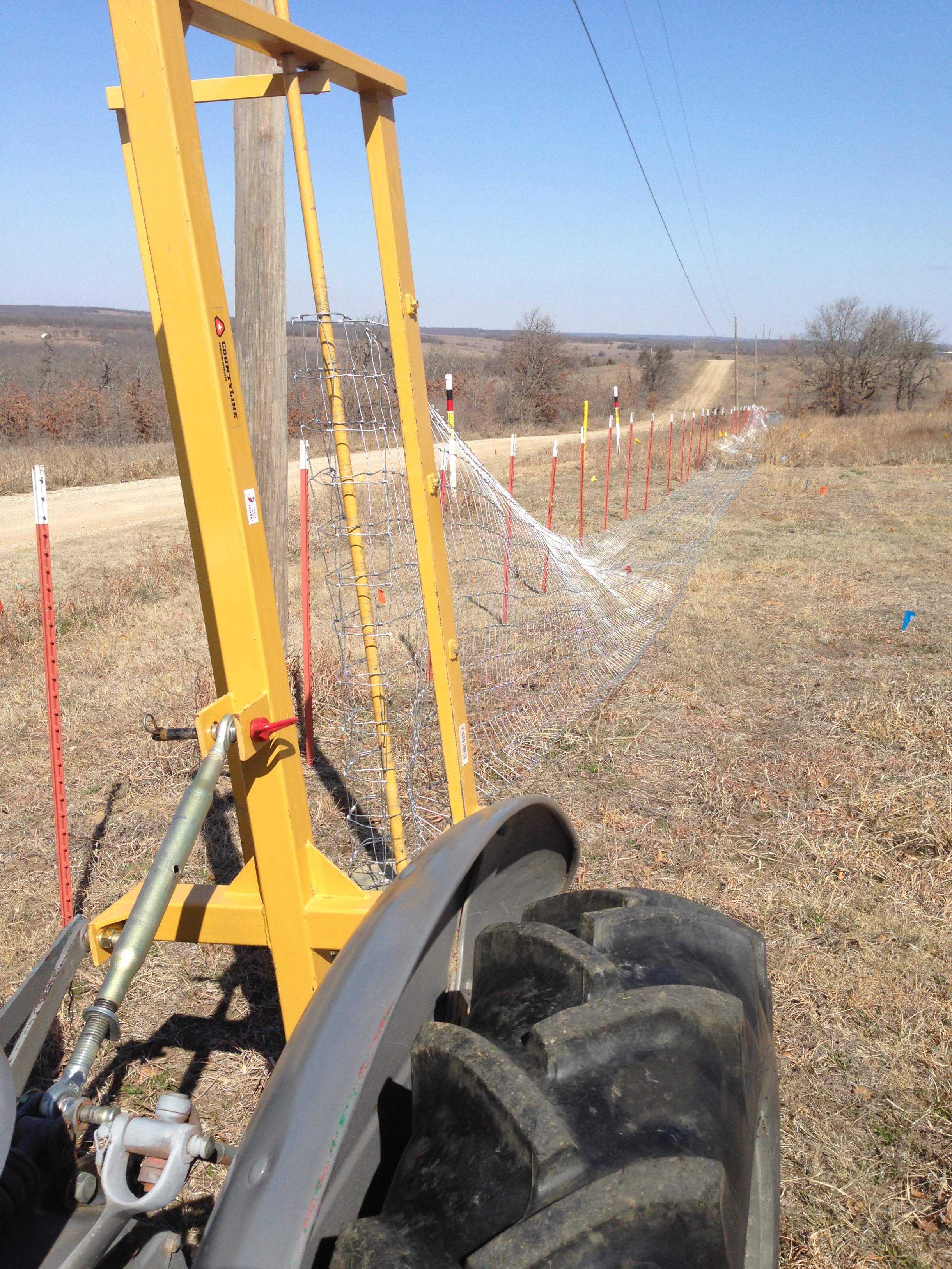

We just used it to unroll 450' of fence and thought to take pictures. This thing is a back saver.
