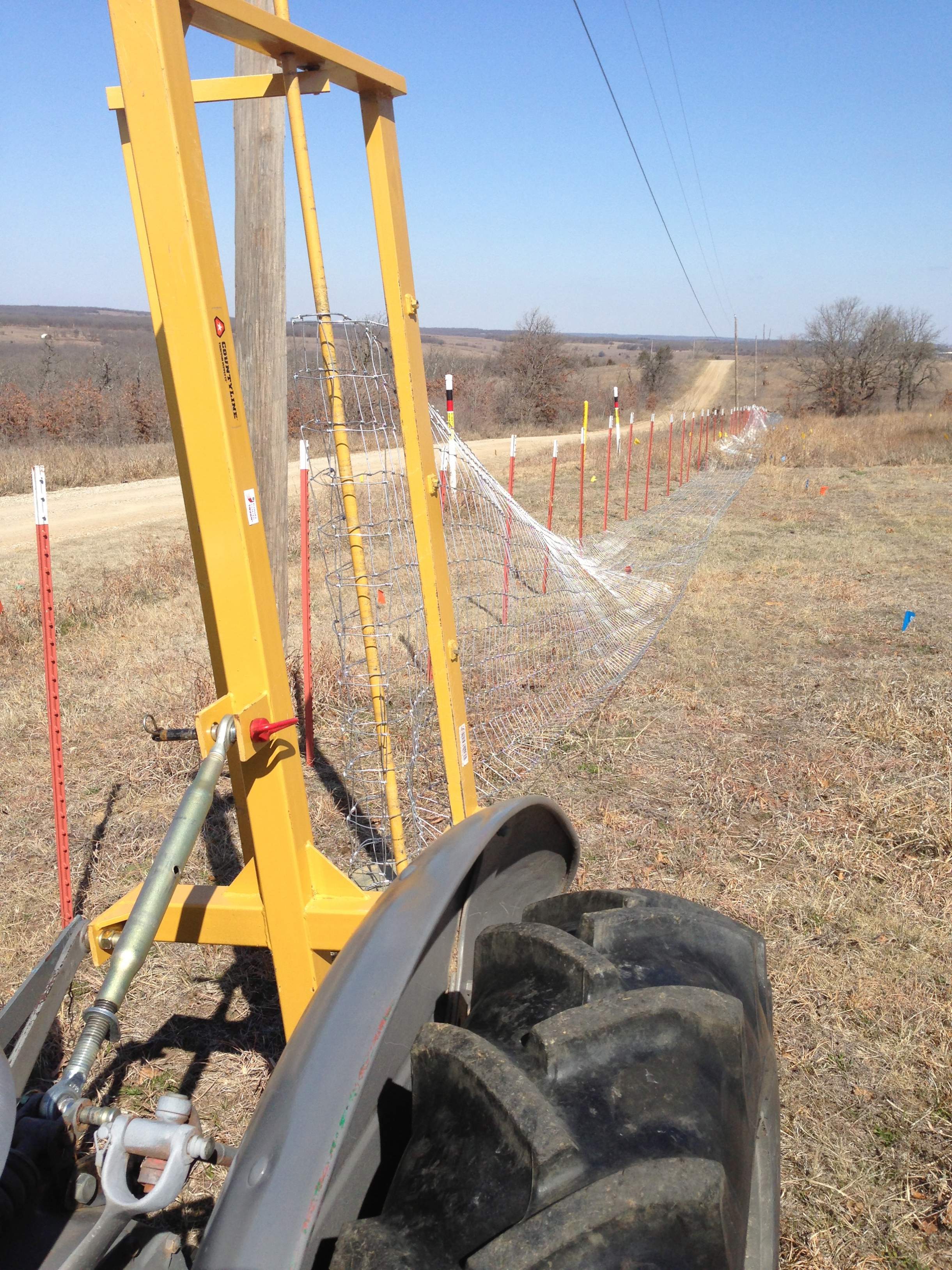

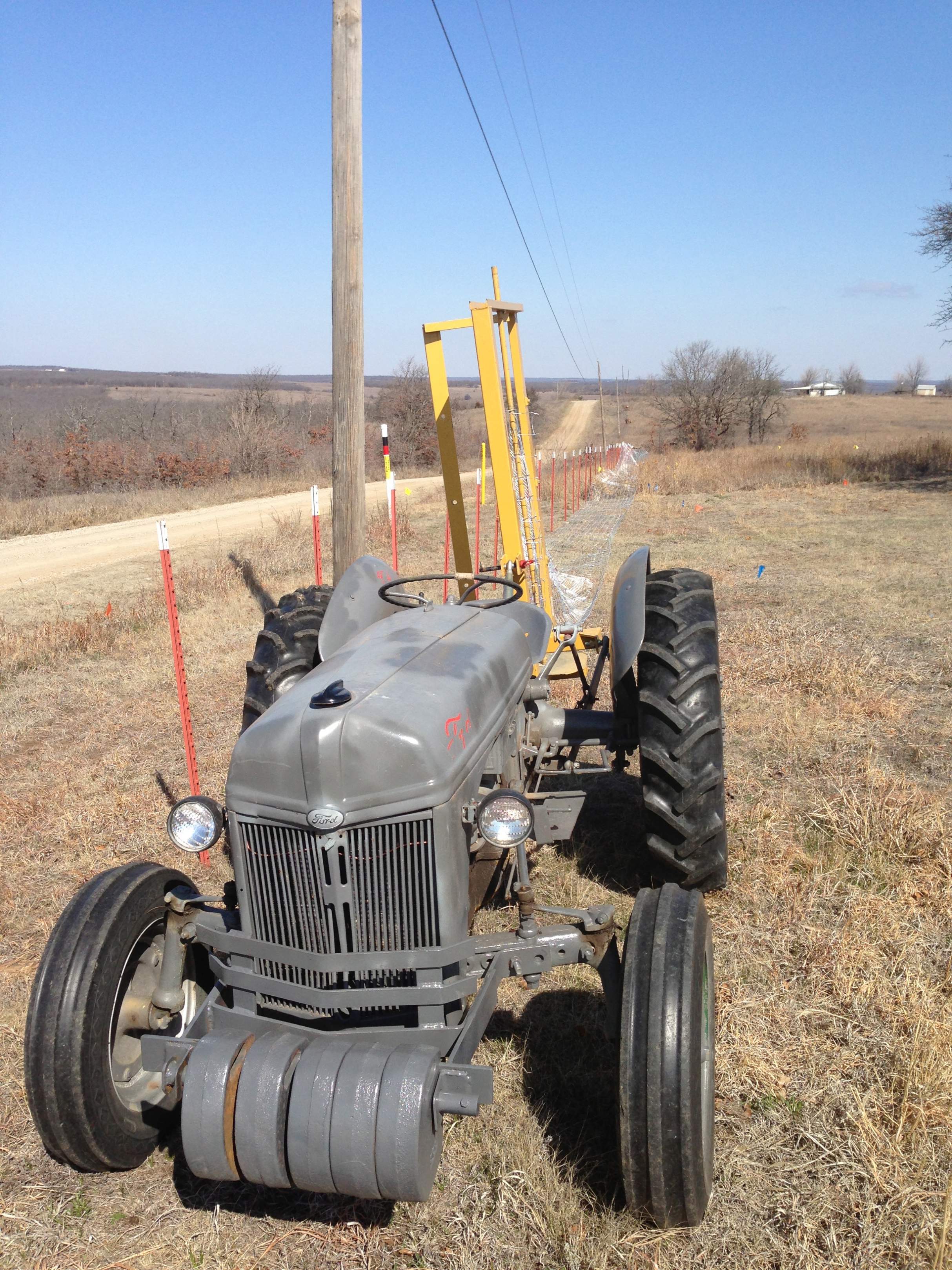

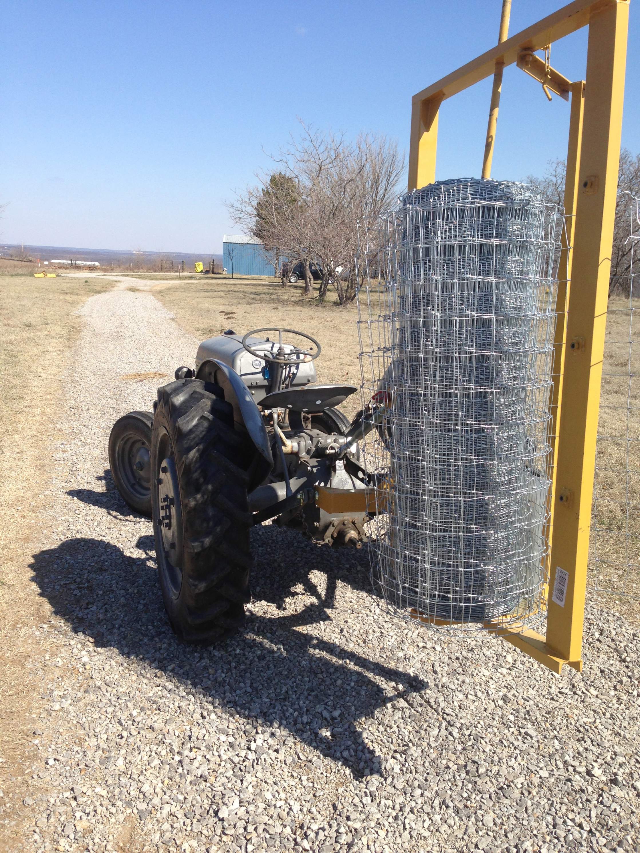

Anyone modify one of these, or build one for putting up an 8 foot game/deer fence ?
   / CountyLine 3pt Fence Stretcher #34
I'm confused how to use this. The Hs are already installed when the fence is stretched (as the fence is stretched from H to H). Are the T-Post installed before or after the fence is stretched? If the T-Post are installed before the fence is stretched, is there a problem of weaving the fence on the inside of the T-Post and the outside of the H? Please forgive me if I'm not imagining this right. Thanks.
   / CountyLine 3pt Fence Stretcher #35
Install H braces, then stretch fence, then install t-posts. Fencing goes outside braces and inside t-posts. That way if the animals push on the fence they can't make the t-post clips pop off.
