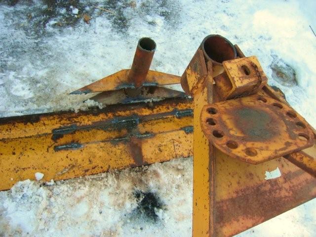

I disected my KK rear blade to find the verticle support twisted like a pretzel. The wall thickness could have been 3/16 but appeared more like 1/8". I replaced this piece with a 3/4" wall pipe and welded it back together. The blade portion appeared to be adequate as the weakest portion caved in first. I bent the verticle mount on a piece of ice while plowing the drive. It was mounted to a D15 Allis without chains.
Now that I'm aware how fragile they are I use it with caution. ( and a 21 hp tractor )
