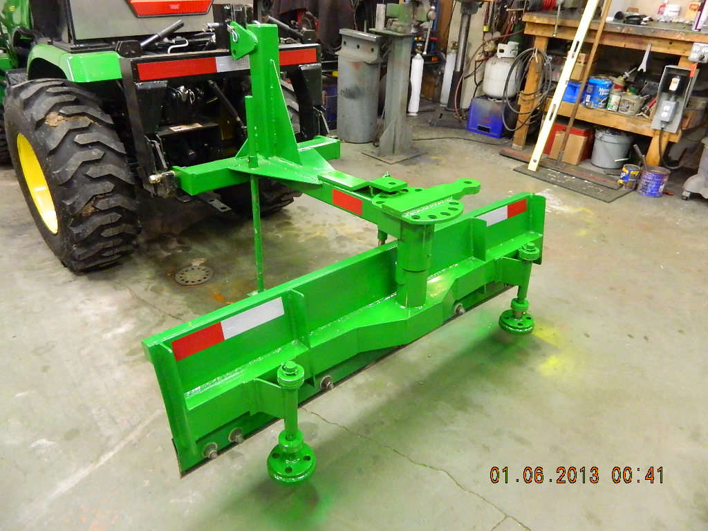

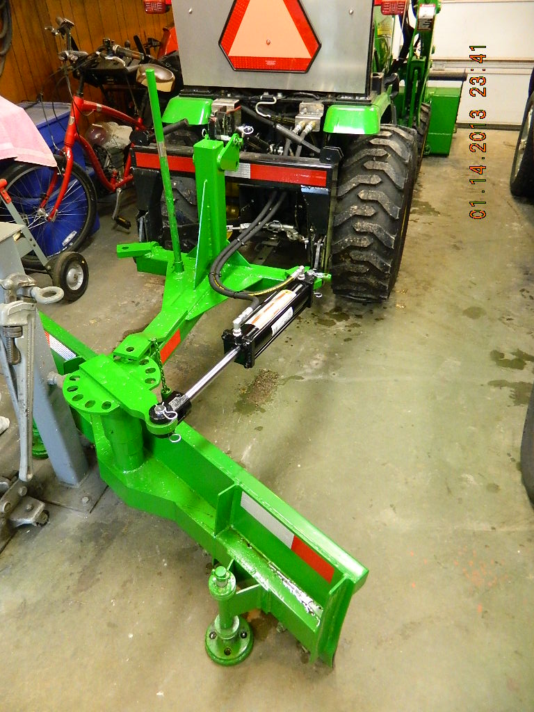

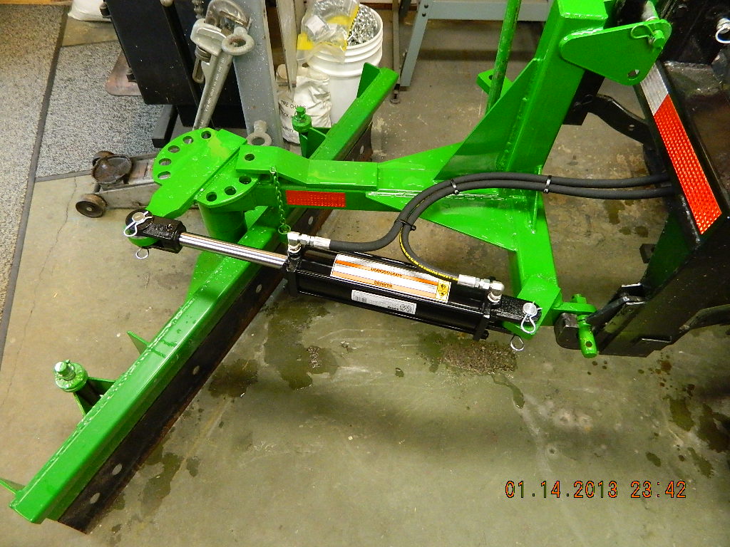

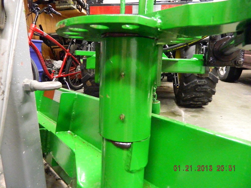

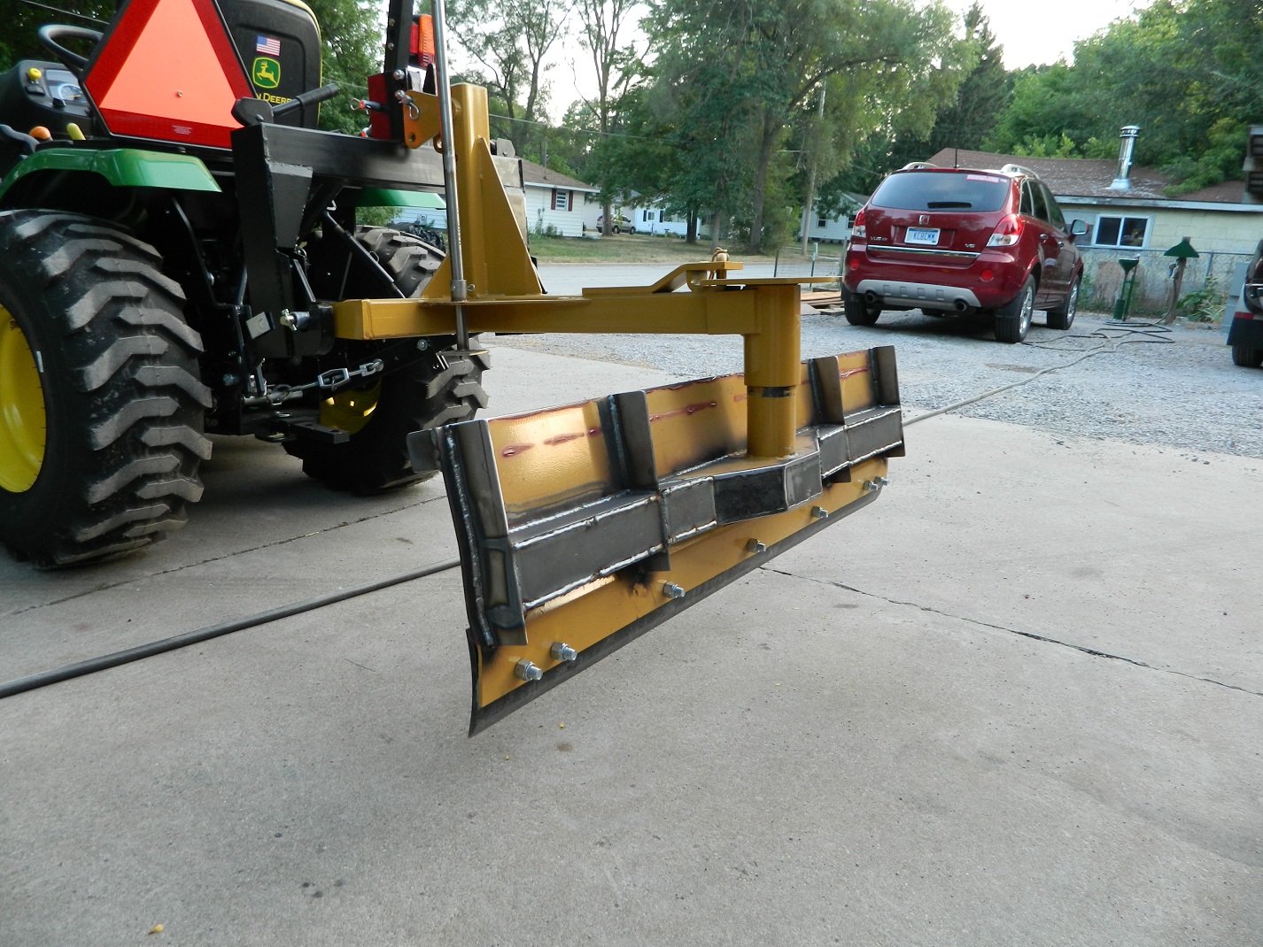

The lower the price usually means lighter weight materials and less strength.
For light work you might be just fine.
I bought the TSC County Line yellow 5' blade knowing I was going to "Beef It Up"
All the new blades at the store had some sort of bend or twist to them.
It was obvious they are not very strong.
I added lots of steel for structural support and the additional weight helped it work better on gravel road/drives. After all my work I spent less than buying a heavier model.
A taller mold board would be nicer for deeper snowfalls
The box blades by design will have more strength.
The box blade may be a better way to go.
