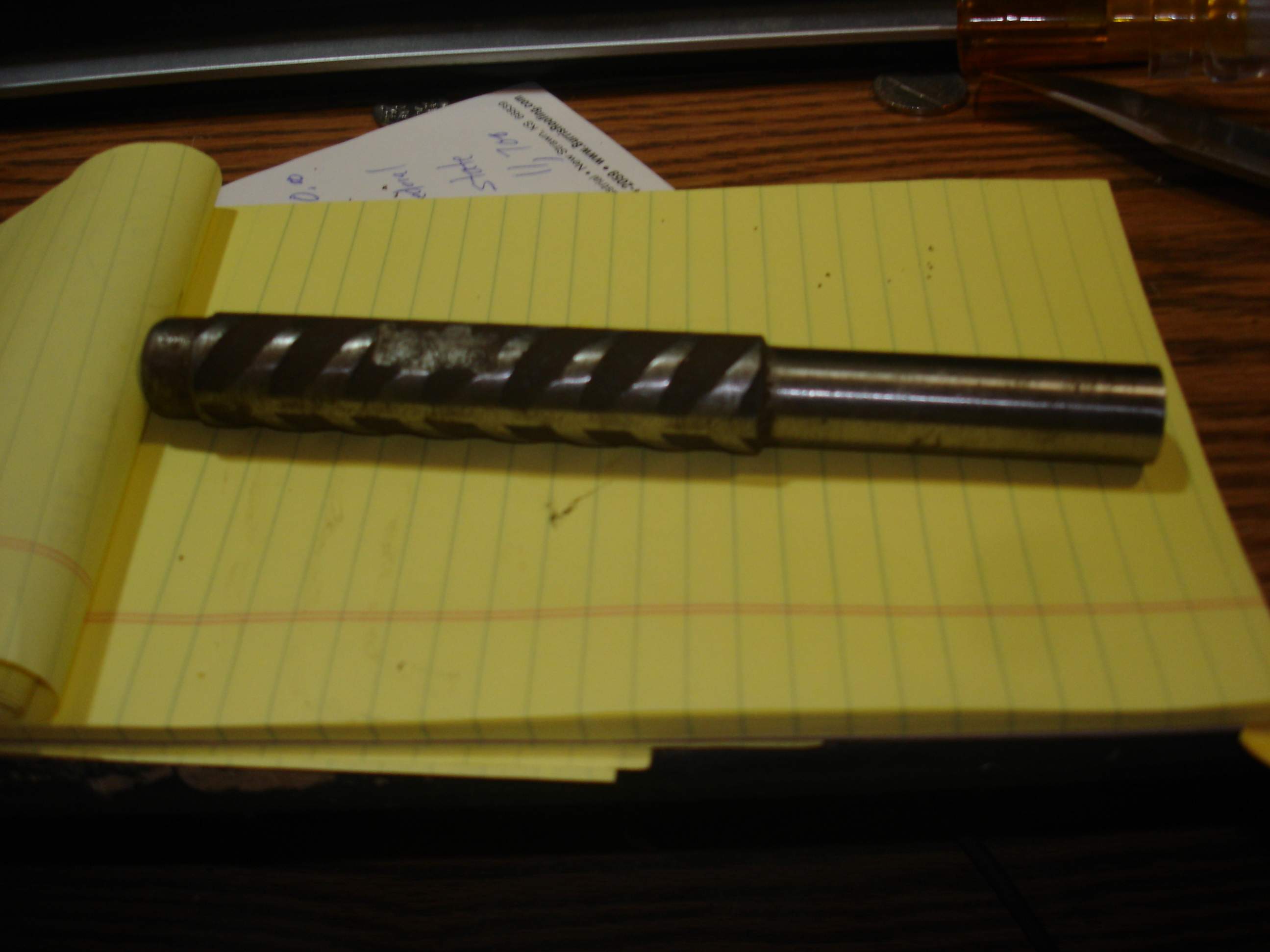

Used to make transfer punchs out of common old concrete rebar. After shaping on a lathe heated the tip to cherry red and quenched in water. Very low tech, but the rebar has enough carbon in it to harden nicely. Hardest part was not getting the very tip to hot and melt. Be sure to direct the flame away from the very tip. Haven't made any new ones for 25 or more years so don't know if todays rebar will still work.

Everybody asks for pictures. This is a 5/8" transfer punch made from rebar as stated in a past post by me in this thread. This one has seen a lot of action and should last forever if it is only smacked hard enough to to make a mark to be enlarged by a regular center punch. There seems to be some question about the rebar that is available today. Transfer punches are pretty inexpensive when purchase from firms like Enco. Didn't trust my photography skills enough to go for a close up of the point.

Jbooth,
You did a really nice job of making that transfer punch. I can't imagine having the time to make a full set that way, but they would sure look really cool.

jbooth, Nice to see that. We made our drifts from rolled steel stock, transfer punches we heated and quenched. Some guys quenched in oil, had to be done outside the building, seemed to work well.
Thanks for showing that bit of work! I have tools Dad made in the 20's they are very special to me.
Richard
   / couple bolts to drill out #18
Thanks Rich Waugh, I built those back when I was still trying to teach myself some things. I checked tonight and a 28 piece set can be had for as little as $9.95 up to $29.95. My wage would be less than $.25 an hr if I made them today. I still have 2 lathes, a mill, and shaper, but don't do much due to fading eyesight and a love for the recliner.
Very nice job Mr. Booth :thumbsup: I like the non-slip handle. :D
