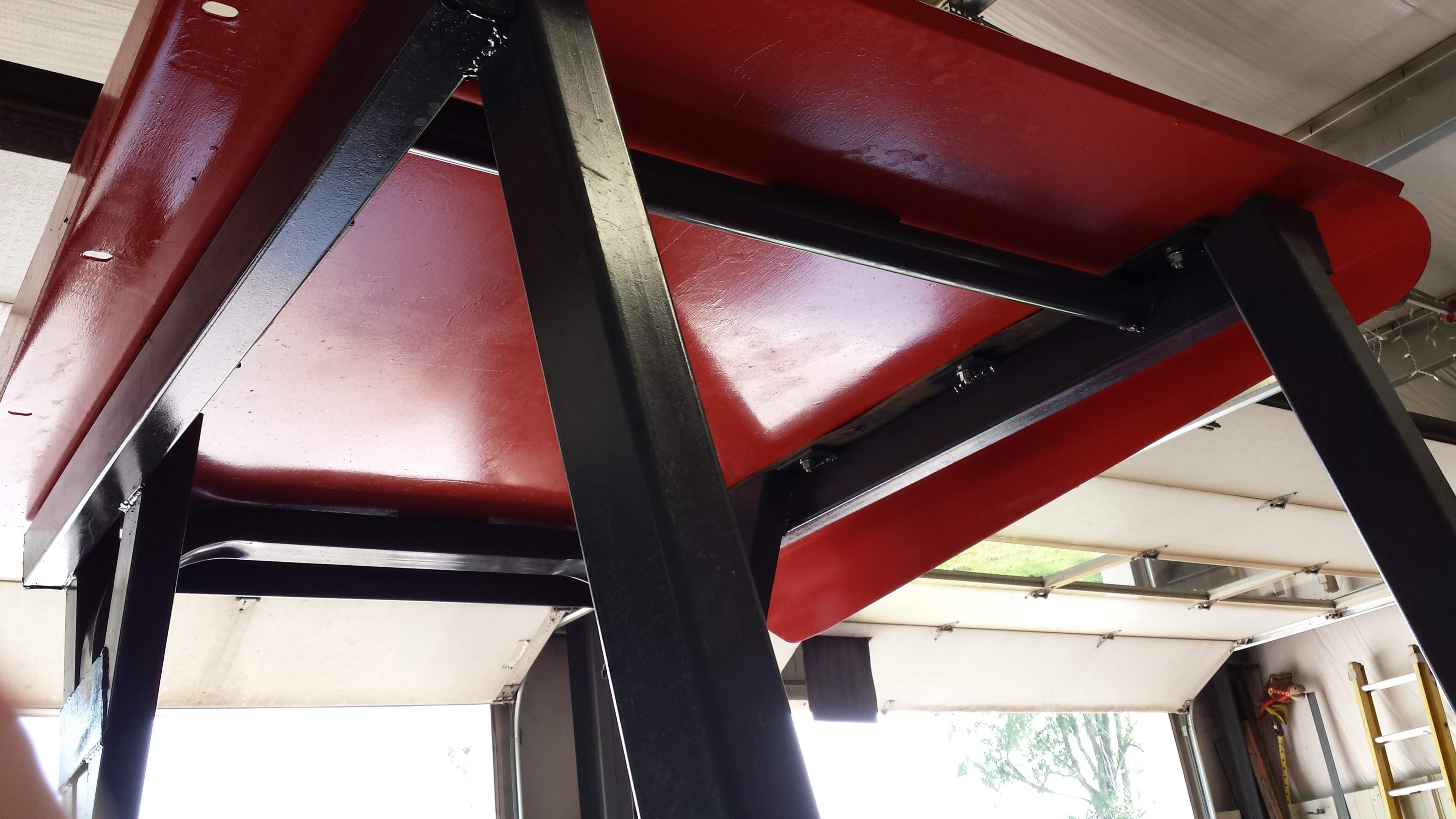

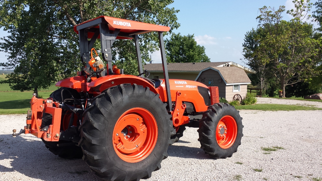

A canopy was mentioned. I modified an old JD backhoe canopy, added two front posts and installed it on the Kubota. I welded tabs to the framework and bolted the canopy on. The reverberating sound was almost unbearable. I took it back off and added a rubber belting strip between the frame and the canopy. Life was good then. You might not have that problem with just a canopy suspended from the ROPS though.
