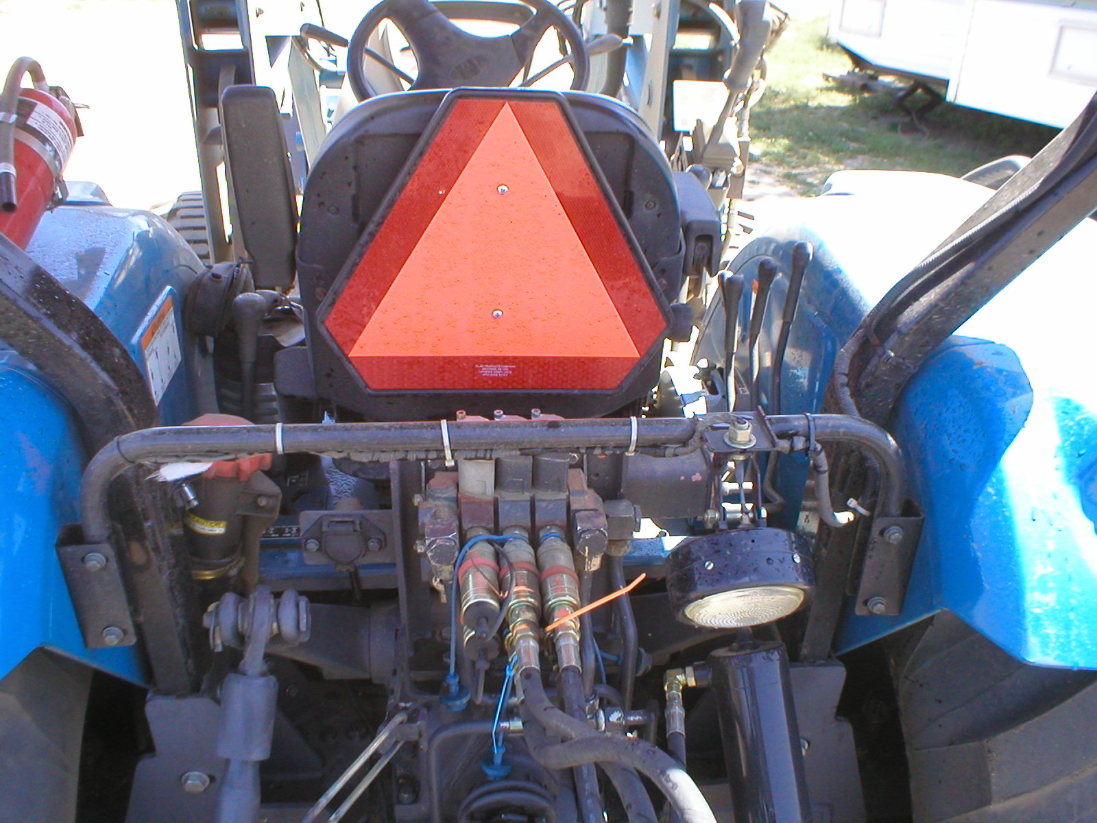

No break-away kit. My point was MY couplers do not have sleeves. You simply pull on the hose and they disconnect. (Actually, I prefer to pull on the male end so I am not pulling on the hose, however I said 'hose' to illustrate there is no sleeve to mess with.) Here is a pic of my rear remotes:

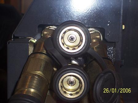

Here is a pic of mine, no collars either. The fittings are fastened directly to the valves, there is no bracket what so ever. You need to zoom in to get a better look.

Are you saying that to unplug, you pull the male coupling out. What keeps it locked in place? Is there a sleeve under the rubber part, or a release mechanism? What brand are they?
Do you have to push in first and then pull?

Mine are what come OEM for Mahindra QDs. I have to push first and then pull to disconnect mine. However mine work, it is all internal.

Yup, just pull on the male coupler. No push-first... just pull. It was new to me when I bought my tractor. I stared at it for an hour before I got on the net an did a search. Apparently they are fairly common. No sleeve under the rubber. That rubber you see is only the protective cover. I can pull that rubber off and there is only a groove where the rubber seats.
Mine say Parker on them. I can get the part number if you want. They accept the ag standard (ISO 5675 male couplers).
They snap into place, but they must lock somehow when fluid flows. When under operation, you can't pull them out.... however there is not a "pressure buildup issue" like the skid-steer couplers. (I guess there could be that issue since they lock under pressure, but my HTL has never caused that problem.)
There is a set of balls that snap into the detent of the male coupler. I think something internally locks the balls when fluid is flowing. I'm envisioning some sort of internal, fluid flow activated, collar/ring.
I do have a set of standard skid-steer couplers on my FEL remotes. Those of course have a collar.
