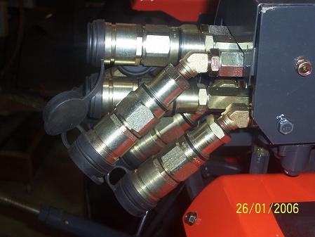

I called Parker and found out some data about those couplers. It seems that they were a propriety coupler to mate up with Pioneer 8010 coupler, and made for Kubota. They say they were used until 09. The cost on those couplers are $78.00 ea.
The Parker guy said you could not find them on the Internet. Theye are listed in his parts book.

I have a 2010 Kubota -- build date somewhere around May 2010 (I don't remember exactly). I have those fittings.
If Kubota isn't using them any longer, I'm sure they are just installing them until there stock is empty. I'll have to check on my dealers lot.
Because they are not found on the net, it was really confusing searching for the correct male fitting. It turns out they accept the Ag standard male fitting, however the female fitting on the tractor doesn't look like anything found on the net in regards to that standard. It was not obvious that they accepted Ag standard males.
As far as those fittings... I like them. They are easy to clean and don't have a collar to get gummed up.
I understand they can get pulled apart, however thay may not be a real problem since they are in the back. Who knows... I certainly don't have enough seat time to know.

I have six rear remotes on my L4330 and another on the FEL off a Long 3rd function valve. Three of the rears are "Kubota" and they are "push-pull" ...push on to connect, pull to disconnect and they are great. The other three rears and the FEL auxiliary were slip-collar and a tremendous pain to connect (although they, too, were "tear-away"-pull to disconnect).
I changed out the 4 sets of slip collar and installed the push-pull. Becuse of their placement, you needed two small hands and one large one to connect the rears. To the OP: why would you want to go back to the slip-collar variant? Much less convenient, IMHO. Your dealer's mistake was your good fortune.
