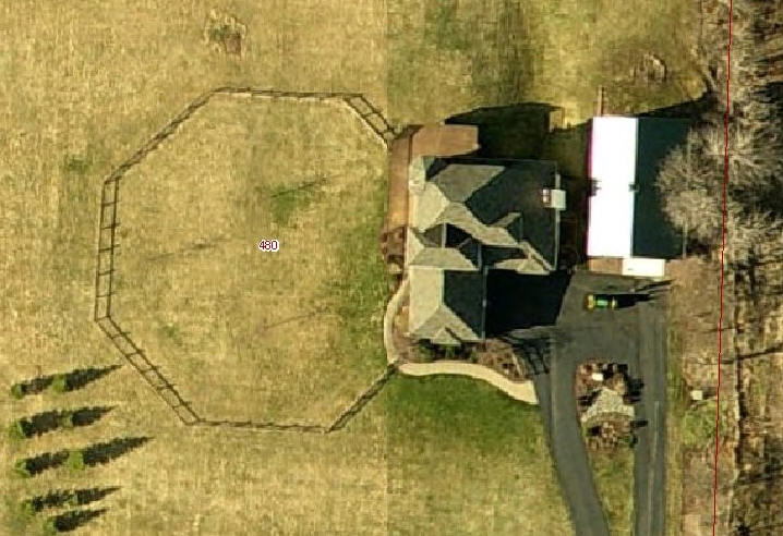

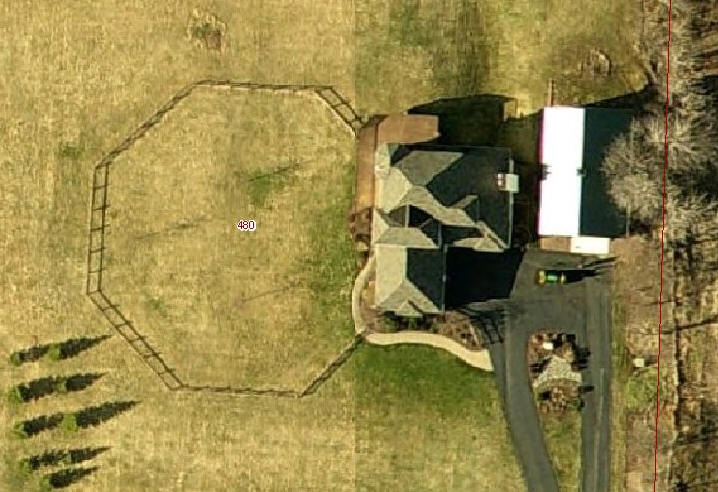

We rented a 3 point post hole digger when we put in our fence a few years ago. Worked great and didn't cost very much.
Good luck!
