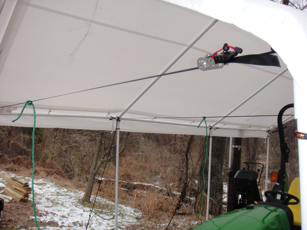

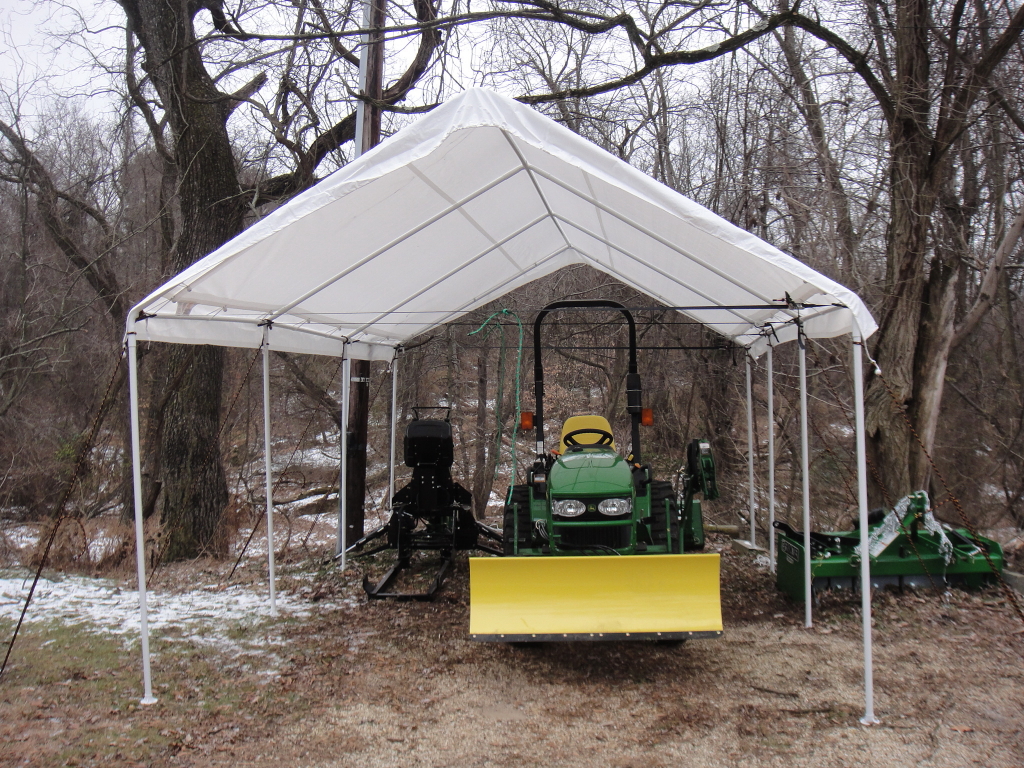

I am going to try to keep the snow from getting too heavy on the canopy and I also came up with this idea to reinforce the roof span by effectively turning the span into a truss with some ratchet straps. I hung some reminder rope in my line of sight so I don't drive out without removing them. The current forecast is for 3" to 8" today and into tomorrow.

Good luck, ours was open to the winds and didn't make it more than a couple of months, snow is not a problem here.

How hard is it to drop your ROPS?
The straps are a good idea.

The tractor is new, so I first tried to drop the ROPS, but the pins are very stiff and the hinge seems stiff too. I think I need to ream the holes with a drill bit and maybe lube the pivot, but that can wait until the spring. I can't wait to get a permanent garage built.
