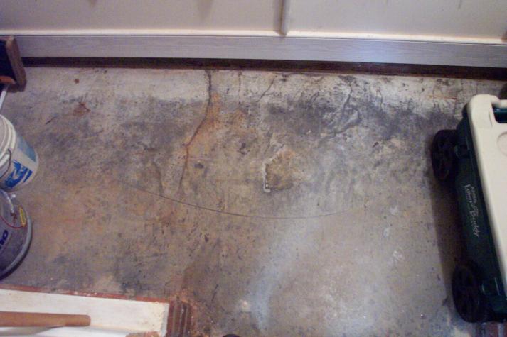

Just went thru this operation. Concrete crew did a really poor job on my garage floor, bad finish, sprayed sealer and puddled it up, mix in some red clay because folks got on it too soon, you get the idea. Made me mumble every time I looked at it.
Sanded it down to bare concrete to get the sealer off and flatten it out, patched the cracks by filling with epoxy 5 passes and then latex 5 passes to build it up level. Sanded cracks flush and 3 coats of Valspar premium epoxy, 6 gallons at about $35/ gal on 600 sf.

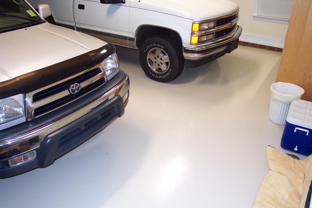

How about some pictures.
Thanks again for the info.

Stepped out and took a shot...not real good but you'll get the idea.

Here's a utility closet I didn't paint. The garage floor looked kinda like this, only a LOT worse.
