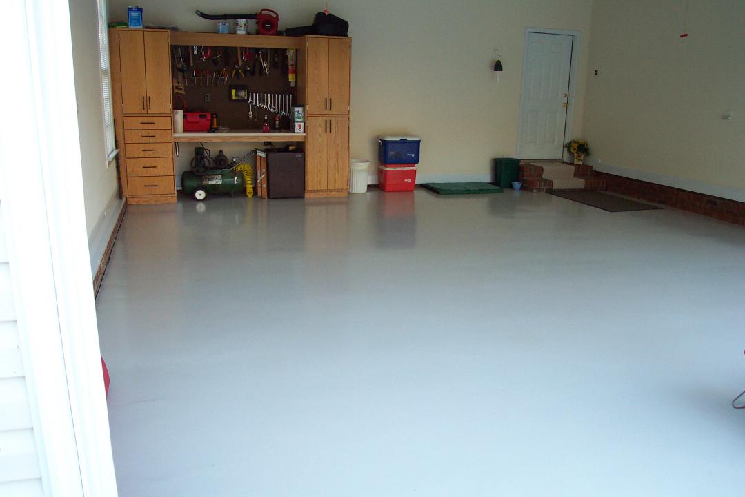

If I had a new one I would Epoxy it immediately. Like everything else its a matter of choice and taste. I sure would like to be able to wipe up oil spills instead of haveing every little drop stain the floor. I cleaned mine this weekend with a product from Home Depot. I think it had acid in it. I found it in a gallon jug in the cleaning supplies. $9 a gallon. It actually worked. Dave
   / covering garage floor #22
</font><font color="blue" class="small">( WOW ! I'm green with envey /forums/images/graemlins/grin.gif )</font>
Thanks Dave. Considering the crap I started with, it ain't half bad now. BTW I'm sure I turned several colors while sanding and prepping, but green definately was not one of them /forums/images/graemlins/grin.gif
BrettW, I remember the directions on the product saying a new floor must cure for 90 days before application of epoxy. I'd keep my options open and not apply sealer immediately. If you get a good finish job with a nice gray tone, then by all means spray it and forget it if you desire.
Next summer's project is to mirror the garage at the opposite side of the pad shown in the previous picture. I'll epoxy that too unless this shows me a reason not to. I've found my old stuff looks a lot better on a shiney floor! /forums/images/graemlins/grin.gif /forums/images/graemlins/grin.gif

One more.....sorry, I just can't help it /forums/images/graemlins/laugh.gif

I'm building a new shop with a concrete floor. I'm going to use an Industrial epoxy system from Sherwin-Williams. I had the concrete finished to a smooth finish which I will sand with a 80 grit paper using a floor finishing pad type sander. This is the way Sherwin-Williams reccomended to prep. There are some do's and don'ts about finishing the concrete and I would recommend that you talk with which ever company whose product you are going to use prior to placing concrete if possible.

So, does anyone have know how the salt from the roads will affect the painted floor?
