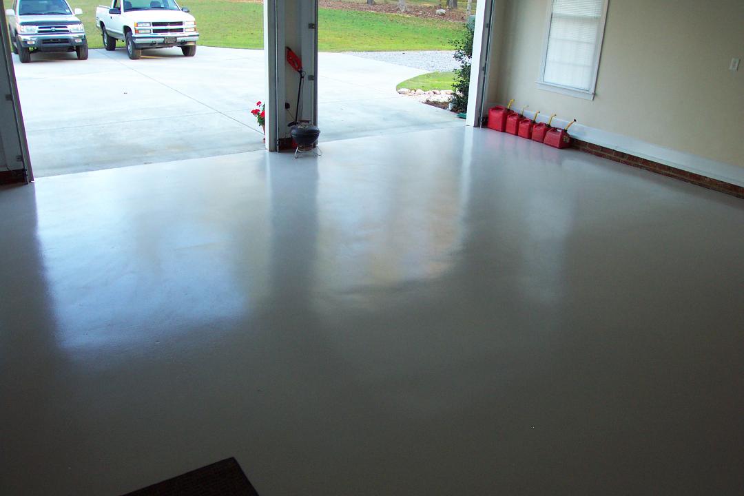

That looks very nice. How slick is it when wet and you walk on it?
   / covering garage floor #13
</font><font color="blue" class="small">( That looks very nice. How slick is it when wet and you walk on it? )</font>
Really not too bad. I used a premium grade 3/8" nap roller and always re-rolled behind me after about a minute to add some texture. I think the multiple coats helped.
I can say for absolutely sure it isn't as slick as the original sealed concrete was when wet. Several times I came running in during a storm with wet feet and did my impression of a goose landing landing on water when I tried to stop.

</font><font color="blue" class="small">( How about some pictures.
Thanks again for the info.
)</font>
Everything was outside today, so took this better .
There was a crack running all the way across, chipped off big enough to lay your finger in in places.
Hope it stays like this /forums/images/graemlins/tongue.gif

WOW ! I'm green with envey /forums/images/graemlins/grin.gif I sure wish my garage floor looked like that. Its been on my honey do list for seven years /forums/images/graemlins/crazy.gif Dave
   / covering garage floor #19
Darn I would not want to walk on it as I may leave a
foot print
Doug /forums/images/graemlins/smile.gif
