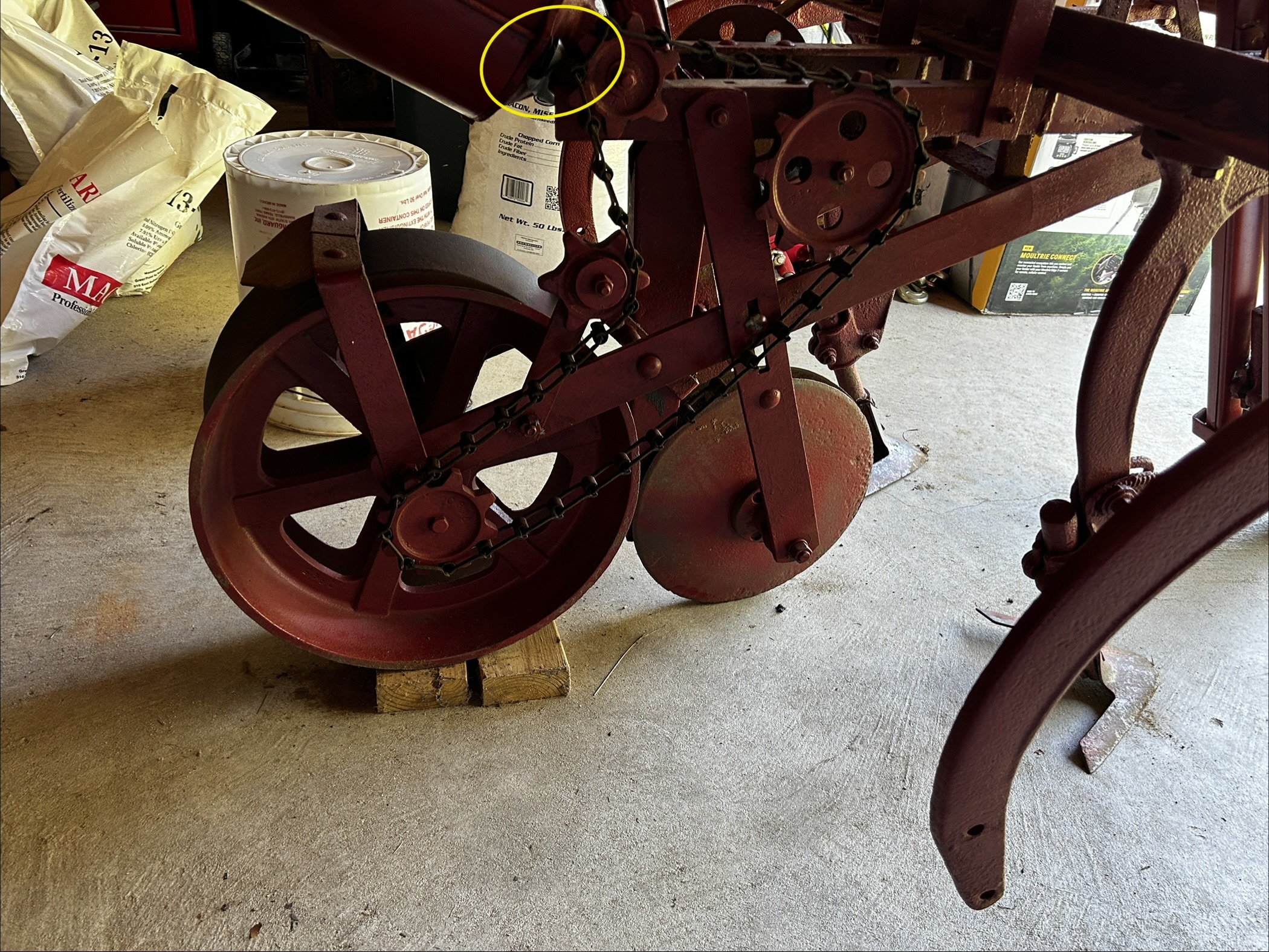

Had a little time this afternoon to experiment with planter a little. Couldn’t find a way to adjust the “tilt” of the seed box. Was able to fold some tape and place between seed box and frame to stand it off to increase tilt. That seemed to help with the seeds picking up and dropping into seed tube. Here is location of tape. IMG_9015.jpeg

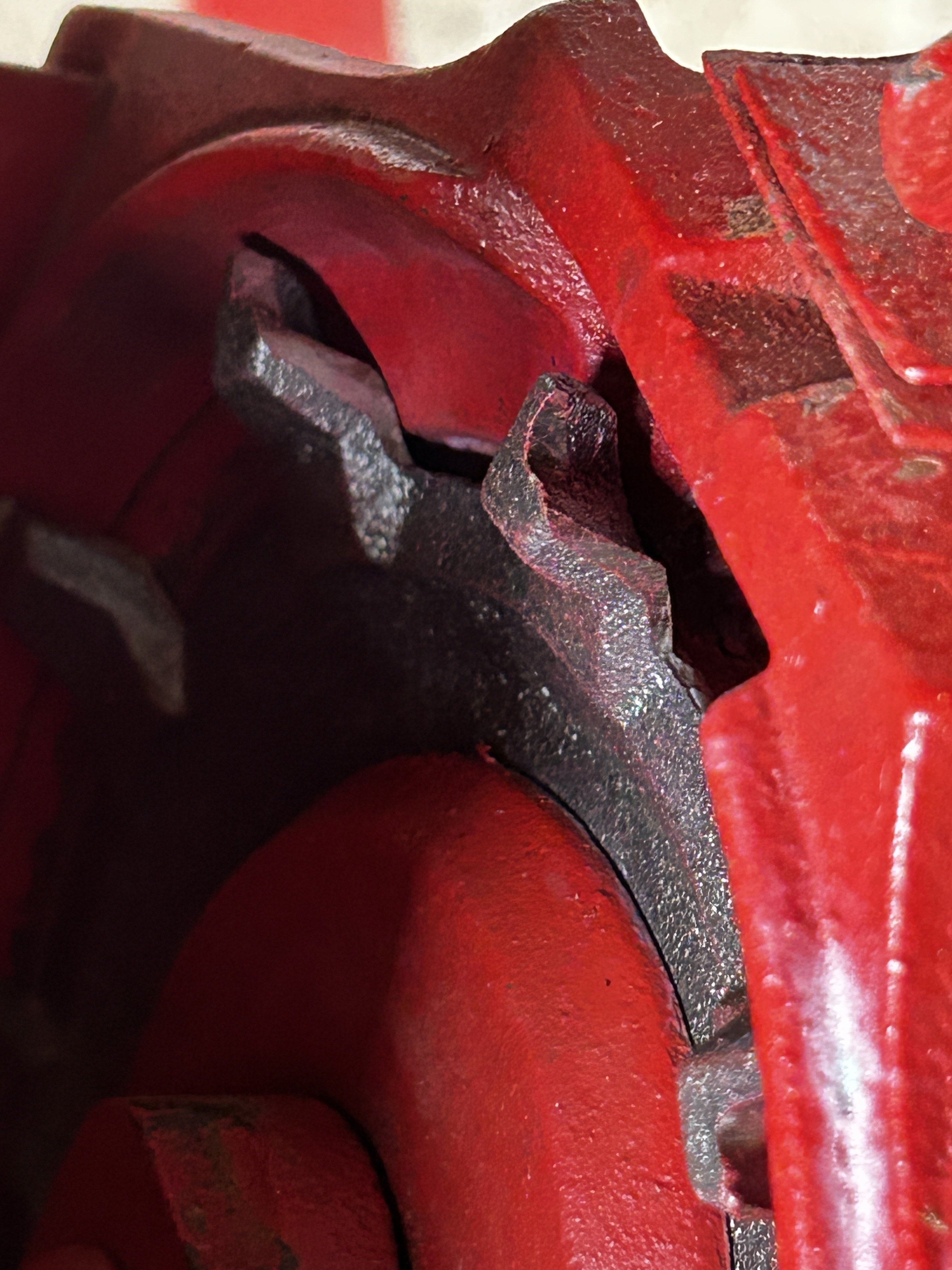

Seed is occasionally binding between tooth of seed plate and edge of opening to seed tube.
What can be done to remedy that? That is about the only thing left that gives issue. Think can put a strap across seed box to keep it from flipping up, but if seed doesn’t pop out planter will just slide press wheel.
Would like a better permanent fix to adjust angle of seed box than the tape, but it did prove adjusting the angle helped with the seed feeding. Maybe if I angle it up even more the seed will roll into the opening and prevent the binding and flipping.

Is that a used plate..?? Something isn't looking right about that particular cell/tooth. That one seems to have a bottom to it, and hardly any ear to pick the seed up, although it is. Looks to me if you grind that bottom part off it would let the seed drop instead of carry it across and jam.
Not sure if those plates are cast iron, or cast steel, but if you could build that ear up a little with weld, then take a grinder and fashion a closer to proper ear it'd work much better.
If that plate was bought used for a decent price, that may be the reason. Could have been a bad casting that someone in quality control didn't catch. I'd be tempted to grind the bottom portion off so the seed can drop. Whether you have a welder or know someone who does to build that ear up may not be as important, but I'd sure try it.
/ Covington Planter

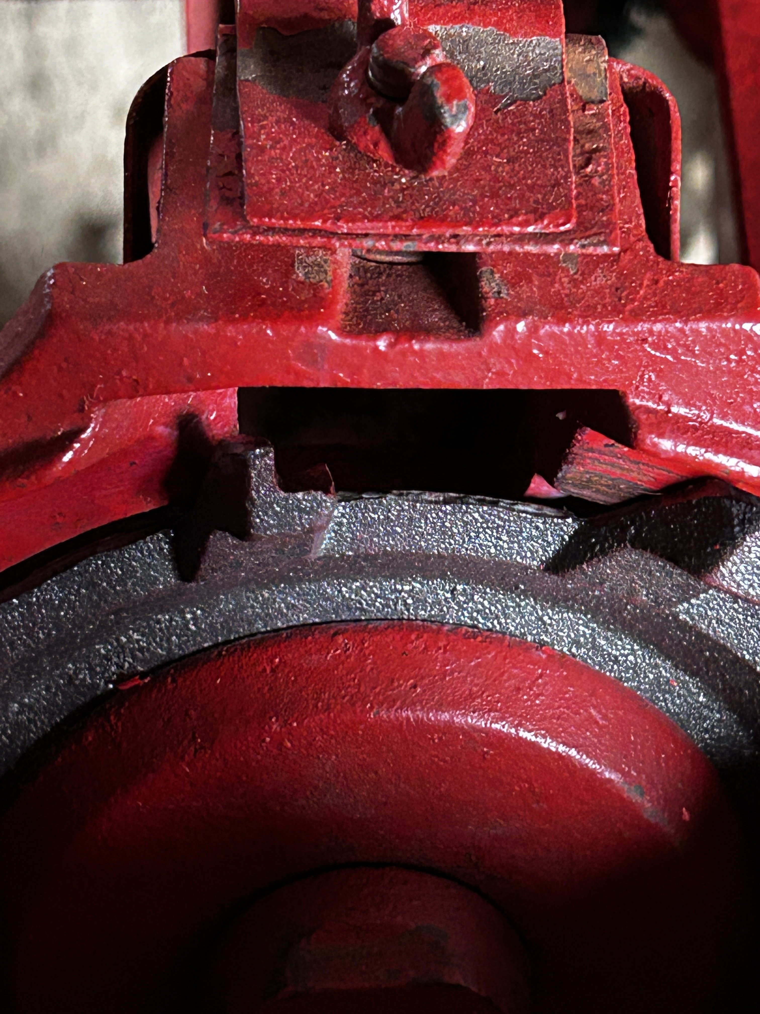

Plate was bought new last year specifically for sweet corn. Here are some closer pics.
I will have to dig out my other plates and compare.

Those cells look OK but the one in the picture that caught the kernel of corn just doesn't look right. Maybe it's an optical illusion.

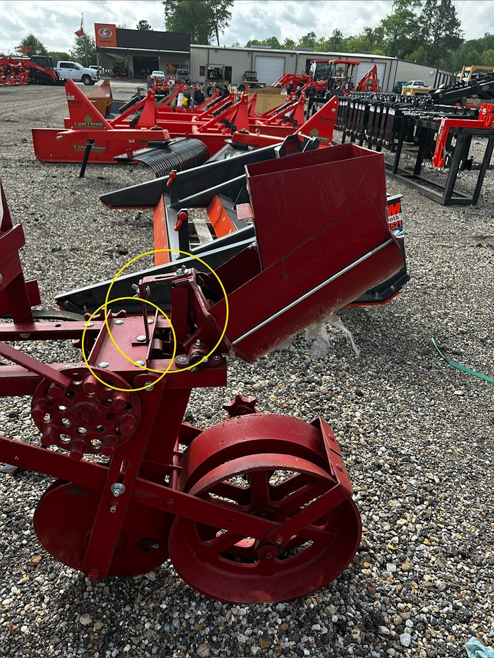

Believe I have found the problem and likely solution.
See yellow circled areas in attached picture of new planter on yard at local dealership. On my planter I am missing these rigid brackets and the plate that mounts to the frame. This bracket pulls the seed box forward at a much steeper angle which should better allow the seeds to fall into the seed tube and it appears to be rigid enough that it should prevent the seed box from flipping up.
Now to find these parts and see if the theory is correct.

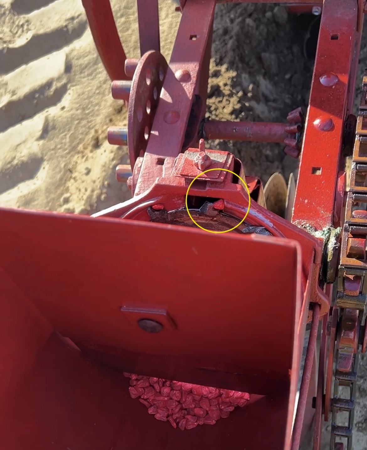

Parts located and installed. Thankful to find resources for parts for a design that seems to remain mostly unchanged over the years. Adding the brackets definitely tilts the seed box forward more and has the seeds resting better on the seed plate and in better position to fall into the seed tube when they reach the opening. Video is with tractor running a little faster than normal may be causing some of the seeds to fall off. Noticed at times it picked up multiple seeds with some falling off and one still going in seed tube. No more planting until next year, but believe this will resolve the issue I had. Here is link to video of it operating,
