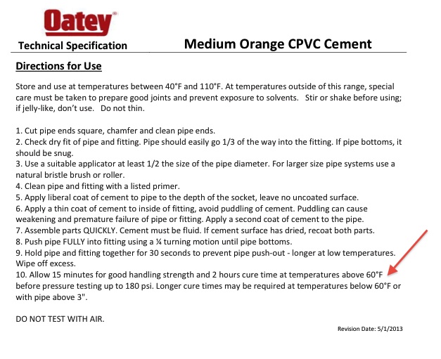

I worked with CPVC for a lot of years but don't ever recall how long to let the joint dry or set up before putting full water pressure to it. Is it just a guess? I heard 24 hours but most of the time that will never work. Any expert advise on that one??
   / cpvc plumbing #70
I usually find my expert advice on the can label. :)
But here is an example:
