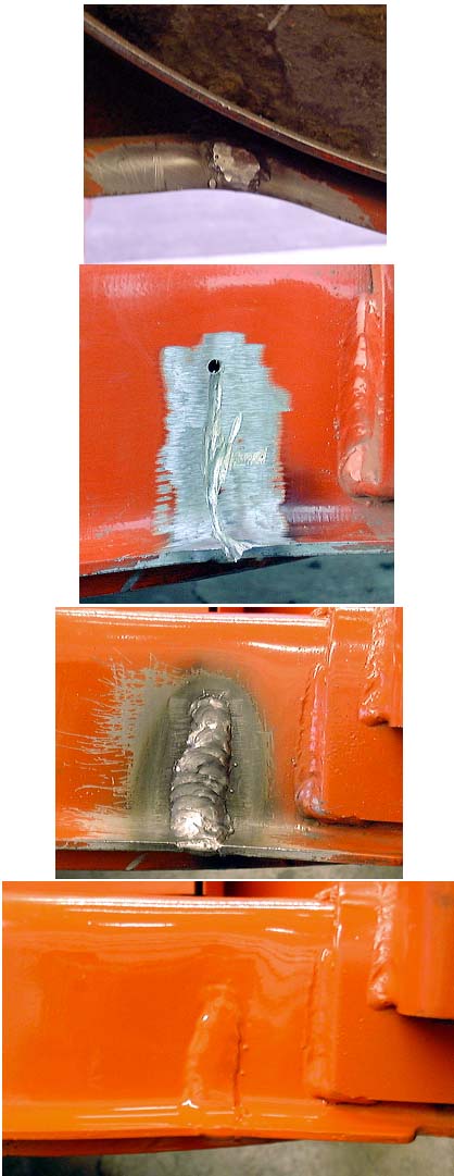

This is mild steel,he ain't building a nuc plant here.If he grinds above the crack an inch or so,and gets a full pen weld and makes a nice weld,you don't need no patch,once you make that area one piece of metal again,minus the crack its as good as new,in this case better,you don't need to anneal mild steel,man! RICHARD GAUTHIER

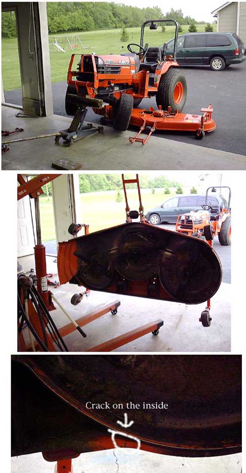

Well here are the photos that go along with the repair! First one shows the deck coming off of the tractor. Was too lazy to put the loader on for this, so I used the floor jack. /forums/images/graemlins/cool.gif
Next one is of the deck hanging from the cherry picker. /forums/images/graemlins/cool.gif
and the third one is a close-up of the crack from the bottom. I was hoping to be able to do all the welding on the inside, but as you can see the deck baffle is in the way. Oh well so it won't look so pretty on the out side. Have to keep telling myself "its just a tractor, its just a tractor, its just a tractor" /forums/images/graemlins/frown.gif I guess I get that from working on Porsche's for so long!

Here are the rest of the photos!
First one shows the crack on the inside after welding as much as I could.
The second one is the crack on the outside before welding with the hole drilled to stop the crack from growing, and a slight V ground into the crack.
The next one is after the welding. I put it on quite hot and thick, as I don't want to do this again! /forums/images/graemlins/tongue.gif
And the last is after the paint job....So It won't look too bad, /forums/images/graemlins/crazy.gif
I know, I know....... "It's only a tractor" /forums/images/graemlins/smirk.gif
