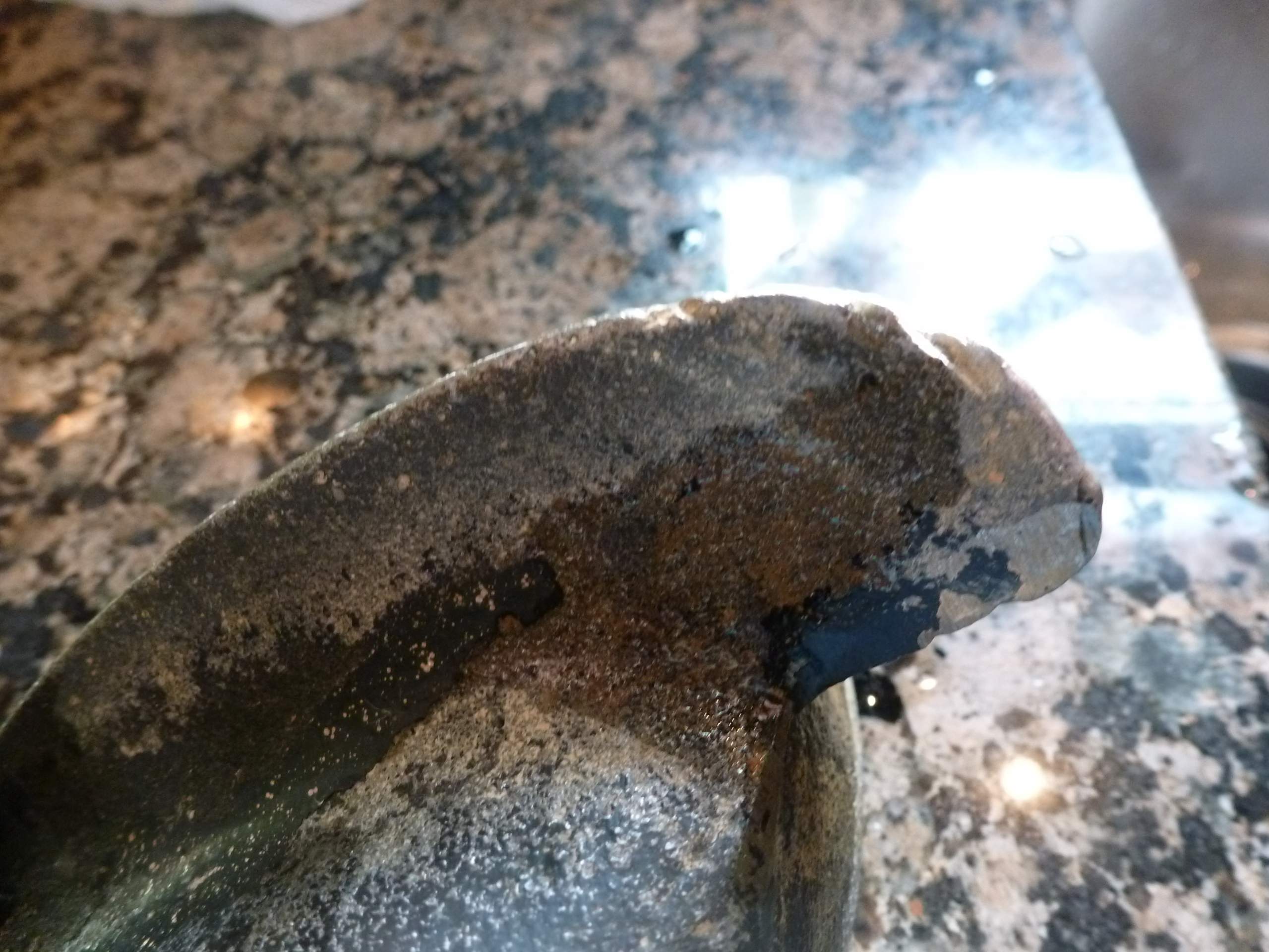

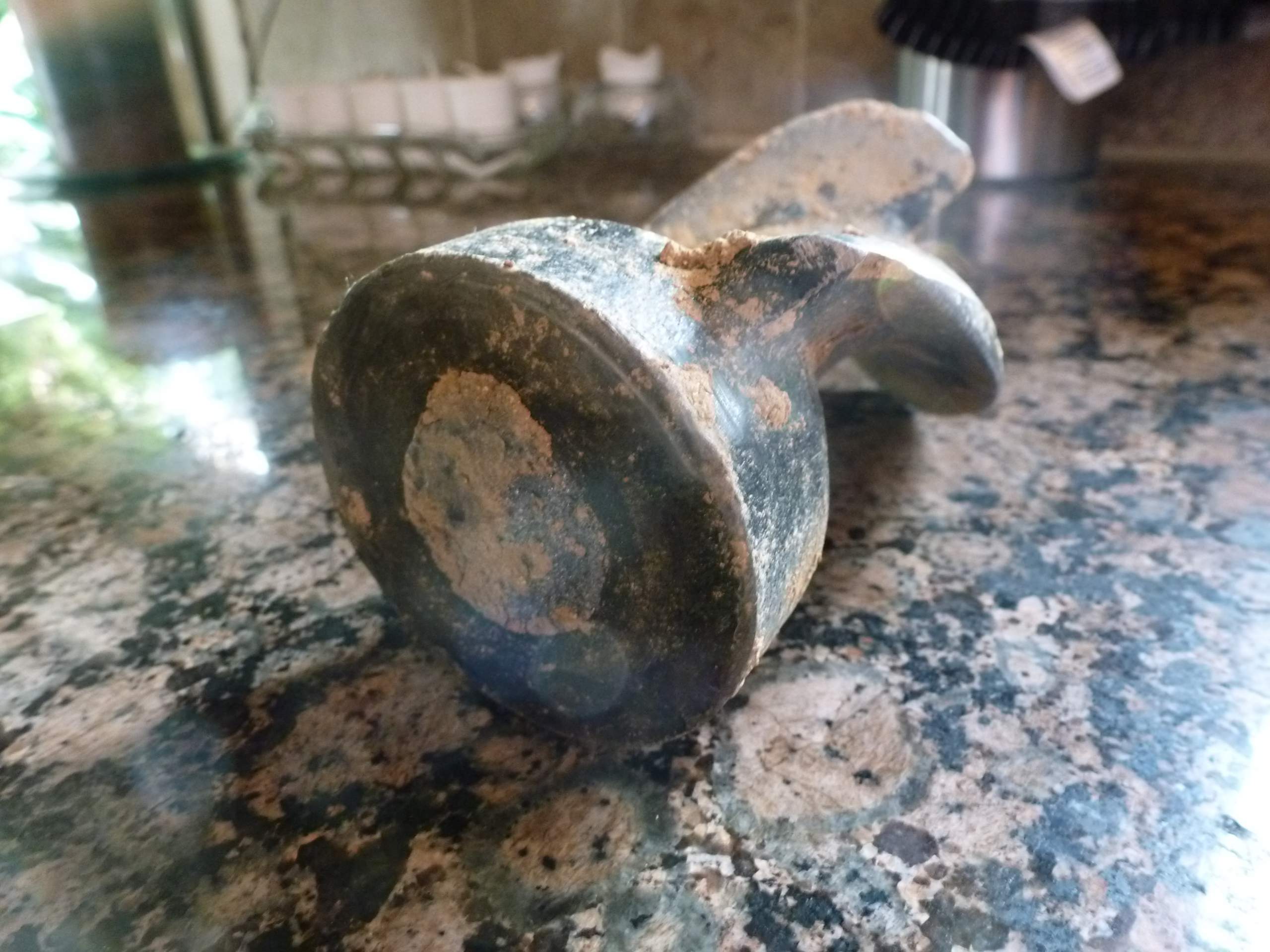

Brand new small Land Pride PD10, digging holes for fenceposts to put in a new garden, in a field that is a warzone for rocks. Worked wonderfully for half an hour, then stopped. When we investigated, we found the auger tip sitting in the soil, broken off from the bottom of the bit. I took some high rez pics of the metal area that broke; I'm wondering if the metal grain should be that coarse. The rest of the bit showed wear, but not major damage; this thing just twisted its neck off.
I was running a 21hp pto tractor at 1500 rpms, pretty slow, and stalled the tractor a few times, but I was hoping not to overpower the bit. Sure did.
Dealer wants it back, I have no idea if Land Pride will replace it since it was clearly used, and they might well say abused. I know I hit a big rock, I'm fessing up. And I have no expectations they will give me a free one, just curiosity at this point. This is a new garden in a spot that I have no idea what's underneath, other than a sea of rocks. This bit looked pretty beefy for a 4 inch bit, but it was not a specialized rock bit. Maybe I ought to get one.
We used a big heavy bar to whale on the uncooperative rocks, and that usually got things moving enough for the auger to clean the hole of the rocks.
But this time it went down, and just twisted its head off.

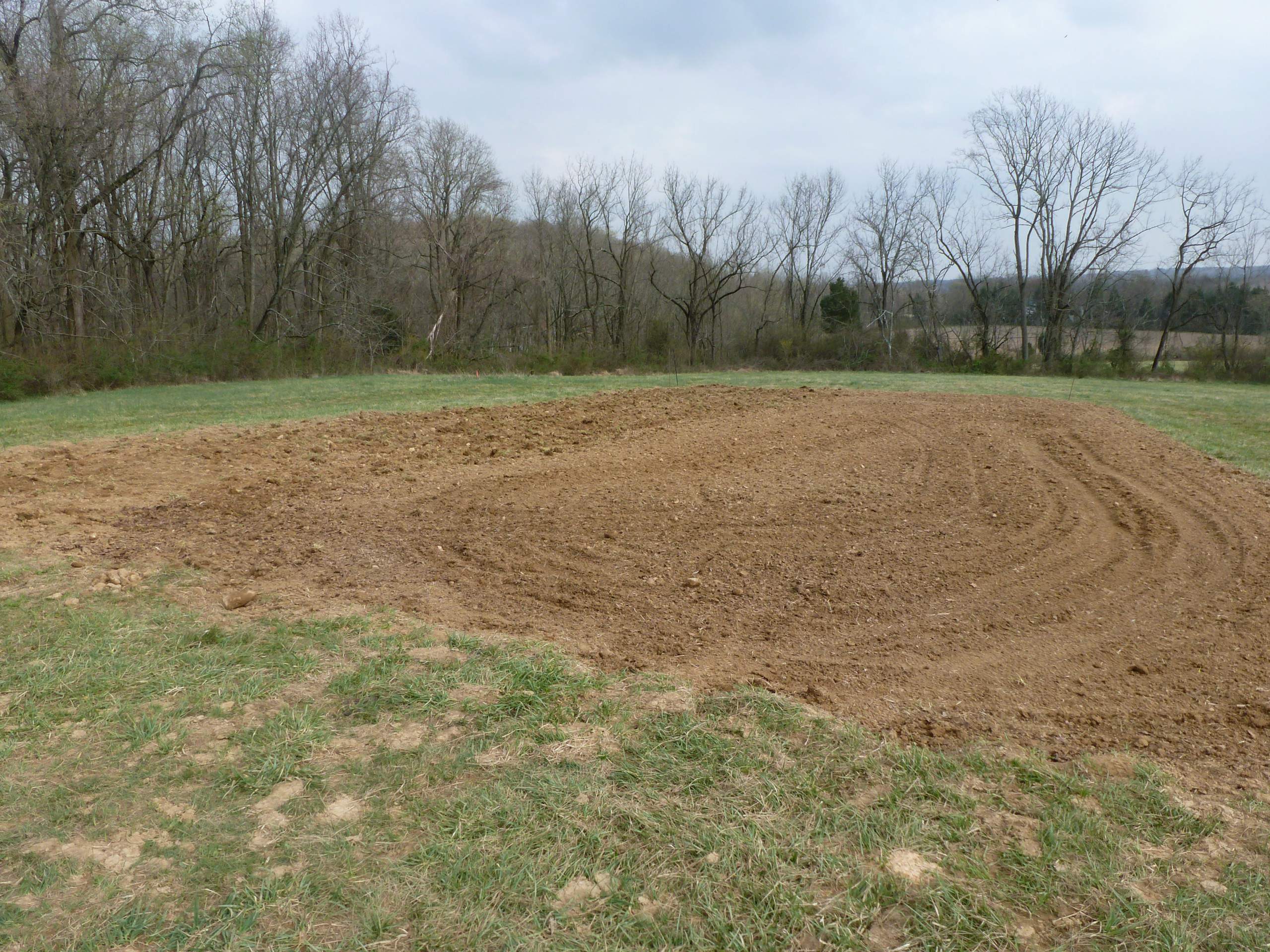

We kept digging, after digging a pilot hole which was a real drag, and it really didn't dig that well, nor did we expect it to, but it got the job done and we were pleased. 4x4's got put in about two feet down, and we leveled them with a nifty plastic level my wife got me made for posts. My own little Stonehenge at the moment without the deer fence on it. No pics of the post work yet probably a good thing since when we put the posts in at one end my friend and i looked at each other and started laughing. We were so far off... We moved one and all was well, but my friend and I agreed not to come back in our next life as land surveyors.

Land Pride should replace it under warrenty. If not be sure to tell us WHY they said they wouldn't!. PHDs are designed to hit rocks and no be damaged. With your low powered tractor there is no way that should have happend even if you put it in a pile of boulders. At the risk of starting that same old "where is it actually made" threads, I would bet things like this auger are imported from India or China and are not made of a high grade of steel. What you were doing is exactly what it was designed to do. I think they will replace it. Land Pride needs to spec it better from their supplier. Good luck with it!
   / CRACK! There goes the new PHD auger... #3
In my opinion, the metal is bad. The crystilin look shown in the photo indicates bad steel. With the turning motion if a drill, when it fails I'd expect to see a tearing longatudinal fracture of the metal

thanks, I agree with both of you, but the last time I went on the warpath in this forum about mfg quality, I clearly learned that other normal decent folk think very differently than I, and have different expectations about their equipment. Now here's a case where I'm clearly admitting I used the bit "heavily" but never abusing it, dropping it full force on the rock, but I may have and not even knew I was doing it. So yeah, kinda hazardous working environment. But it's the comment on the fracture graining that interests me; I didn't see any rotational shearing but I know very little here. It just struck me as "coarse" vs. what I thought would be finer in hardened steel.

I agree with Toad , If it was a tearing motion in steel , that would be one thing , but that just looks like weak steel . If they will not warranty , maybe try to weld it solid ??? Don't flame me for that suggestion , have only used a phd once and that was a rented one .
