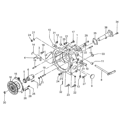

i have the same problem with tc30 new holland, how much does it cost to remove & replace? mine cracked from front to back i think this was caused by front loader bucket. does anybody know part #
   / cracked bell housing #19
A new case (SBA320111753) TC30 Clutch Housing.PNG is $1600. If you replace the case, you will probably do the clutch at the same time so about $2000 in parts. A New Holland Dealer will probably have about $2500 in labor. It would be cheaper to locate one in a salvage yard and have an independent mechanic do it.
