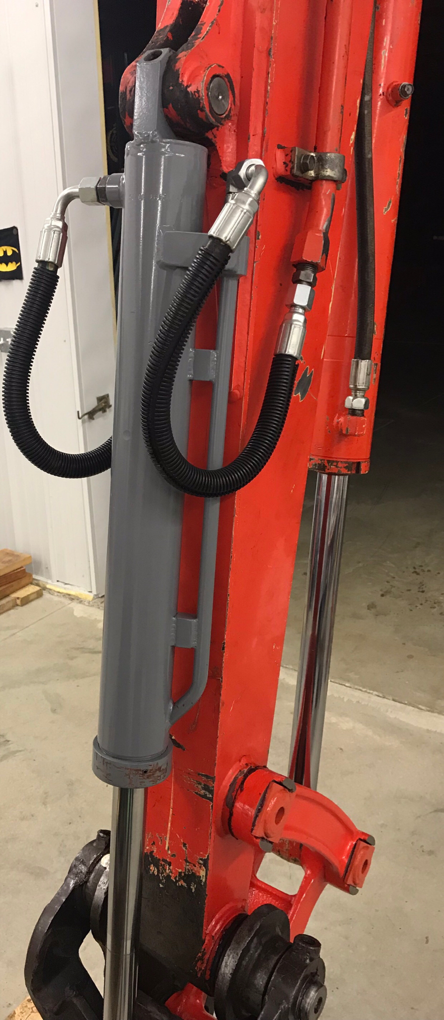

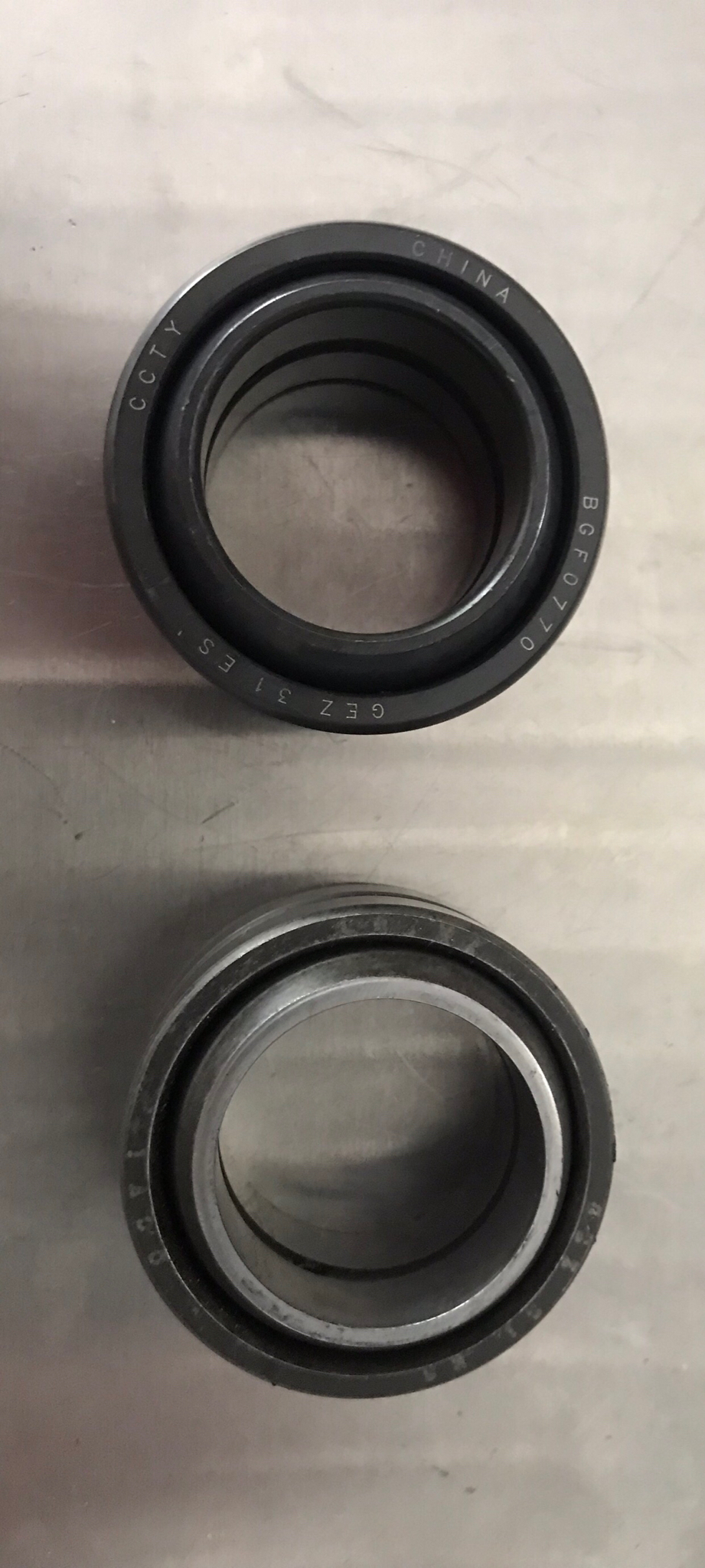

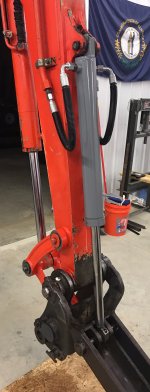

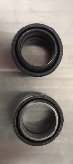

Update as I've been away from this project for awhile now. Ended up putting in new pins, bushings, seals, tipping links, etc on the dipper arm of the excavator. Tracked down new bearings to press in on each end of the thumb cylinder. Was actually using the excavator for a while with the thumb off of it.
Got the cylinder painted, seal kit installed and fitted it back over the weekend. Everything checked out great in the shop so I went out to move some small rocks in the pond spillway. About 3 minutes into it, I blew a main hose for the thumb, up on top of the main arm, covered in a big spring to protect it. It never fails. Shut of the thumb, lower the arm to inspect the hoses. The left upper main hose has been replaced, it's a Gates with a bright green stripe. The hose that blew on the right appears to be the original and was badly cracked and dry rotted. My fault for not catching it but it is all covered up inside that spring.
Got a new hose made up and installed. Need to top of the hyd fluid and get back in action.
