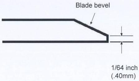

Gator blades are 30degrees with a .030mm (1/32) edge.

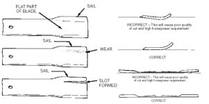

As long as the wheels are not touching the ground when you are parked you are OK. They should only touch ground when the mower rocks or dips while moving. Are the new blades perfectly flat along the cutting edge? I recently bought blades that had a small warp in them. I hammered it flat and they cut smooth again.

FYI, no lawn mower blade should be 'knife sharp'. They are meant to be a little dull with a 1/32"-1/64" edge. If they are sharpened to a fine edge, the edge will simply curl and roll back very quickly anyways and result in a edge that could, and usually is, duller than normal. And you should never sharpen the bottom of the blade, only the top and keeping the correct angle. The bottom is to remain flat. Speaking of which, Oregon Gator blades use a 30* angle and a .030" (1/32"/.8mm) edge (what they cal 30-30) as opposed to the 40-45* angle and .015"(1/64"/.4mm) edge of 'normal' blades. This is why the seem to last longer between sharpening and resist dings better.
