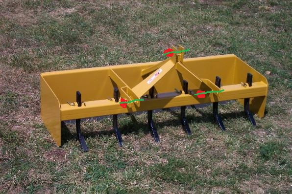

You could use a pats quick hitch. I would cut the m off and weld them to ASAE standard dimensions in case you wanted to go to a quick hitch. I had to do this on almost all of my no name equipment.
   / Craigslist purchase gone wrong, any ideas? #12
I was thinking what roamerr said. Stabilizer pin is pointed to the outside and the 3pt arm goes over it, if your arms swing out wide enough.
Me, too. If the 3-pt arms hit the tires when mounted with the new pins
on the outside, they can be mounted on the inside (pointed inward) instead.
I had to do that for a smaller tractor before (CK20).

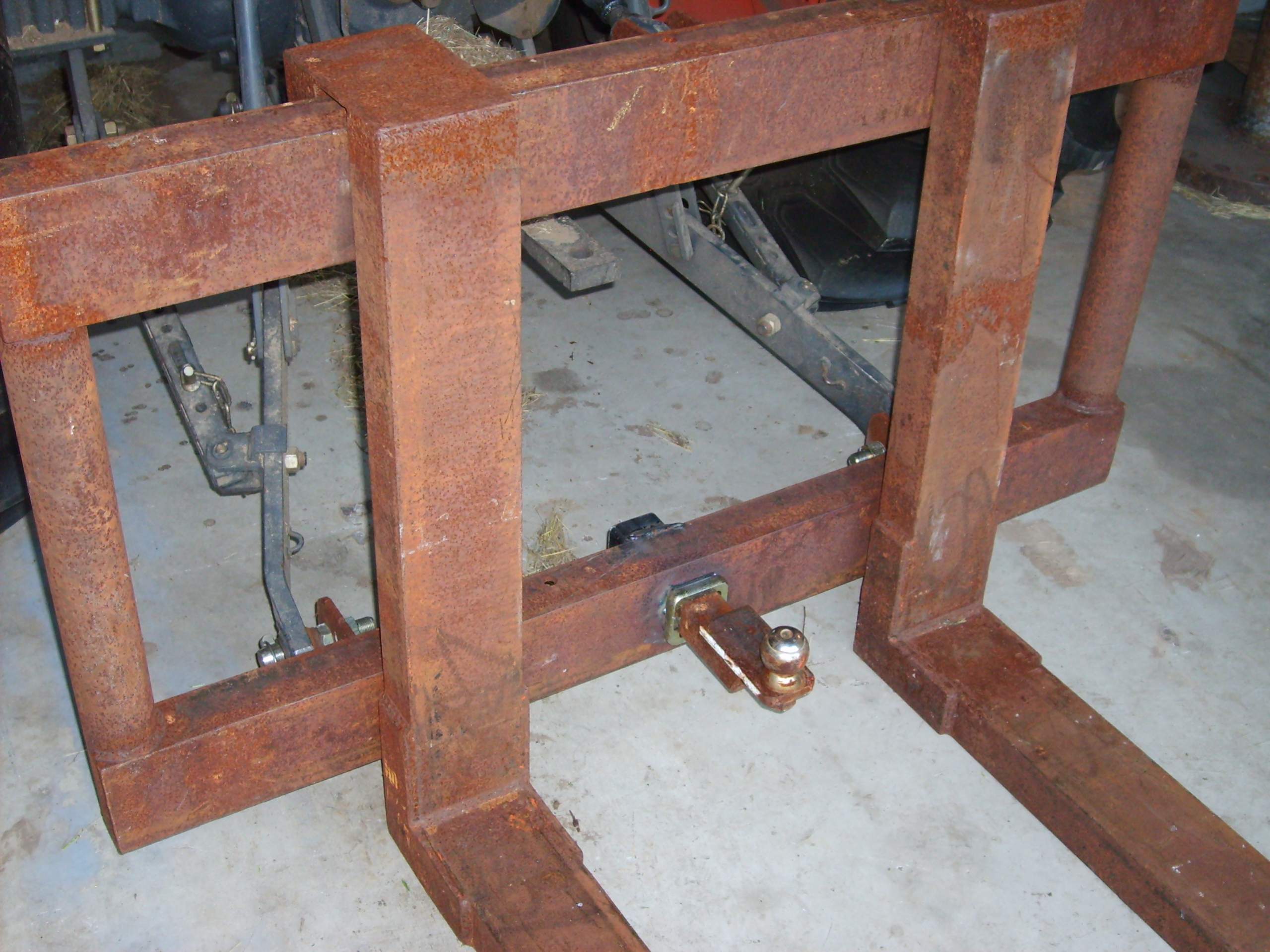

That's not the problem, the problem is the that the width of the 3 pt arms themselves will not fit into the hitch on the blade. As you can see in the pictures the little eye bolt that moves around within the 3 point arm is too wide to allow the pin to go through.

go to your tractor dealer and buy a pin thats threaded at one end and a clevis on the other end.Put the threaded end threw the hole and tighten.Then attach the blade and put the clevis in

I ran into that problem one time with a previous tractor and I can't remember what implement:confused2:. I took an angle grinder and ground down both sides of the TPH ball (it was on the top link in my case) so it fit between the tabs. No more problem.

The idea would be to run the threaded part of the new lift pin through ONE of the two clevis hook-up tabs that are too narrow. The nut will be between the two tabs.
By doing the same thing, in the same direction, to the other set of tabs then the tractor's lift arms should be able to be hooked up without having to adjust the width of the tractor's lift arms.
But you could install both of the lift pins to point outward if there is enough adjustment in the tractor's lift arms.
Myself, I would cut off one of the lift tabs and weld it back on to provide a wider gap. But that is me. It has also already been suggested but may not be an option depending on the cutting/welding equipment that you have.
The project is not a loss at all. Just some adjustments need to be made.

Ok. I found one that might work. This one shows the hitch up like you mentioned. You can reverse it for inside attachment.
As someone has suggested, you can grind the ball on your three point arm to make them narrower so that they fit between the mounting tabs on the box blade.
You can also buy some hitch pins like someone suggested. Something like these (Lower Link Pin, Category 1 Adjustable, 7/8 in. dia. - 0268420 | Tractor Supply Company)
You can install these in the inside tabs and have them both pointing toward the center of the blade, or install them both on the outside tab and have them both pointing toward the outside of the blade, or both on the right tab and have one pointing in and the other pointing out or the opposite of that, or in the left tab with one pointing in and the other out. This way, you would not be dealing with the issue of your tractor links being too wide.
