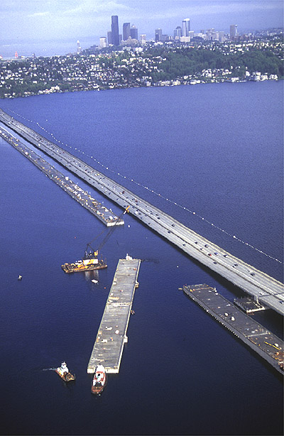

That was the LVM Bridge, just south of the 3rd Lake Bridge. I thought it was funny watching the LVM Bridge sink on TV:laughing:. Until about 10:00 that night when the telephone rang:shocked:. I was told to get out to the bridge and start setting temporary anchors to secure the 3rd Lake Bridge. When the LVM Bridge went down it cut 13-anchor wires on the 3rd Lake bridge. My company hired every available tractor tug in Puget Sound to push on the 3rd Lake bridge to try and save it. Then later we got the contract to build the replacement for the LVM Bridge.
