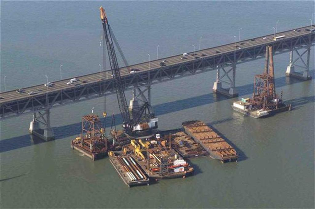

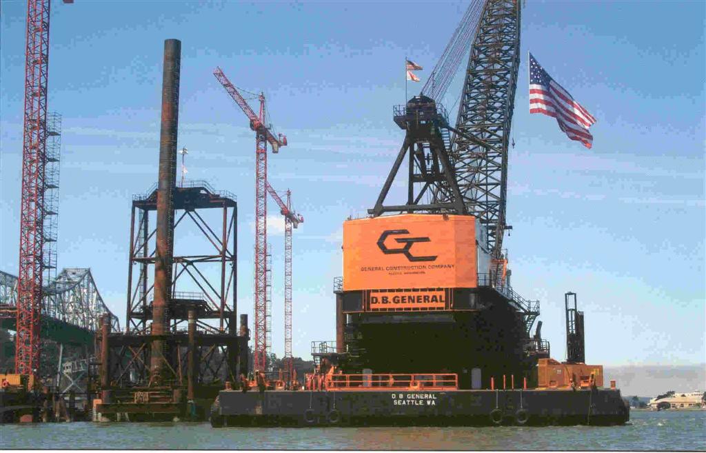

I've worked with those little truck cranes before. Company would not allow us to make a pick past the front set of out riggers. And never over the cab of the truck! I hate working with truck cranes. Everything depends on the out rigger pad. I've been in situations where we drove pile to place the out rigger pads on. Much safer that way.
I feel more comfortable working with these! This crane is rated at 50-tons at 285-feet radius.:cool2:
