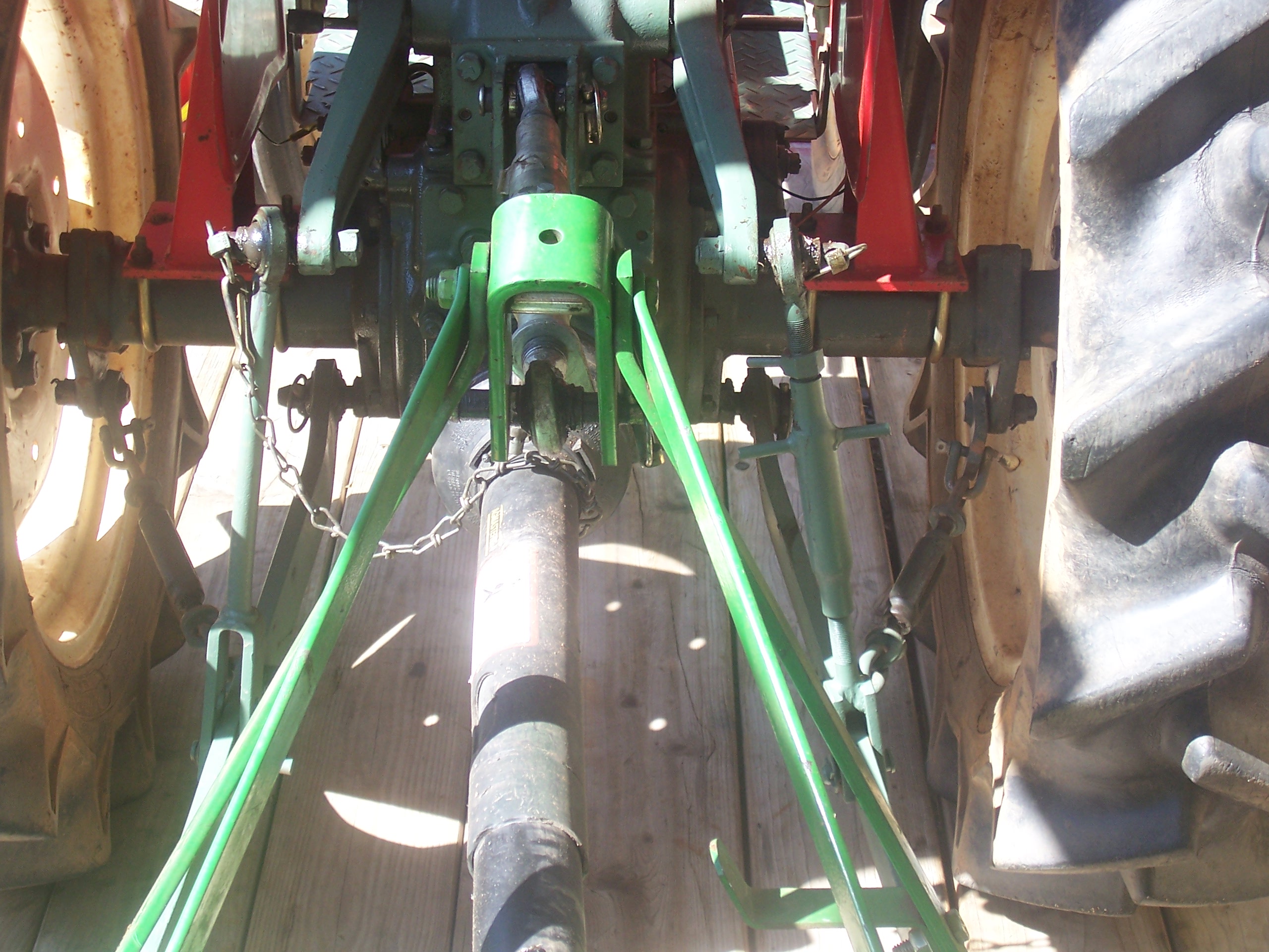

I was wondering....because I saw a hand crank on a JD 950 tractor I sold (flipped) that would really be a nice replacement to the screw type we have on the YM's. Unfortunately, the one on the 950 was too big for me to swap it out. Anyone know of one that will work? My screw type is a challenge to adjust when its really cold out (cold hands and gloves on) and with an attachment hanging off the three point

Mine works and moves ok....its greased, but when its cold and my hands are cold and when they have gloves on its a two handed task - that's because there is weight on the threads with the back blade. If I set it down its a breeze, but I need to see the angle that I am adjusting the BB to so I have to keep the blade in the up position. I just figured a crank would provide a lot more cranking leverage and make the job much easier. You can see mine in the pic beloe. My left side - non adjustable measures 18 inches hole to hole.

Look at Scotty's pic. and it seems he's missing the Adj. left Link. The Factory Yanmar one I have is your angle and the Right is for a small adj. If the L. is set to high "more angle" that would be the only way it is hard to AdJ. Having to Raise the R. side. If you Set it to the lowest Hole that would make the R. easy to Adj. Your Dropping the weight if the lift is raised. I believe that maybe what Soundguy was more or less saying?

Carey - You lost me a bit on your post. What am I missing in my picture?

I cant adjust my link very well with weight on it fact I don't either just to keep from stripping it out. I set it down and adj and so on. With that said I think it is very easy to do with a crank compared to a sleeve with cold hands so I can see where it would be wanted. I am not seeing another set of holes in your left link at the bottom Scotty I think that is what carey is talking about?
/ Cranking Adjustable Side Link #18
I think what Carey is saying is you have a bit of adjustment on the left link, By removing the pin and setting it at either higher or lower hole could quickly get you closer to the adjustment needed rather than having crank the right one up or down, of course depending on how much tilt you need,;)
/ Cranking Adjustable Side Link #19
It appears he's Missing the Left hand Side 3 Hole Adj.. Like in my Pic.. Not all of it is showing in Scotty's pic.. Just were it Pins. to the Lower arm and no doubt it's seems Different. 2 Holes? maybe? Thanks guys sorry about that!!
/ Cranking Adjustable Side Link #20
I have 1 hole and a slot below that on my left link at the bottom so either its fixed or it will float if in the other position. Not sure why they wanted to float the links but that is all I can figure.
