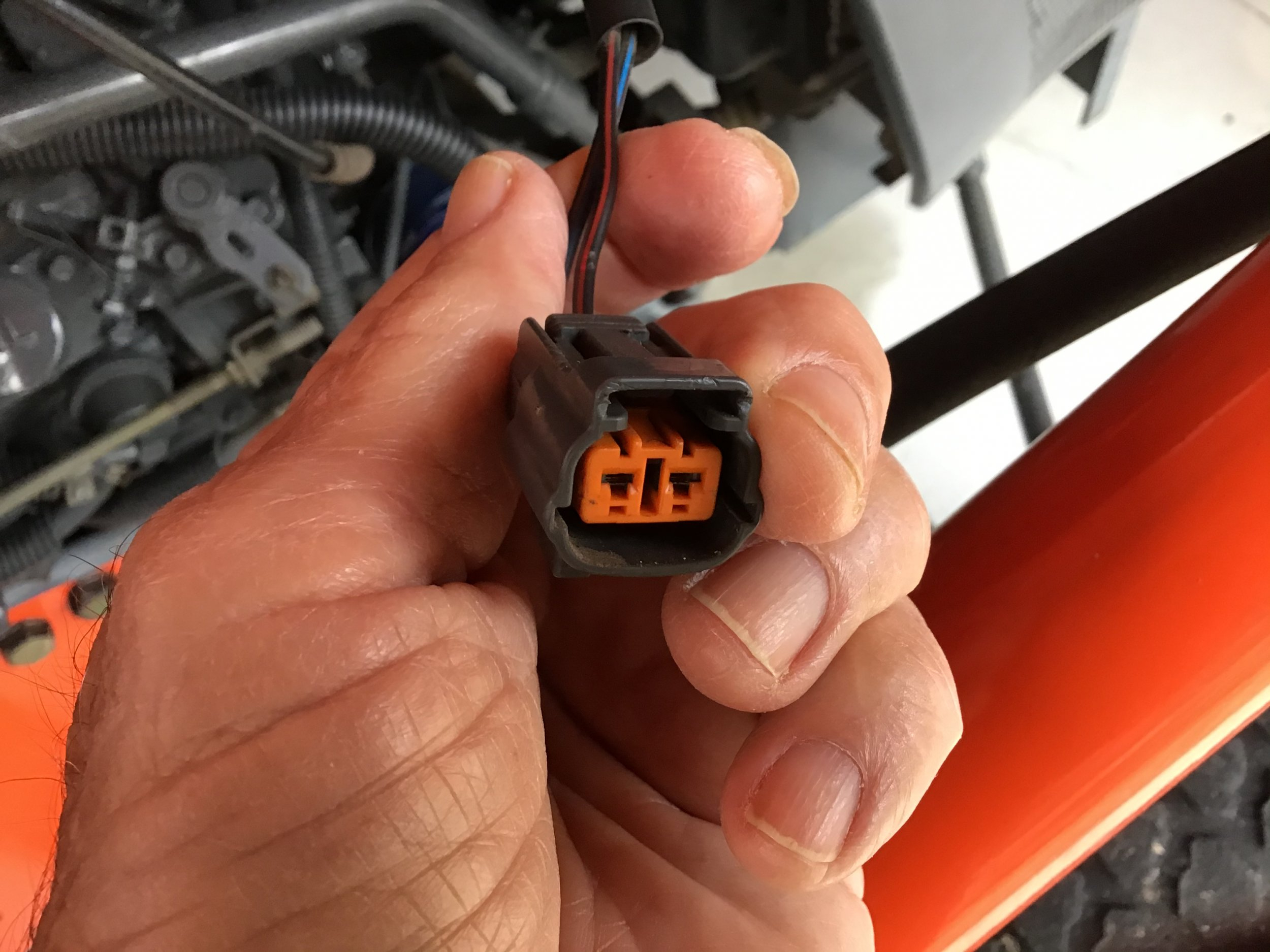

Beezfun, I have checked the two wire female connecter for the fuel solenoid and both connections are getting power when the ignition is switched on. The solenoid works and tractor runs when jumped straight from the battery but does not run when connector is used. So I am stumped. Any suggestions?
   / Cranks but does not start #9
What condition is your battery in? I had an issue where the tractor would turn over but the voltage has just low enough while cranking that it wouldn't activate the fuel solenoid every time. Took me a while to find the problem, new battery solved my problem.
If it's not the battery it could be high resistance somewhere in the fuel solenoid circuit, first place I would check is the voltage drop across the fuse block. It's also a possibility that the fuel solenoid is getting weak.
