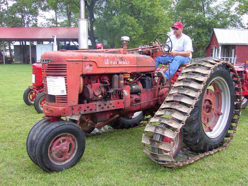

Aussie, I have a pic in Tracks. it is number 29 to give you an idea. Been a while since I have been around. if you go to search and use rdbrumfield, tracks I believe you can find it.

Yes BHD
That is exactly what I had in mind, fitted just to the rear wheels, meaning the metal plates connected with chain sections. The idea of a half track makes the concept even better. I'll give some serious thought about how to make this,

If you go for half-track solution so consider hydraulic lift, it increases ability to negotiate obstacles significantly when you can use the the bogie to lift the front wheel over obstacles. My father used to run a MF 165 with half-tracks in logging back in the 70's and one of the largest the loads he pulled was 11 cubic meters with spruce same tractor with regular forest chains pulled about half as much
