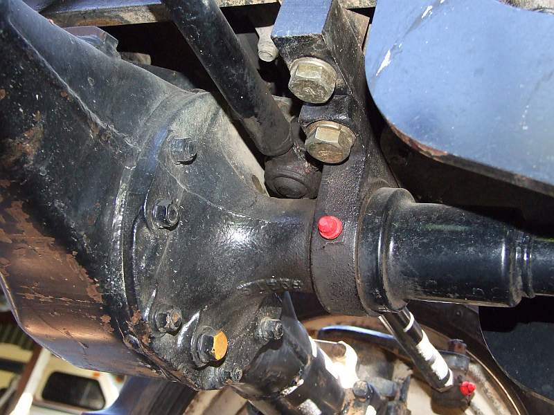

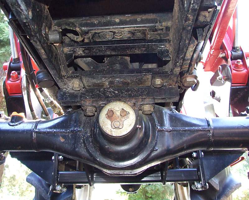

As of late I've been thinking of the possibility of increasing the wheelbase on my tractor. The WB on the F series to a little too short for my liking. The frame extends fwd enough to permit a movement of about 1 ft without the need for any extension. From a quick look moving the front axle fwd doesn't look all that difficult and I'm thinking the biggest issue would be to extend the drive shaft and shaft-tube. Of course steering linkage would need to be addressed. At the slow speed these things run, I don't see any issues with the need to re-balance the shaft. For sure it would have to be jigged during the lengthening process to make sure the shaft stays straight.
Reason for the thought is steering is a little too quick and extending the WB would help reduce weight transfer with loads on the FEL. A ft extension would reduce weight transfer 33%.
Ever hear of anyone doing this and if so, what kinds of problems did they run into?

Someone on here did it. I believe it was a YM1110D and he moved front axle assembly about a foot forward. (Think it was the same gent who got my rear hubs off my spare 1300D).
He moved the pivot + axle mounts and lengthend the drive shaft and pitman arm. It may have been for the same reason.
