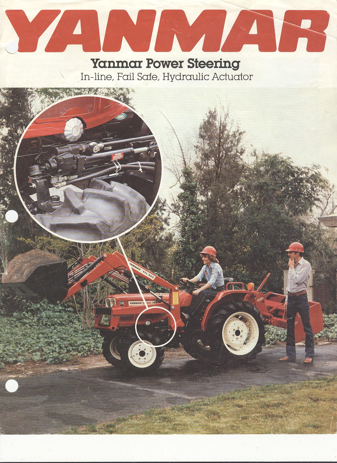

Just an FYI, the YM2310 and the other machines above a YM1720 did come with the option of having OE PS. :) In fact Yanmar in their literature boasted about offering PS.
See your YM2310 info here:
Member California here can tell you the 'leaking' troubles with the OE design too. LOL
IF I had to PS my machine, I would go the electric assist PS option. No hoses, no pump, no belts, just mount and plug the connector in. :)

Not sure if I had posted this in the thread here - - -
This is the Yanmar OE PS system for YM machines
